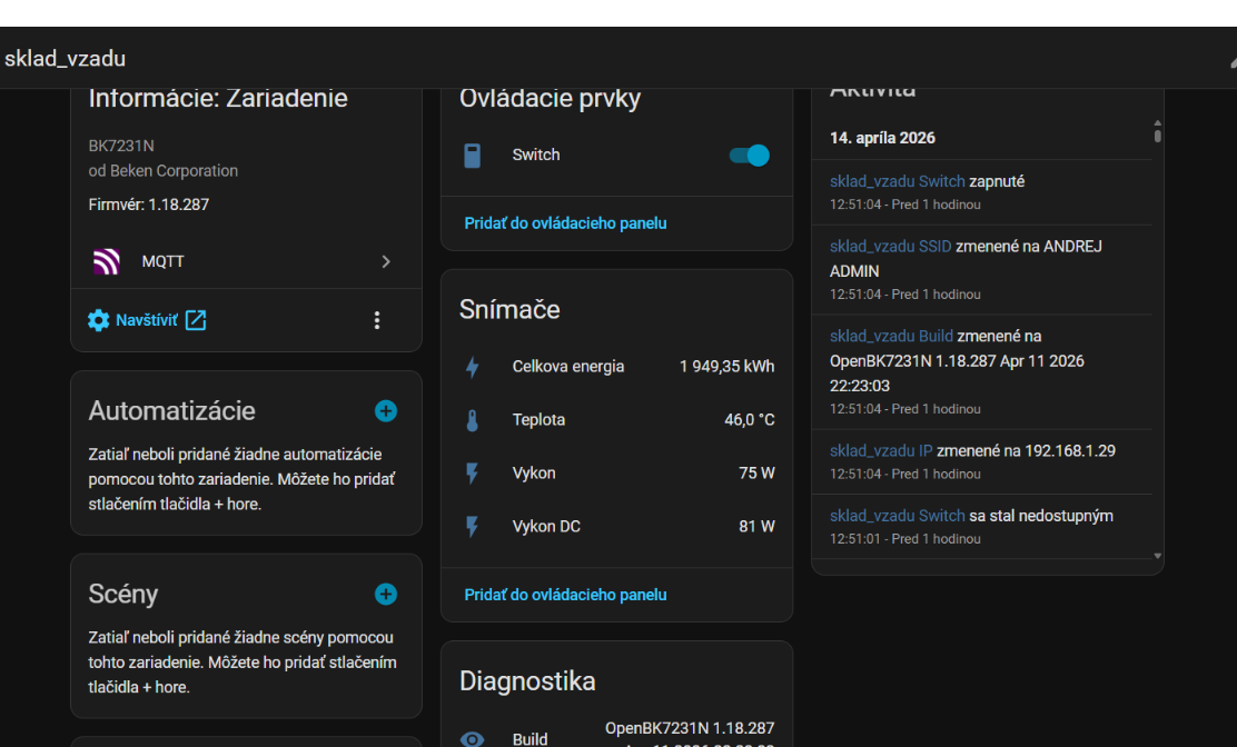

    OpenBeken + WVC Microinverter (Tuya MCU) – Working dpID Mapping
    I successfully integrated a WVC microinverter (Tuya MCU, BK7231N) with OpenBeken and mapped the correct dpIDs without needing RAW parsing.
    Silver-gray electrical unit with multiple black side connectors on a white background
    Device
    * WVC microinverter (Tuya-based)
    * BK7231N WiFi module
    * OpenBeken 1.18.x
    Working dpIDs
    * **103 → AC Power (actual output)** ✅
    * **102 → DC Power (panel input)** ✅
    * **18 → Temperature** ✅
    * **101 → ON/OFF** ✅
    Important Notes
    * **dpID 103 is the correct AC power** (matches Tuya app precisely)
    * **dpID 10 looks similar but is inaccurate → do NOT use**
    * **dpID 7 contains RAW data (power, voltage, etc.), but parsing is not needed**
    * Some dpIDs are scaled or internal values and may be misleading
    OpenBeken Configuration
    startDriver TuyaMCU
    tuyaMcu_setBaudRate 115200
    tuyaMcu_defWiFiState 4
    # ON/OFF
    linkTuyaMCUOutputToChannel 101 1 1
    # AC Power
    linkTuyaMCUOutputToChannel 103 2 2
    # Temperature
    linkTuyaMCUOutputToChannel 18 2 3
    # DC Power
    linkTuyaMCUOutputToChannel 102 2 4
    setChannelType 2 Power
    setChannelType 3 Temperature
    setChannelType 4 Power
    setChannelLabel 1 state
    setChannelLabel 2 power_ac
    setChannelLabel 3 temperature
    setChannelLabel 4 power_dc
    MQTT Recommendation
    Use a unique device name:
    MqttClient sklad_vzadu
    For multiple units:
    sklad_vzadu_1
    sklad_vzadu_2
    Home Assistant Note
    After changing device name or configuration, remove old retained MQTT discovery topics to avoid duplicate entities.
    Result
    * Accurate AC and DC power readings
    * Temperature monitoring
    * ON/OFF control
    * Full MQTT integration with Home Assistant
    This setup works reliably and avoids unnecessary reverse engineering of RAW Tuya data.

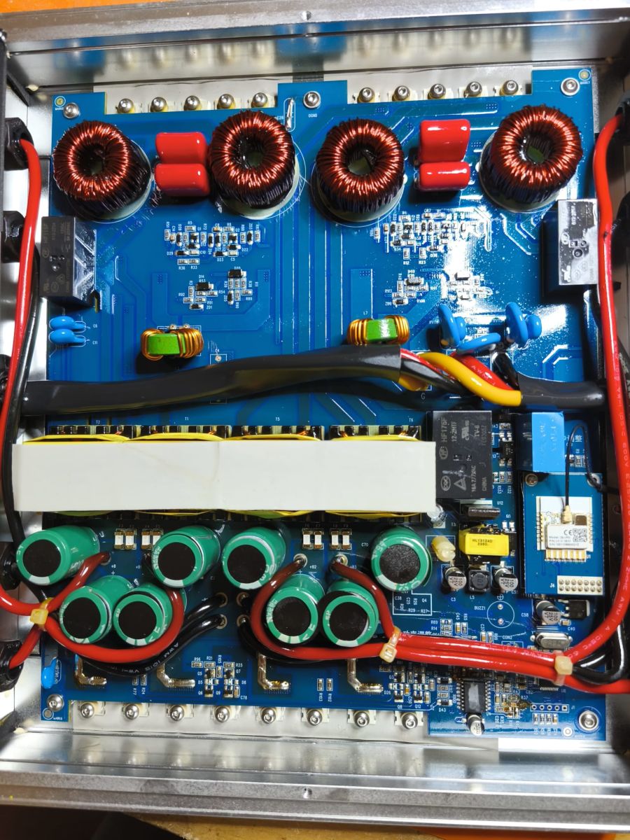

    this turns this china stuff into interesting products! i sadly only have an old WCV1200 pre wifi unit (10 years old) around. since "cheap" inverters are all around it would be interesting if any others also uses BK chips for wifi. this should be very likly?!?
    @ondrejm111
    do you have high res internal photos?

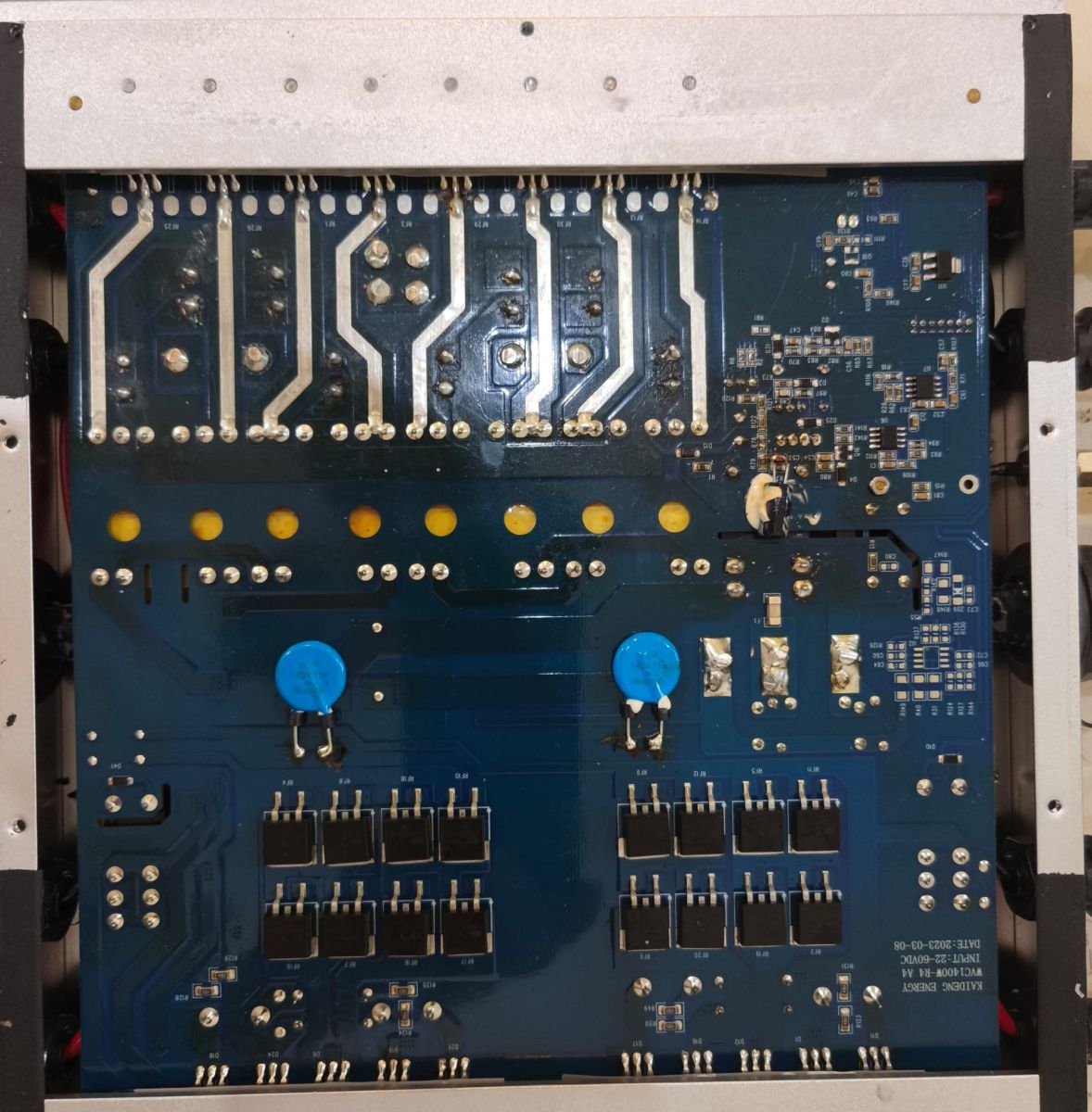

    ondrejm111
    Posts: 7
    >>21905303
    OpenBeken BK7231N WVC Microinverter Tuya MCU dpID 101/102/103/18 Mapping
  • #5 21908721
    vincenzoernst1
    Posts: 100
    Rate: 7
    >>21908550
    as i learned some time ago its better to add pics as attachmet than as images, so the resolution is much better.
