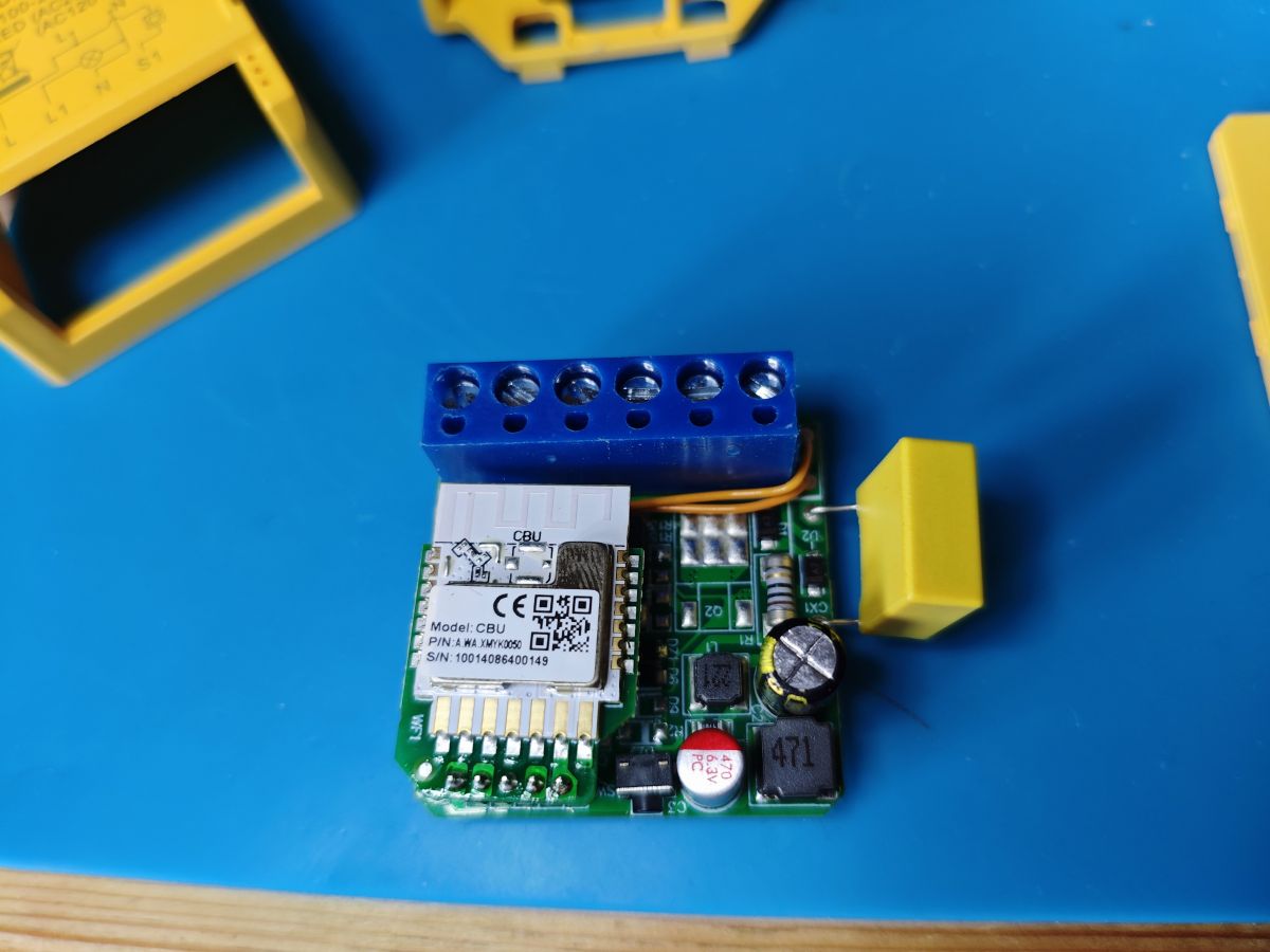

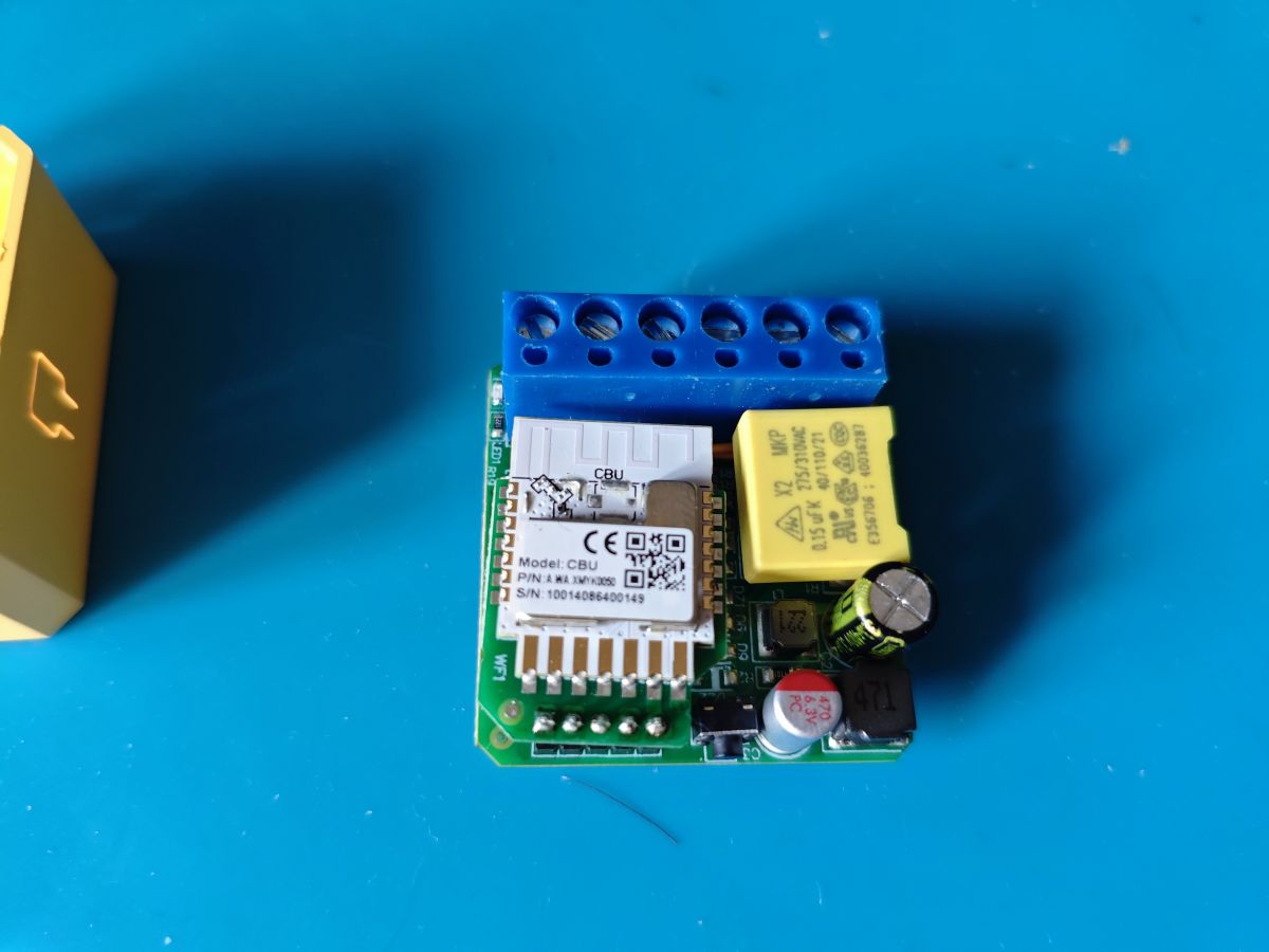

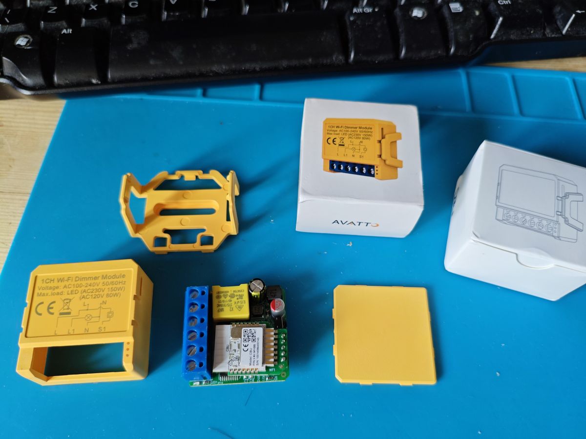

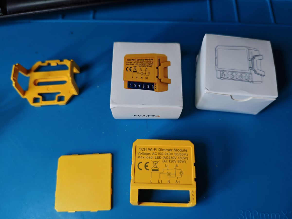

  • Hello. It's me again with another device. This is the Avatto DMS16-W1 1-channel dimmer smart switch with CBU talking to a Puya PY32F002A (TSSOP-20) MCU.
    Box on a blue table background with the text Smart Dimmer Module. Packaging of Avatto DMS16-W1 single-channel smart dimmer switch. 1-channel Wi-Fi dimmer module Avatto DMS16-W1 Components of the Avatto DMS16-W1 smart dimmer switch on a blue mat. 1-channel smart switch Avatto DMS16-W1 on a blue background PCB of Avatto DMS16-W1 smart dimmer switch with components. Photo of Avatto DMS16-W1 smart dimmer switch with electronic components. Close-up view of a smart dimmer switch Avatto DMS16-W1 showing the CBU module and electronic components. 1-channel smart dimmer switch Avatto DMS16-W1 with CBU module and electronic components. Avatto DMS16-W1 module with CBU and Puya MCU on a blue background Avatto DMS16-W1 smart dimmer switch board on a blue background Avatto DMS16-W1 smart dimmer switch on a blue background Avatto DMS16-W1 smart dimmer switch with a CBU module on a blue background. Close-up of the Avatto DMS16-W1 smart dimmer switch circuit board.
    The Puya MCU is well documented and has had some interesting followings on Elektroda https://www.elektroda.com/rtvforum/topic3946116.html

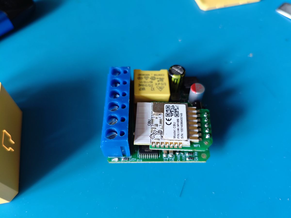

    CBU log out from power-on

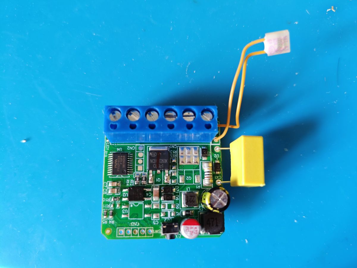

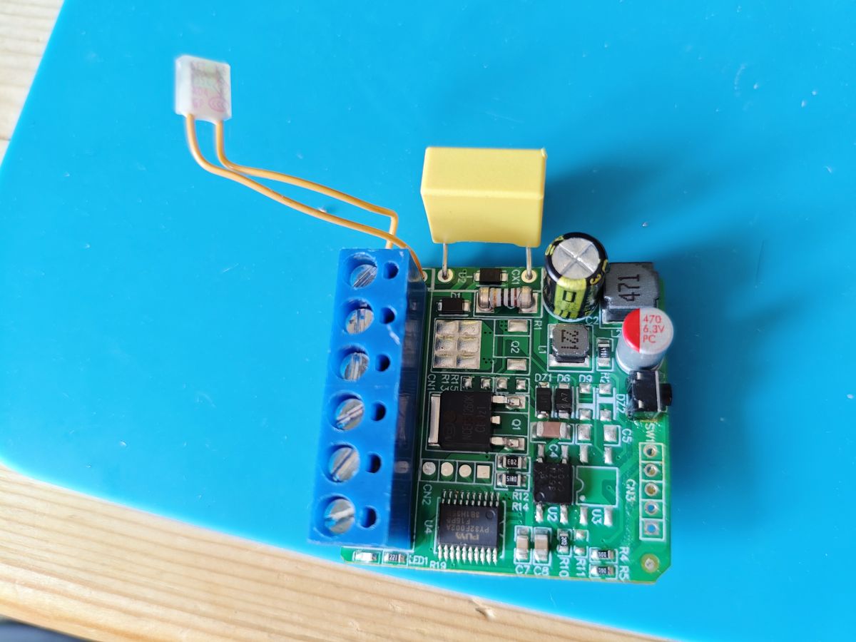

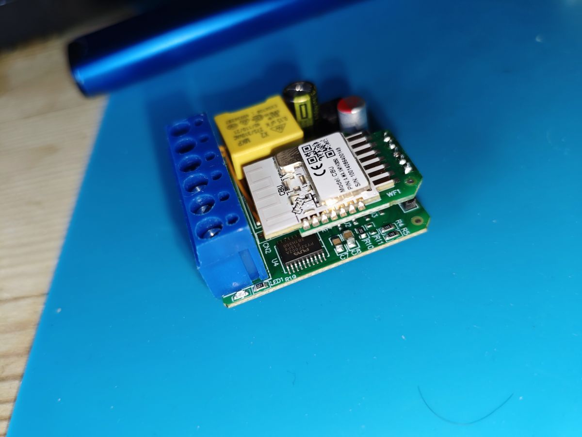

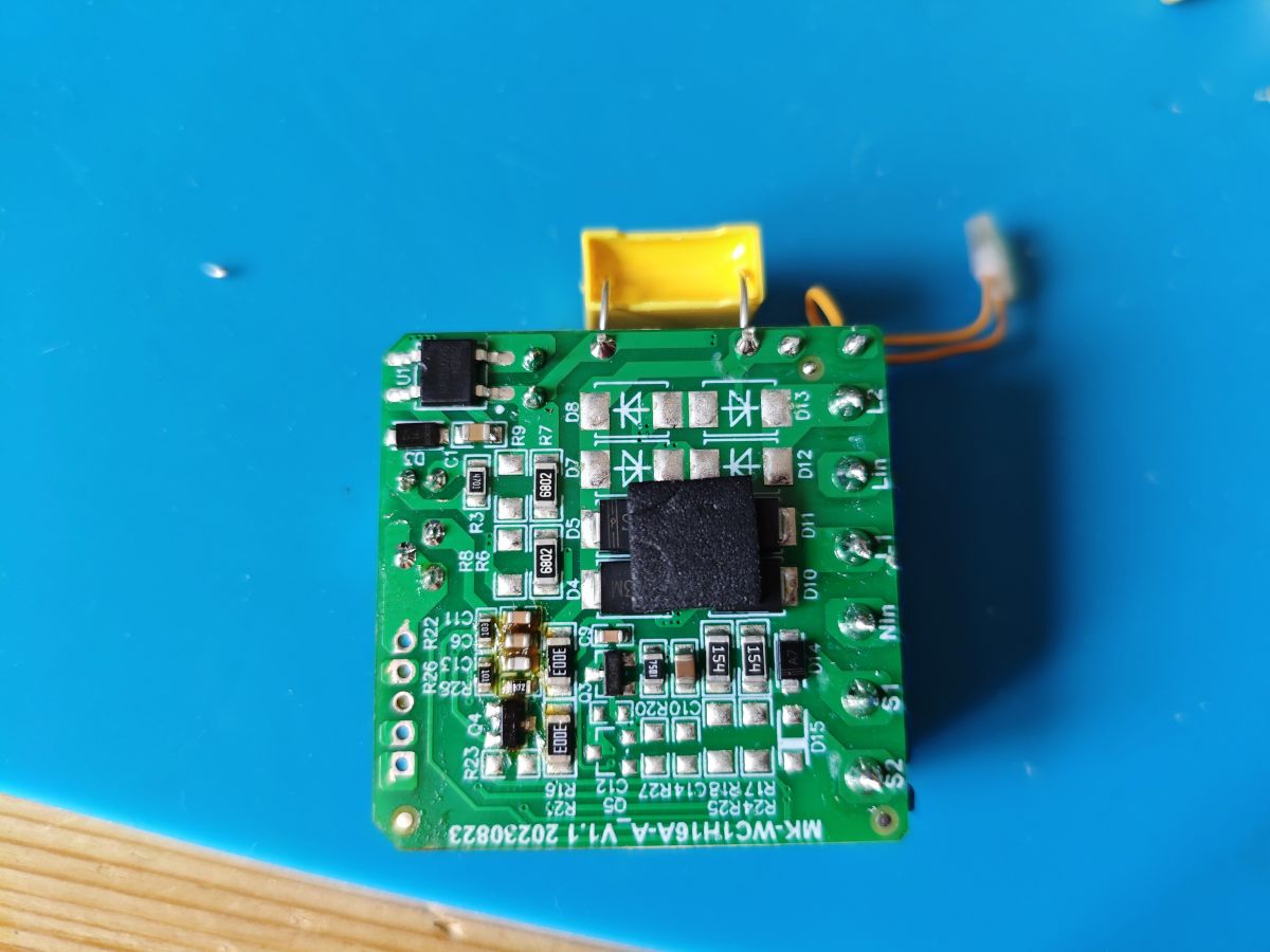

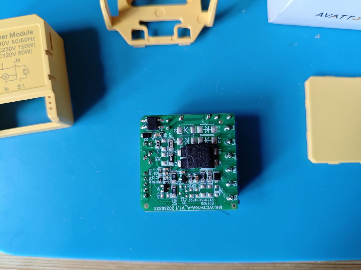

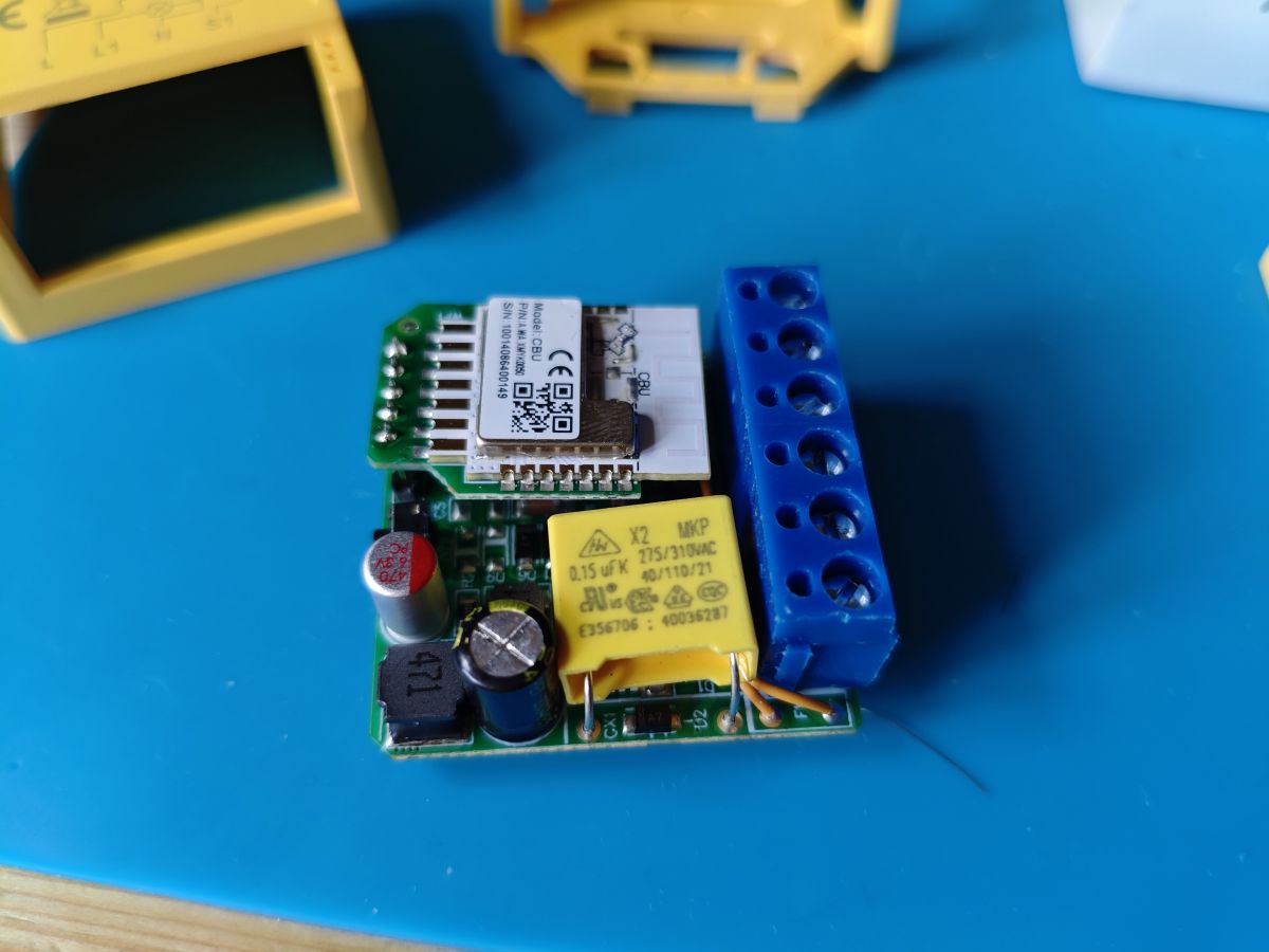

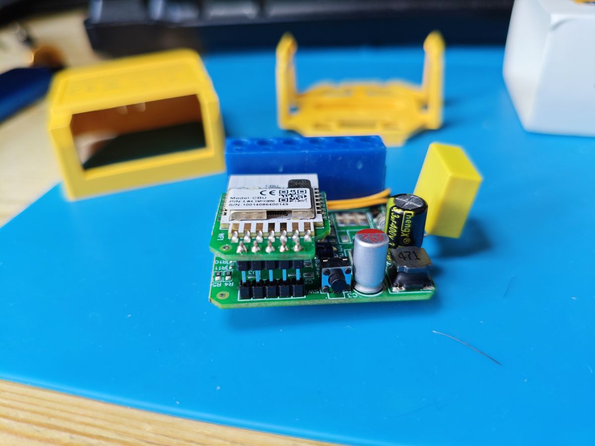

    After de-soldering the CBU riser the factory firmware was dumped using Easy Flasher, attached. The extracted config was "baud":"115200".

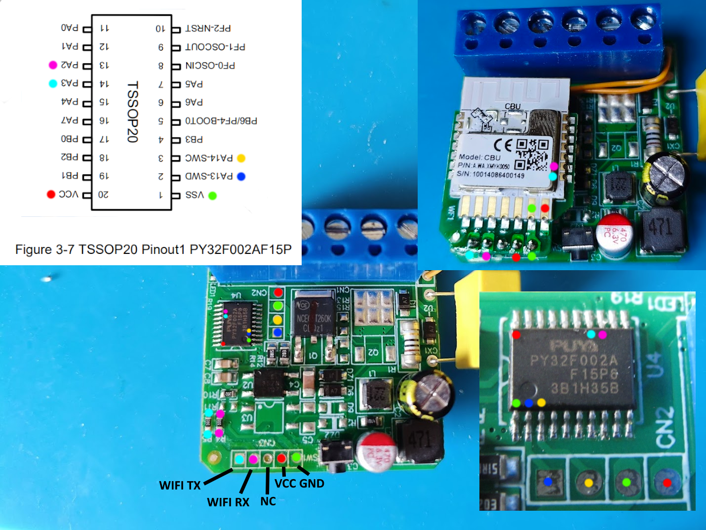

    With a multimeter I determine the following traces
    The photo shows the Avatto DMS16-W1 smart dimmer switch with a Puya PY32F002A microcontroller in a TSSOP-20 package.

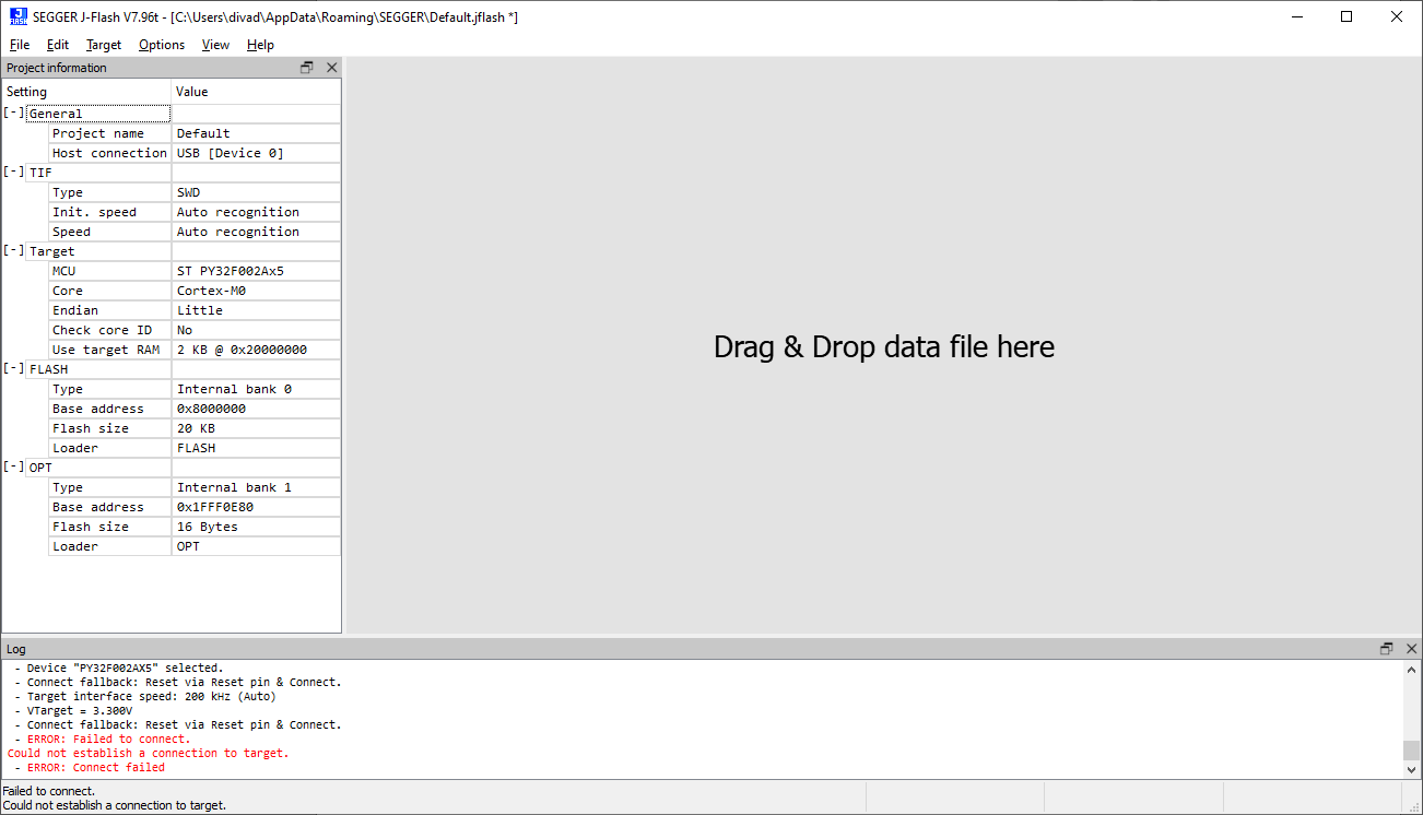

    so I have everything I need to capture communications between the Puya and the CBU and potentially to use J-Link to read the flash of the Puya. Sadly I was not able to get a connection from J-Link to the MCU despite my best efforts. Even with NRST-reset pulled low.
    SEGGER J-Flash programming interface showing connection error

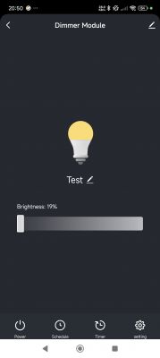

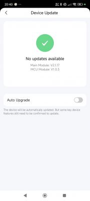

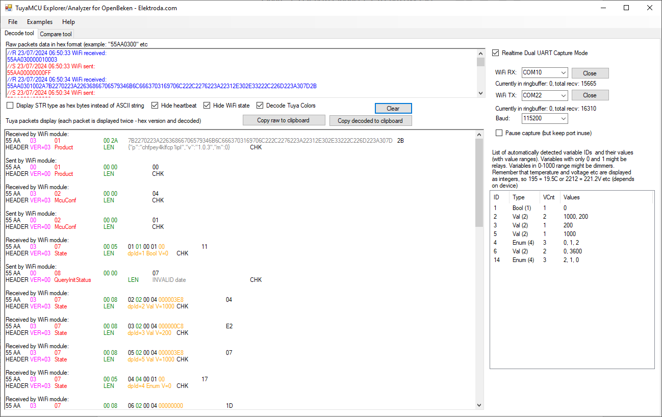

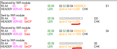

    Moving onto the communication between the CBU and the Puya, TuycaMCU Analyser was a winner for capturing all I could toggle and set within the official Tuya app. Those features being:

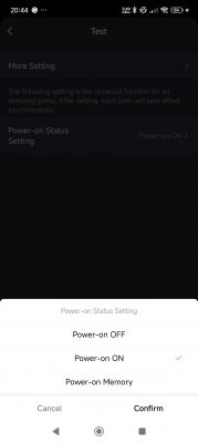

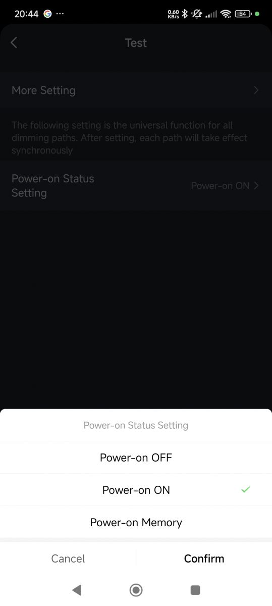

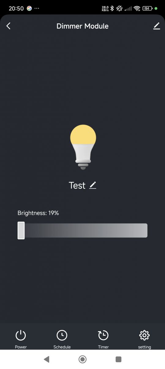

    App interface for controlling a dimmer module with brightness set to 19%. Power-on status setting screen in mobile app Mobile app interface for setting the dimmer brightness range. Device update screen showing no updates available. App interface for setting the dimmer brightness range with switch type selection.

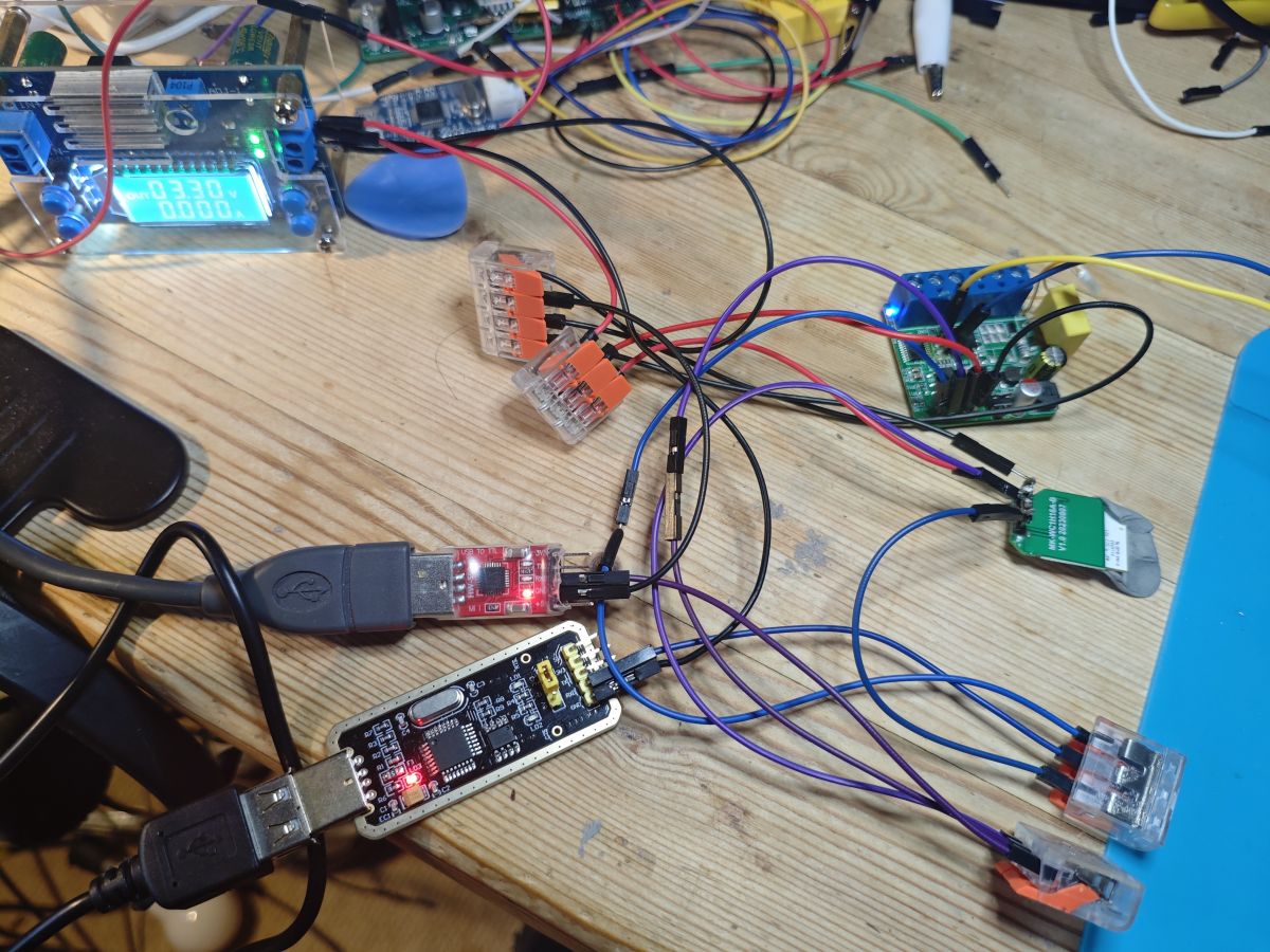

    And with the CBU rise de-soldered we can easily switch between OpenBeken and the factory firmware to recheck default behaviour by removing the Puya from the equation in this setup:
    Electronic projects on a desk with various modules and cables connected to devices.
    And with two USB-TTL adaptors in the mix we can capture communications in real-time when setting up OBK autoexec.
    Screenshot of TuyaMCU Explorer software analyzing communication between modules.
    The full extent of the dpIDs being
    I did not see dpIDs 13 and 47 in all my fiddling in the Tuya app trying every function, boot communication or tuyaMcu_sendQueryState.

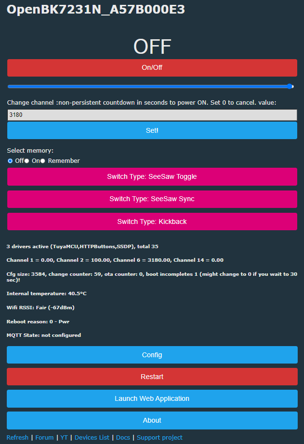

    Fast-forward to the current state of the autoexec
    which gives us
    OpenBK7231N interface with various switch and control options.
    The countdown to power-on timer field numerical value will change every ~30s as the CBU receives an update from the MCU on time remaining.
    This is as far as I have gone for now. Most functions appear to be working in OpenBeken, though I've not yet tested with mains power and an incandescent bulb. Certainly the communications I'm watching in the MCU analyser mirror what was seen in factory firmware.

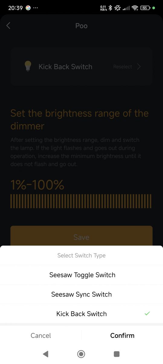

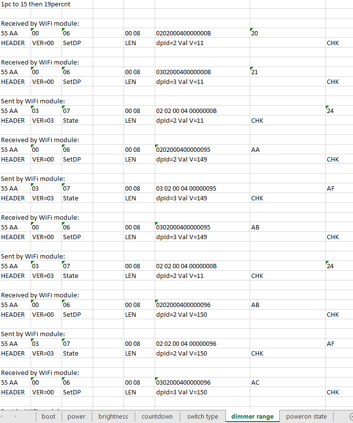

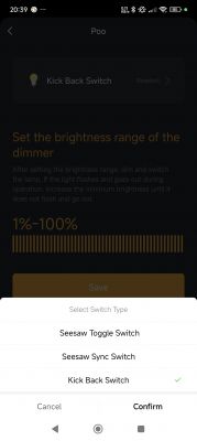

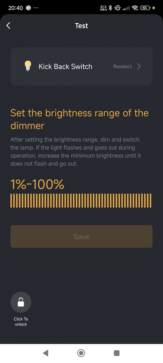

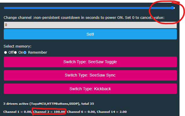

    There is one thing I don't yet know how to replicate. The brightness range, dpID3, allows you to customise the range from both ends. This is this screen in the Tuya app
    App screen for setting the dimmer brightness range.
    The yellow indicator can be toggled from the left to right to reduce the minimum, as well as from right to left to reduce maximum. This can be seen in factory with these comms. It also involves dpID 2, I'm not sure how this can be replicated in OBK.
    Screenshot showing communication between Wi-Fi module and device, displaying data related to dimmer settings.
    One thing I did notice was that although I've set the dimmer range to tuyaMcu_setDimmerRange 200 1000, same as factory, OpenBeken only displays a fixed 0-100 value range in the GUI for that channel when using the slider. It does however communicate the right values to the MCU.
    OpenBeken software configuration interface with sliders and control buttons. Log of communication between the WiFi module and device, with yellow indicators highlighting values 200 and 1000.

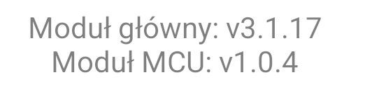

    I recently received an identical AVATTO dimmer with the designation DMS 16-Y1 instead of W1.
    An interesting feature of this version is a timer that counts down the time until the light is switched off.
    I tested it on a traditional incandescent bulb and it works great, I need to test it to see how it works with dimmable power supplies and LED bulbs.

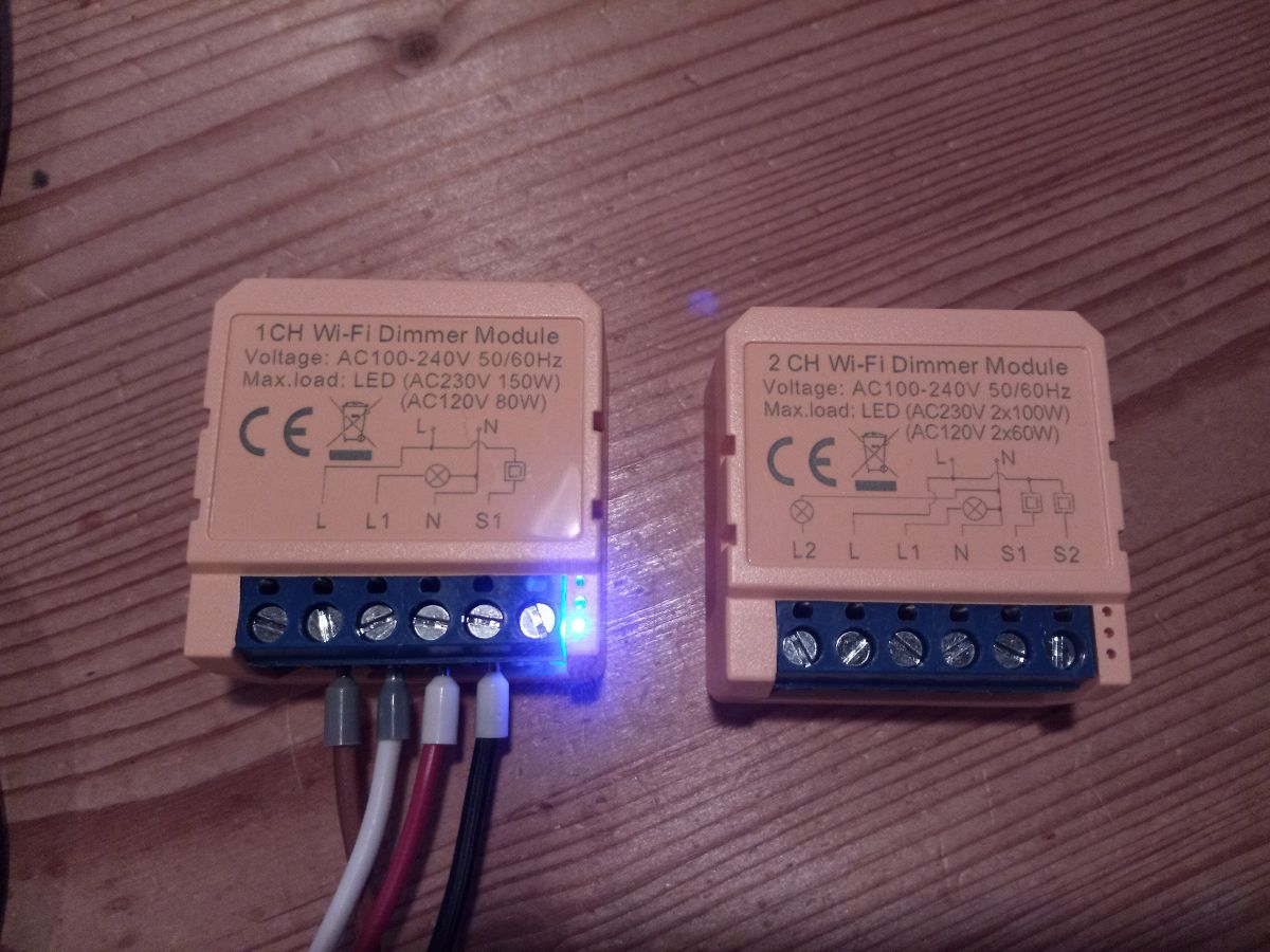

    I have the same dimmer switch, only it's the 2CH model. So I see mostly things are working fine with the 1CH unit, I will try out flashing my unit and report my findings. Seems like just the right dpIDs need finding.
    1CH version:
    Orange 1CH Zigbee dimmer module with technical specifications.
    Mine is this:
    Orange 2-channel Wi-Fi dimmer module with electrical connections.

    //Switch Type SeeSaw Toggle dpId=10 Enum V=0
    alias switchtype4 uartsendhex 55AA000600050404000100
    setButtonEnabled 4 1
    setButtonLabel 4 "Switch Type CH2: SeeSaw Toggle"
    setButtonCommand 4 "switchtype4"
    setButtonColor 4 "#DC0077"
    //Switch Type SeeSaw Sync dpId=10 Enum V=1
    alias switchtype5 uartsendhex 55AA000600050404000101
    setButtonEnabled 5 1
    setButtonLabel 5 "Switch Type CH2: SeeSaw Sync"
    setButtonCommand 6 "switchtype5"
    setButtonColor 5 "#DC0077"
    //Switch Type dpId=10 Enum V=2
    alias switchtype6 uartsendhex 55AA000600050404000102
    setButtonEnabled 6 1
    setButtonLabel 6 "Switch Type CH2: Kickback"
    setButtonCommand 6 "switchtype6"
    setButtonColor 6 "#DC0077"
    //Switch Type dpId=12 Enum V=<seconds>
    setChannelType 12 Textfield
    setChannelLabel 12 ":non-persistent countdown in seconds to power ON. Set 0 to cancel."
    // linkTuyaMCUOutputToChannel dpId verType tgChannel
    linkTuyaMCUOutputToChannel 12 val 12
    //-------Additional dpIDs-------
    // Power-On State dpID 14  - Channel 14
    setChannelType 14 OffOnRemember
    setChannelLabel 14 "Power-On State"
    linkTuyaMCUOutputToChannel 14 enum 14
    Could we get brightness_min and brightness_max to work? dpIDs 3 and 5 (9 and 11 for the 2CH version respectively)

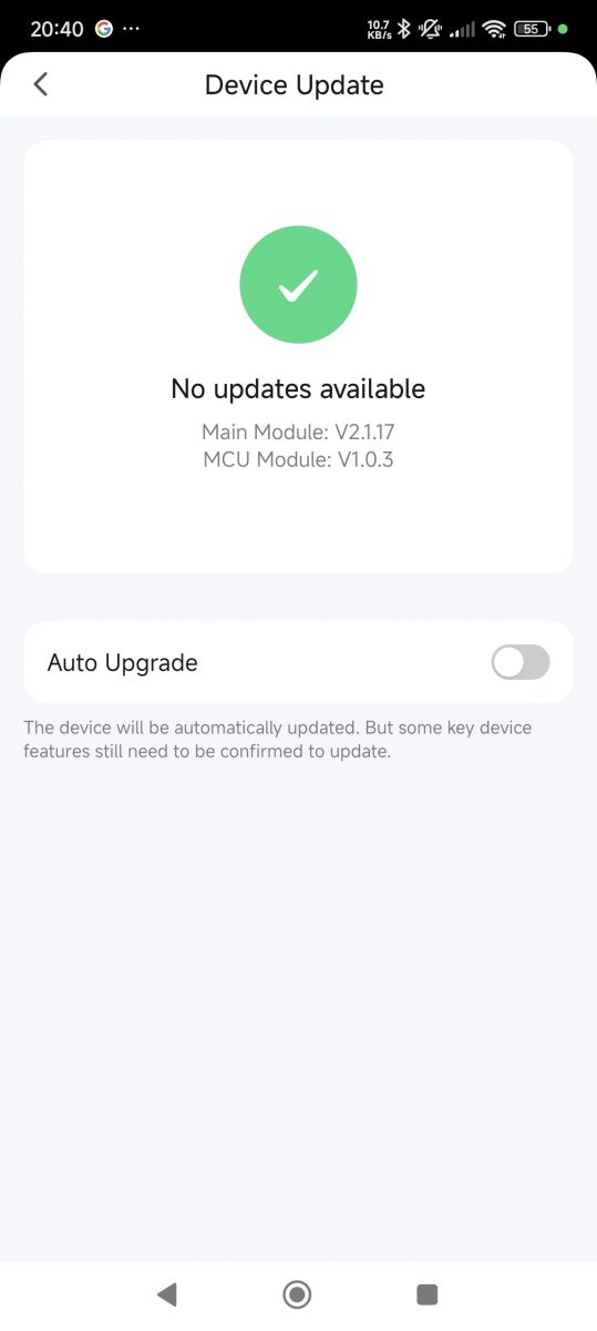

    I found another CBU and restore original tuya firmware for testing.
    My 2 channel wifi avatto dimmer software version
    Text on white background: Moduł główny: v3.1.17 Moduł MCU: v1.0.4.

    // Brightness dpID 2  - Channel 2
    setChannelType 2 Dimmer
    //Set dimmer range

    // Brightness dpID 8  - Channel 8
    setChannelType 8 Dimmer
    //Set dimmer range
    linkTuyaMCUOutputToChannel 8 val 8

    I used TuyaMCU to check payload that change type of a externall switch, it worked.
    For my software version payload looks:
    kickback1      55AA00060005040400010215
    Received by WiFi module:
    55 AA   03   07      00 05   04 04 00 01 02       19
    HEADER   VER=03   State      LEN   dpId=4 Enum V=2   CHK
    Sent by WiFi module:
    55 AA   00   06      00 05   0404000102   15
    HEADER   VER=00   SetDP      LEN   dpId=4 Enum V=2      CHK
    toggle1         55AA00060005040400010013
    55 AA   03   07      00 05   04 04 00 01 00       17
    HEADER   VER=03   State      LEN   dpId=4 Enum V=0   CHK
    55 AA   00   06      00 05   0404000100   13
    HEADER   VER=00   SetDP      LEN   dpId=4 Enum V=0      CHK
    sync1         55AA00060005040400010114
    55 AA   00   06      00 05   0404000101   14
    HEADER   VER=00   SetDP      LEN   dpId=4 Enum V=1      CHK
    55 AA   03   07      00 05   04 04 00 01 01       18
    HEADER   VER=03   State      LEN   dpId=4 Enum V=1   CHK
    toggle2         55AA000600050A0400010019
    //R 10.05.2025 15:47:42 WiFi received:
    55AA030700050A040001001D
    //S 10.05.2025 15:47:42 WiFi sent:
    kick2          55AA000600050A040001021B
    //R 10.05.2025 15:45:30 WiFi received:
    55AA030700050A040001021F
    //S 10.05.2025 15:45:30 WiFi sent:
    sync2         55AA000600050A040001011A
    //R 10.05.2025 15:47:00 WiFi received:
    55AA03070005070100010017
    //S 10.05.2025 15:47:00 WiFi sent:
    55AA030700050A040001011E
    i am waiting for min max brightness slider
    thx

    thanks for your autoexec.bat files. I recently bought the 1CH and 2CH version of this dimmer. Both basically work.
    1CH and 2CH Wi-Fi dimmer modules on a wooden surface
    What I don't understand:
    with the external switch I only can change the on/off state of the channel. But NOT the brightness (as usual).
    Is that correct for these type of dimmers? Do I miss something?

    9. **DP 47:**
       - **Code:** switch_type (开关类型 [switch type])
       - **Type:** ENUM(rw)
       - **Value Range:** "flip", "sync", "button"
    Maybe it can work, but only if you set button here?
    And then use a momentary button...

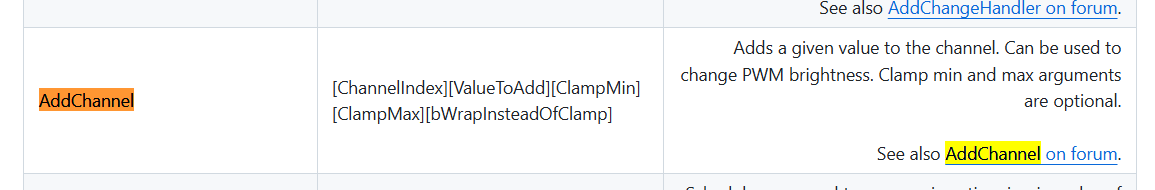

    Now, the addChannel is smarter than just adding value. It can also wrap around. Look:
    Table with AddChannel function description, syntax, and usage
    What is the range of dimmer here? 0 to 1000?
    So, if you do:
    AddChannel 2 100 0 1000 1
    do you get "wrap around" at 1000?
    If so... then you can probably script hold and click (and double click?) events.

  • Custom button mapping for dimming and direction toggle
    #28 21707334
    sp4rk1e
    Posts: 37
    I made some more tests with OpenBK7231N_1.18.185.rbl
    current autoexec.bat:
    // because standard S1 functionality allows only switching but not dimming
    // we replace S1 by a push button connected between P28 of the
    // WIFi module and ground
    // short press now switches on/off
    // long press is dimming either up or down
    // double press toggles dim direction up/down
    startdriver tuyamcu
    tuyaMcu_setBaudRate 115200
    tuyaMcu_defWiFiState 4
    //SetButtonTimes 10 3 3     // appears to be too much for the module? dflt: 10 3 5
    SetFlag 43 1                // Flag 43 - [TuyaMCU] Use queue
    SetFlag 10 0                // Flag 10 - [MQTT] Broadcast self state on MQTT connect DONT CLUTTER LOG
    // P28 connected to the push button
    SetPinChannel 28 35
    SetPinRole 28 Btn
    // define dim stepsize
    SetChannel 34 3
    addEventHandler OnClick    28 toggleChannel 1
    // clamping appears to refer to GUI view of values
    addEventHandler OnHold     28 addChannel  2  $CH34 0 100 1
    // reverse direction on double click
    addEventHandler OnDblClick 28 setChannel 34 -$CH34
    // Power On/Off dpID 1  - Channel 1
    setChannelType 1 toggle
    setChannelLabel 1 "CH1 On/Off"
    //Set hardware dimmer range (is mapped to 0, 100 in GUI)
    tuyaMcu_setDimmerRange  90 600
    startDriver httpButtons
    //Switch Type dpId=6 Enum V=<seconds>
    setChannelType 6 Textfield
    setChannelLabel 6 ":non-persistent countdown in seconds to power ON. Set 0 to cancel."
    linkTuyaMCUOutputToChannel 6 val 6
    the only changes compared to my previous one is setting Flag 43 - [TuyaMCU] Use queue
    observations:
    - flags are correctly shown on GUI home->config->configure flags
    - flags are incorrectly shown on GUI home->launch web application->config
    - brightness flicker during dimming up or down sporadically still happens
    as the log shows us, the hardware does not follow exactly our commands. Are odd/even brightness values not permitted?
    I later will have a closer look at that
    log when dimming (with some comments):
    Info:GEN:28 Button_OnInitialPressDown
    Info:GEN:28 Button_OnLongPressHoldStart
    Info:EVENT:EventHandlers_FireEvent: executing command addChannel  2  $CH34 0 100 1
    Info:GEN:CHANNEL_AddClamped channel 2 has changed to 91
    Info:GEN:CHANNEL_Set channel 2 has changed to 91 (flags 0)
    Info:MQTT:Channel has changed! Publishing 91 to channel 2
    Info:TuyaMCU:Received: 55 AA 03 07 00 08 02 02 00 04 00 00 02 2A 45
    Info:TuyaMCU:ProcessIncoming[v=3]: cmd 7 (State) len 15
    Info:TuyaMCU:ParseState: id 2 type 2-val len 4
    Info:TuyaMCU:ParseState: int32 554
    Info:GEN:CHANNEL_Set channel 2 has changed to 90 (flags 0)

    I can see two possible issues here.
    1. maybe you are right, try to replicate with setChannel
    2. maybe tuyamcu sends feedback from previous set and this feedback sets back mcu value? Maybe I could add a little flag/setting for you, that tells OBK to "ignore all dimmer values sent by tuyamcu"
  • #30 21707470
    sp4rk1e
    Posts: 37
    do you mean to replace
    with equivalent 'setChannel' construct?
    fine. If it's not too much effort for you. This flag makes sense for other devices too, when the Beken chip takes over some tasks of the MCU.
Discussion about flashing and configuring Avatto DMS16-W1 / DMS16-Y1 smart dimmer switches with OpenBeken on a Tuya MCU platform. The devices use a CBU module with a Puya PY32F002A MCU, and the thread focuses on mapping Tuya dpIDs for power, brightness, brightness range, switch type, power-on state, and timer functions. Users share factory dumps, autoexec.bat templates, and OpenBeken mappings for 1CH and 2CH variants, including custom button handling, dimming control, and web UI integration. A key issue was unstable dimming behavior and MCU feedback interfering with scripted control; this was addressed by adding an ignore-read / no-read flag in linkTuyaMCUOutputToChannel. The discussion also developed ping-pong dimming behavior, long-press and double-press actions, SetButtonTimes tuning, and optional firmware support for reversing dim direction, with tests performed on related Moyes MS-105 hardware.
TL;DR: For OpenBeken users modding Avatto dimmers, the proven path is 115200 baud with a TuyaMCU mapping; as one expert put it, "the ignore flag support is the only change really required" for stable scripted dimming. This FAQ shows how to flash the CBU, map 1CH/2CH dpIDs, and build reliable autoexec dimming with MCU feedback control. [#21711817]
Why it matters: This thread turns a partly working Tuya dimmer conversion into a repeatable OpenBeken setup, including stable dimming, dual-channel mapping, and custom button behavior.
