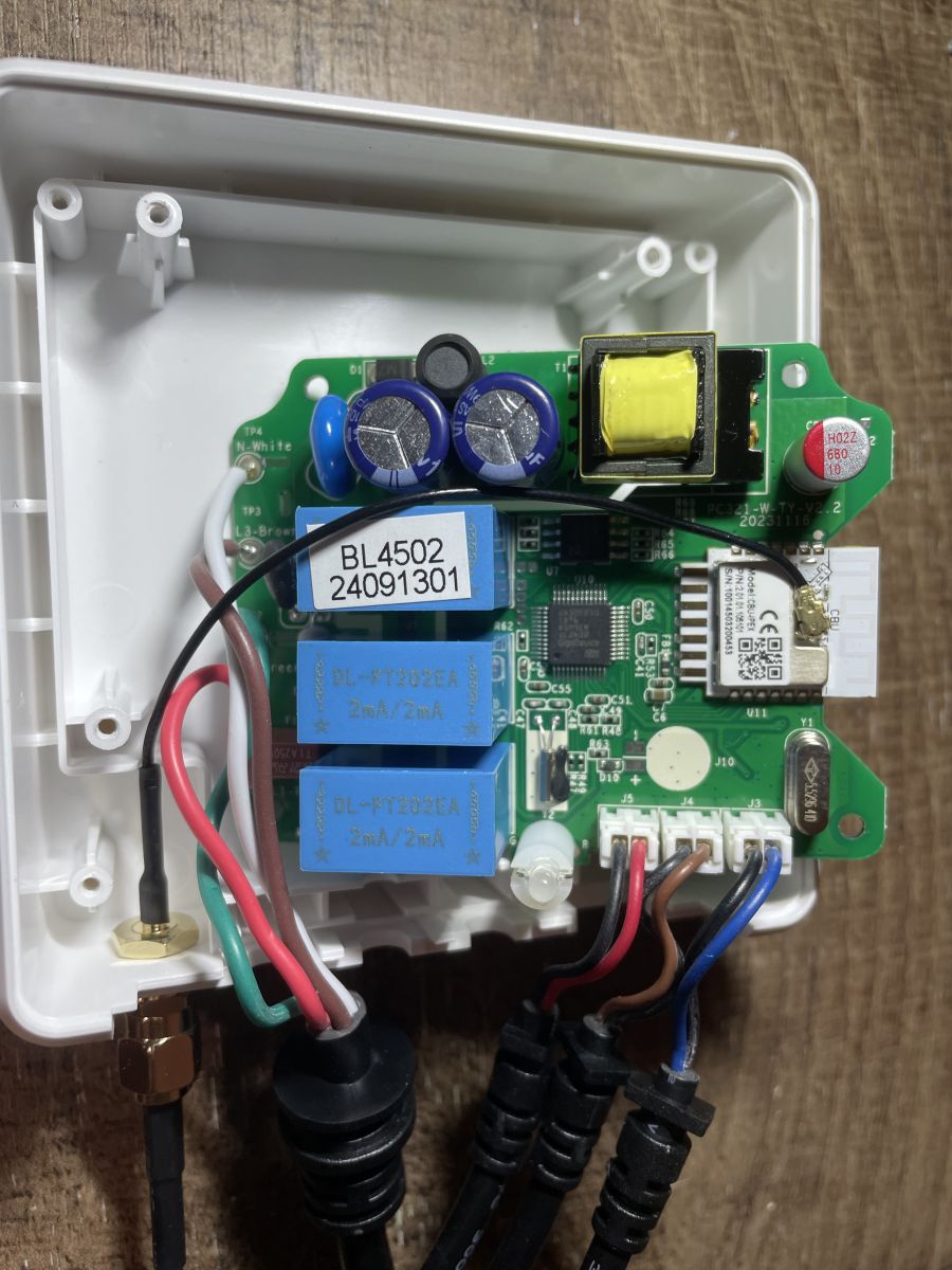

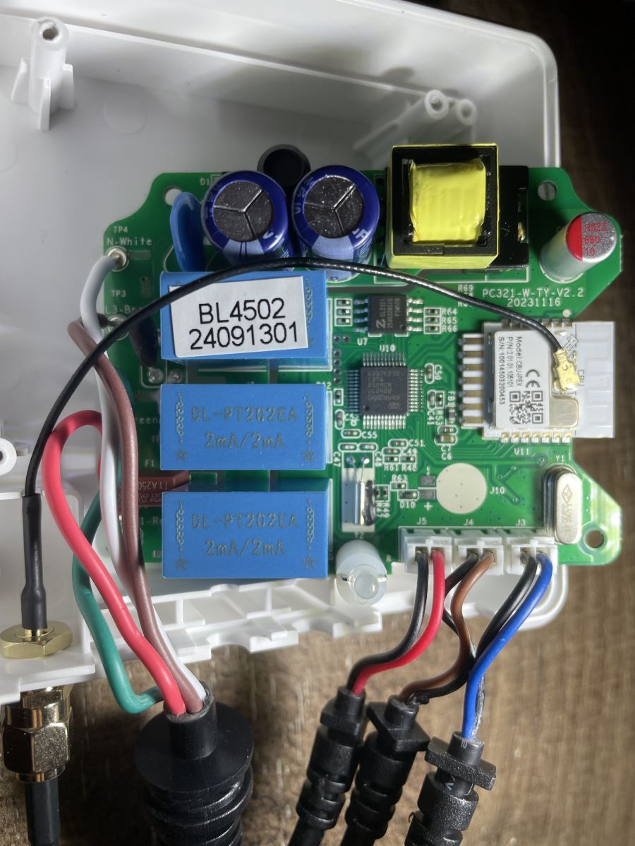

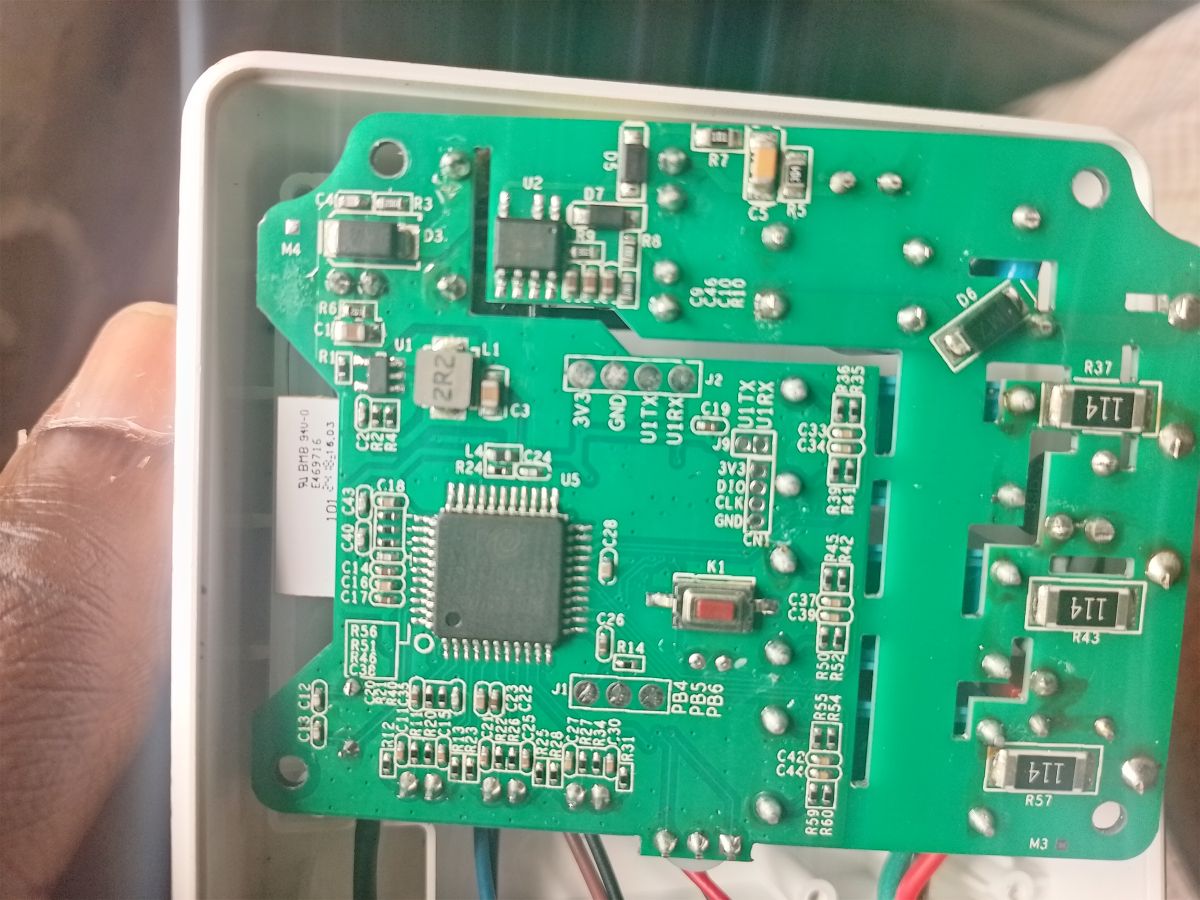

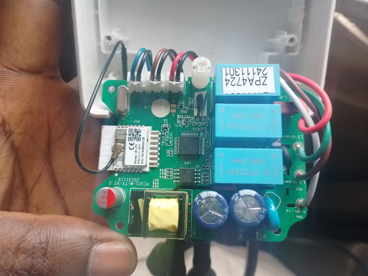

    So I got this 3 phase energy meter.
    It appears to be based around CBU-IPEX, so BK7231N MCU. Energy monitoring chip is ATT7022EU and GD32E230, some sort of STM32 clone (doing what exactly??) and 25VQ32BSIG 4MB SPI memory chip (for BK7231N maybe?).
    Strange little device. Any ideas if this could be made compatible with OpenBeken?

  • #2 21264823
    Posts: 14795
    Rate: 12953
    Well, isn't it a TuyaMCU device? TuyaMCU is more or less compatible with OBK, once you know the meaning of dpIDs...

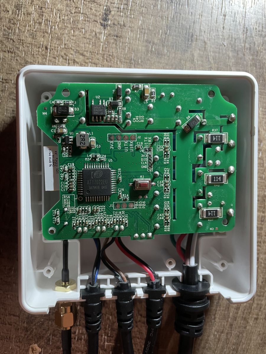

    #6 21266852
    hojnikb
    Posts: 45
    Can you share 2MB flash backup?
    I'm trying to backup the device using easy uart flasher, but with no success. I've directly soldered TX1 and RX1 to my usb-serial and did CEN pin short to ground, but unfortunately, it does not get detected by utility.
    Am I missing something?
    Added after 44 [minutes]:
    Perhaps there is something connected to the TX1/RX1 pins? I will attempt to desolder the module.
    Interestingly, there are two sets of rx/tx pin headers on the motherboard.
    Added after 20 [minutes]:
    Yep, this was exactly the culprit. After desoldering the module, reading was easy.
    Attached is dump of the flash. PC321-W-TY... DUMP .bin (2 MB)You must be logged in to download this attachment.

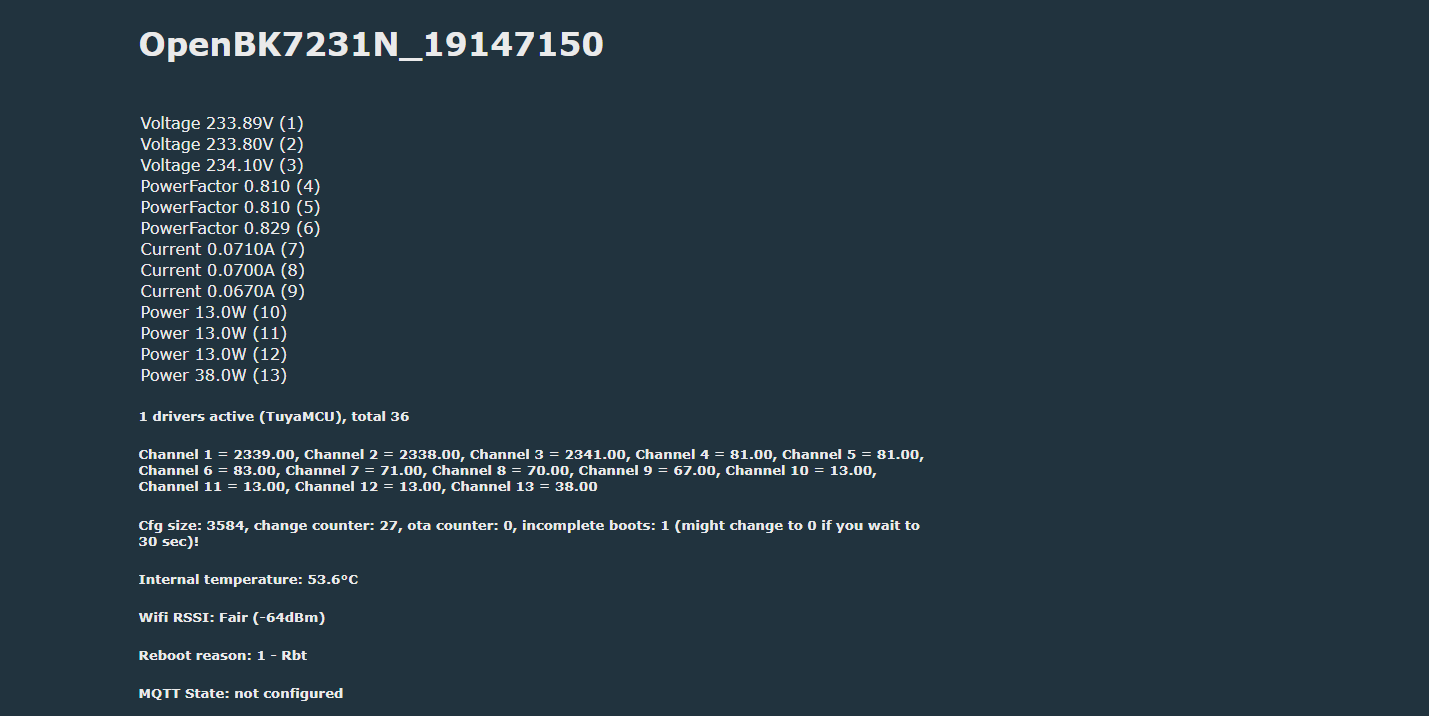

    The values that get spit out make some sort of sense (if my kill-o-watt was to be believed). Not too sure what values represent active or reactive power (would need a power meter capable of displaying these). I was also not able to find frequency value either for each phase or at least all of them.
    And to my understanding IDs 101-107 (and 111-117, 121-127) represent each phase and everything 131 and after must either be combined values or single values for the whole system, but I was not quite able to map all of them as of yet.
    Display of OpenBK7231N data showing voltages, power factors, currents, and powers for different phases.

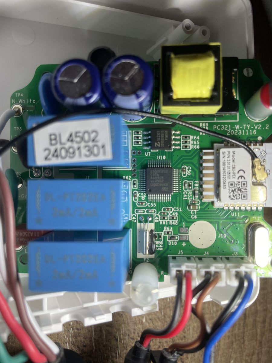

    #16 21416764
    crg1darkspr1te
    Posts: 22
    Rate: 12
    I recently got one of these units for testing and I was able to dump the GD32E230 chip, I have provided that dump along with data sheets and SVD file for the same.
    Anyone wishing to restore one of these units to full factory or replacing the GD32E230 chip can use the files enclosed.
    I will start reverse engineering over the weekend I think. Already started
    Some info:
    Bootloader 0x08000000 - 0x08003fff
    App program 0x08004000 - 0x0800dfff
    command checking 0x08008390
    app strings 0x0800d774

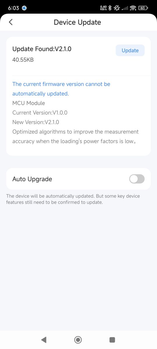

    Added after 24 [minutes]:

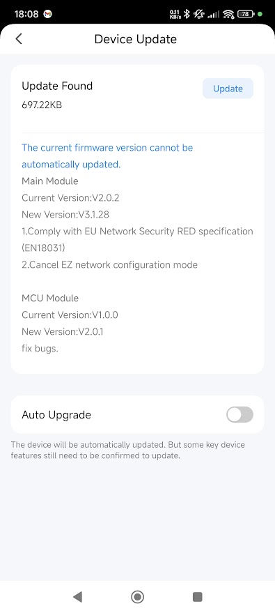

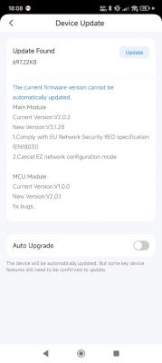

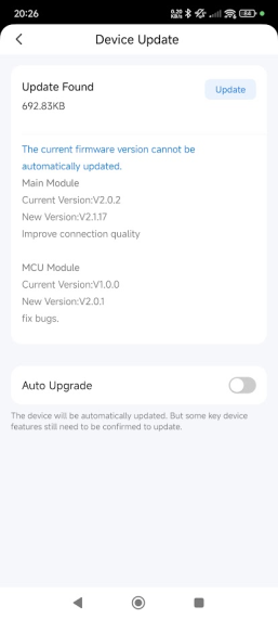

    also interesting that the BK7231N firmware now gets an update to v3.1.28 which uses the latest SDK version I've seen
    Device software update screen indicating new versions for the main module and MCU module.
    only in November was it offering an update to v2.1.17
    Device update screen showing information about a new software version.

    #22 21529481
    pheyi36hayo
    I have one of this gadget. Recently, the device is not powering on completely.
    The green or blue light isn't coming on at all. And, when I press down the reset button, the red light just blinks 3 times.
    I have traced the fault to some capacitor and diode.
    CD3, C1, C4 and Diode (D3). They are all short. (Although, I still don't understand what could I have caused the issue. The problem probably started from CD3.
    What I need now is, can anyone help identify the rating of this component so I can replace with the appropriate parts.
    Printed circuit board (PCB) with electronic components inside a casing.
    Close-up view of a circuit board inside an electronic device with visible relays, components, and wires.
  • #23 21530121
    crg1darkspr1te
    Posts: 22
    Rate: 12
    The marking on that component CD3 are F45Z 680 10,
    I am guessing that's 680uF at 10V and it's a polymer type capacitor, as those parts are on the SMPS side I would say a surge may have caused it or a failed cap from heat could have also taken out D1 but that's just a guess.
    The fine folks on EEVBLOG would know,
    darkspr1te
