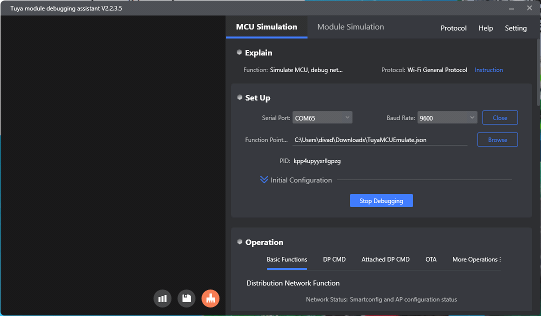

    To demonstrate how useful this application can be: sometimes I want to flash a factory firmware backup to a BK7231N dev module/board. Maybe I then want to pair with the Tuya app. Often though the firmware will not finish booting, or will just not be discoverable, until it receives a specific response from the TuyaMCU, which of course is not present because it's not running on the real device with everything in place. The TMDA will give the necessary responses so the module is discoverable.

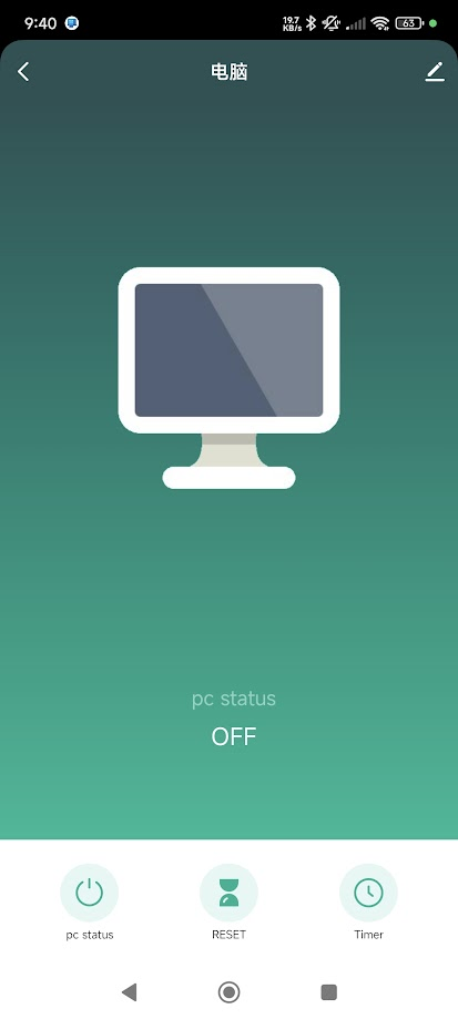

    The Function Point JSON file used in the attachment here https://www.elektroda.com/rtvforum/topic4062465.html#21280950 will allow the device to finish boot and be discoverable in the Tuya app but it will not complete pairing.
    Screenshot of the Tuya Module Debugging Assistant (TMDA) interface displaying MCU simulation.
    Here's the TMDA talking to a CBU flashed with a backup of this device https://www.elektroda.com/rtvforum/topic4083219.html. Without the TMDA to respond, it would not then discoverable in the Tuya app. I assume it gets stuck around here when it tries to talk to the TuyaMCU
    Screenshot of boot logs from the Tuya Module Debugging Assistant application

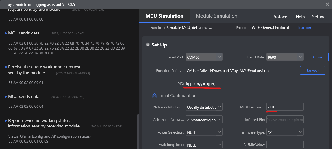

    but then with TMDA to respond (function point JSON file loaded -> open com port-> start debugging)
    Interface of Tuya Module Debugging Assistant version 2.2.3.5, showing MCU simulation.
    the boot log looks like:
    Screenshot of a console with device boot logs.
    note the MCU version and the product key match what I have set in TMDA
    Screenshot of the Tuya Module Debugging Assistant (TMDA) version 2.2.3.5.

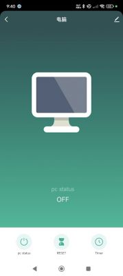

    and the device is now discoverable in the Tuya app BUT it will not pair

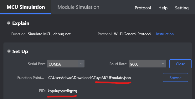

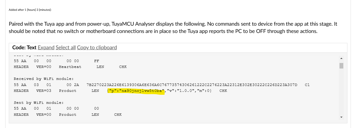

    but carrying on, we can change the {"Pro_Key":"kpp4upyyxrllgpzg" value in the JSON to match the pk discovered when exploring the original device. This key was revealed when sniffing the communications between the module and real MCU using TuyaMCU Analyser.
    Screenshot of TuyaMCU Analyser showing communication codes between a WiFi module and the Tuya app.
    Often the pk is revealed in the UART boot log.

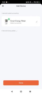

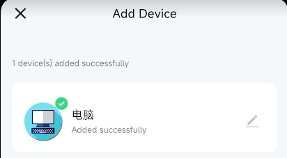

    And so with the key changed to na90jncjlvw5t0ba in the JSON, the device now pairs.
    Device addition screen in the app.
    App interface with a computer icon and power button. Device update screen with information on current module versions

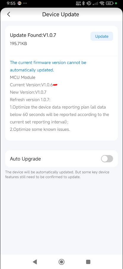

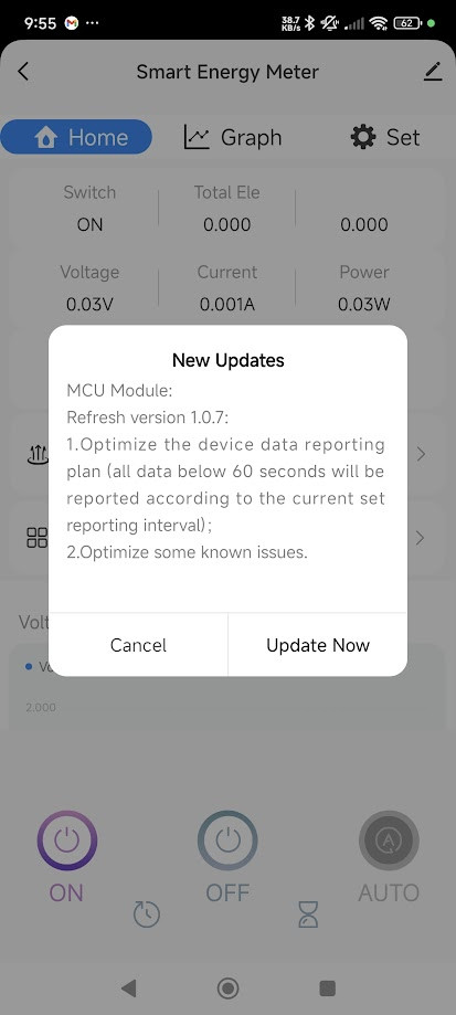

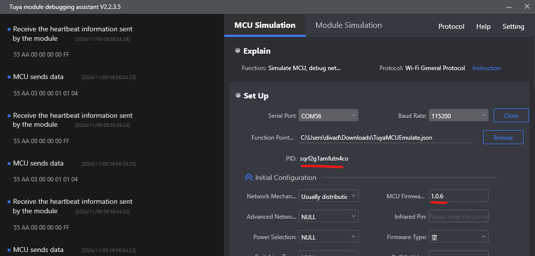

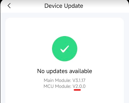

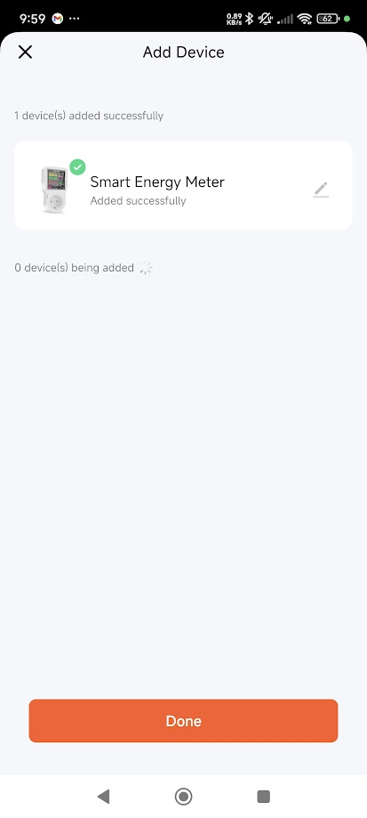

    And because you can set an arbitrary MCU version, you can fool the app into offering a TuyaMCU upgrade, if there is one available. I recall the Atorch S1-B offering an update to version 1.0.7 if the version was 1.0.6. And so it does again when testing with a backup of the firmware from that device using pk sqrf2g1amfutn4co:
    User interface of Tuya Module Debugging Assistant version 2.2.3.5 with MCU simulation mode.
    App screen showing successful addition of Smart Energy Meter device. Tuya software update screen on an energy meter. Screenshot of a device update application showing the availability of a new MCU firmware version.

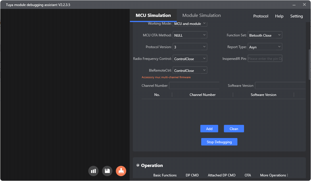

    And here is what TMDA looks like from unpaired device boot, pairing and then MCU upgrade file transfer to the device.
    Tuya Module Debugging Assistant V2.2.3.5 user interface with MCU simulation settings.

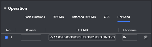

    That, so far, is the extent of my playing. There are many more interesting functions to play with, including Hex Send
    Operation bar in Tuya Module Debugging Assistant showing Hex Send section with input data and checksum.

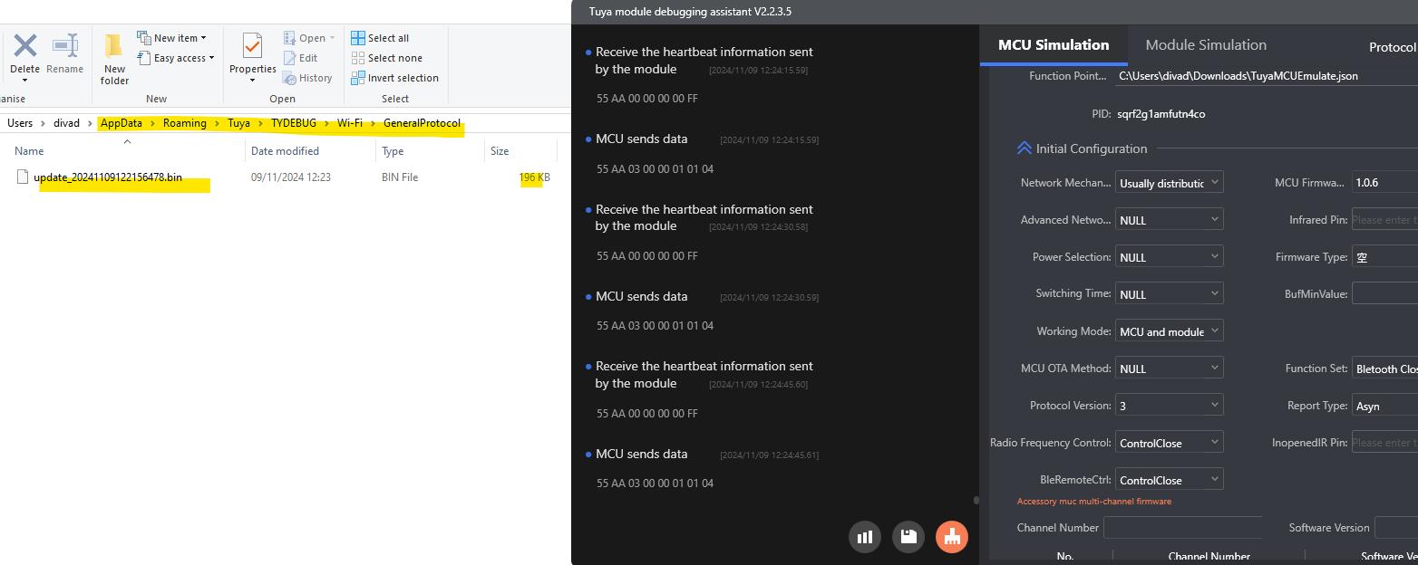

    TMDA saves the receiving MCU update file to the ..\AppData\Roaming\Tuya\TYDEBUG\Wi-Fi\GeneralProtocol path. Eg:
    Screenshot showing the saved update file and MCU simulation in Tuya.
    so now we can capture those updates for analysis too
