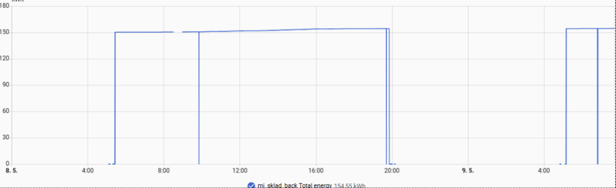

    Description:I am using a TuyaMCU-based smart energy meter with the latest OpenBeken build (1.18.288). Many TuyaMCU devices report a "0" value for Total Energy (dpID 105/2) for several seconds after a power cycle or reboot before the real value is synchronized from the MCU.
    The Problem:This initial "0" is immediately published to MQTT and, if persistence is not available or scripts fail, it overwrites the cumulative energy data in Home Assistant, causing massive negative spikes in Energy Dashboards.
    Proposed Solution:
    Internal Filter: Implement a flag or setting for linkTuyaMCUOutputToChannel that ignores "0" values if the previous known value was higher than zero.
    Persistence improvements:
    Ensure that even on builds where setChannelPersistence is missing, the energy driver can maintain the last known value during the boot-up handshake with TuyaMCU.Consistent
    Scripting: Ensure that addChangeHandler with conditional logic (e.g., if $CH5 < $CH10) is supported across all builds, including those with limited memory.
    Device Info:Build: May 3 2026 13:32:48 version 1.18.288Chip: BK7231 (T/N)

    I am using a WVC Microinverter (equipped with a CBU IPEX module, BK7231N) running OpenBeken version 1.18.288. Because this is a solar device, it power-cycles frequently (every morning or during low light).
    Can you post the relevant OpenBeken config/script and a short boot log or MQTT trace showing dpID 105/2 publishing 0 first and then the real total energy value (including your linkTuyaMCUOutputToChannel / addChangeHandler setup, if any)?

    00:00:01 - Device starts, NTP syncs.
    00:00:03 - TuyaMCU driver sends first update:
    Info:TuyaMCU:Processing DP 105 (Type 2): Value 0
    Info:MQTT:Publishing val 0 to mi_sklad_back/5/get retain=1 <-- THIS IS THE PROBLEM
    00:00:08 - TuyaMCU finally syncs real internal memory:
    Info:TuyaMCU:Processing DP 105 (Type 2): Value 15420
    Info:MQTT:Publishing val 154.20 to mi_sklad_back/5/get retain=1
    Blue line energy (kWh) chart with two high plateaus and a drop to zero around 20:00

    Maybe we could add a simpler solution - add a basic "warm up time" during which TuyaMCU values are not published? Like first 15 seconds or something, configurable.

    Hm, perhaps move linkTuyaMCUOutputToChannel for 105 dpId to the end, and add delay_s 8 before it?

    Delay linkTuyaMCUOutputToChannel 2 2 5 didn't work.
    This works: delay_s 15 startDriver MQTT

    What's going on? We don't have "startDriver MQTT", this does nothing.

    Delay_s 15 at the end of autoexec.bat does nothing. Script is run like a separate thread, MQTT starts on it's own without script. Where are you getting false info from? Sounds like you're being mislead by ChatGPT.
