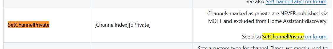

    SetChannelPrivate 1 1
    SetChannelPrivate 2 1
    SetChannelPrivate 3 1

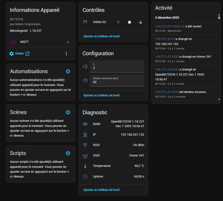

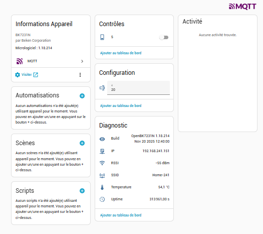

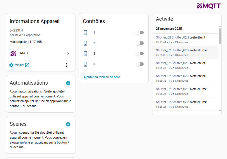

    Hi, sorry to revive the subject, but I own a big batch of these.
    They were configured to work on Jeedom and working well.
    I'm now switching to Home Assistant, and it seems that with my config they appear as 3 relays and not as a Cover entity.
    Do you know why? Do I have to update firmware and add a flag/startup driver script?
    Thanks a lot
  • #7 21762063
    Posts: 14770
    Rate: 12913

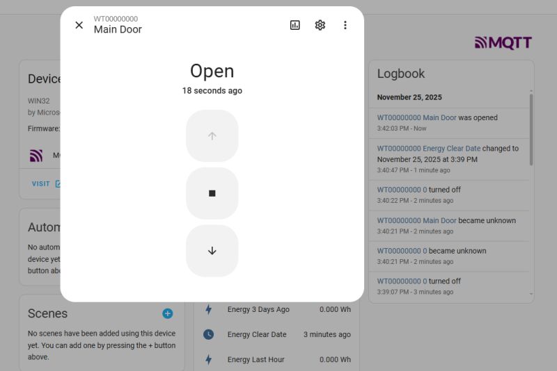

    So you have this script working, but it does not appear in HA?
    Maybe we can figure something out.
    I've managed to get Cover entity to show up in HA, but I dont' have hadware to test it with physical device.
    Main Door control panel displaying Open state with directional control buttons.
  • Latest firmware exposes safer shutter control in OpenBK
    #8 21762120
    Acefx
    Posts: 23

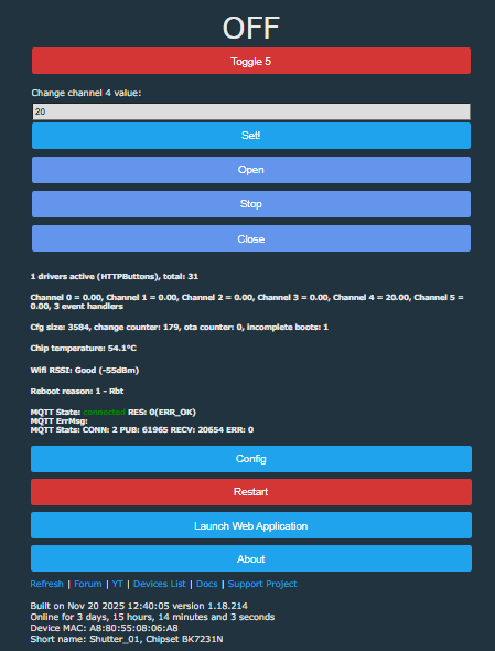

    Yes! I have plenty of hardware to test here.
    With the latest firmware to date, this is what I get in Home Assistant
    BK7231N device panel in OpenBK interface showing diagnostic and configuration data
    And in OpenBK firmware
    OpenBK interface showing control buttons and system parameters
    5 is the retrolighting of the command
    4 is the delay, calculated with a stopwatch.
    The good thing is that I don't have the relay anymore, because on the previous firmware I got
    MQTT interface showing BKT231N device info and shutter activity log
    which is pretty bad because it doesn't command "start opening / stop and start closing" but the relay itself, without any security.
    And you exactly know what occurs when a shutter motor is powered in both directions: destruction !

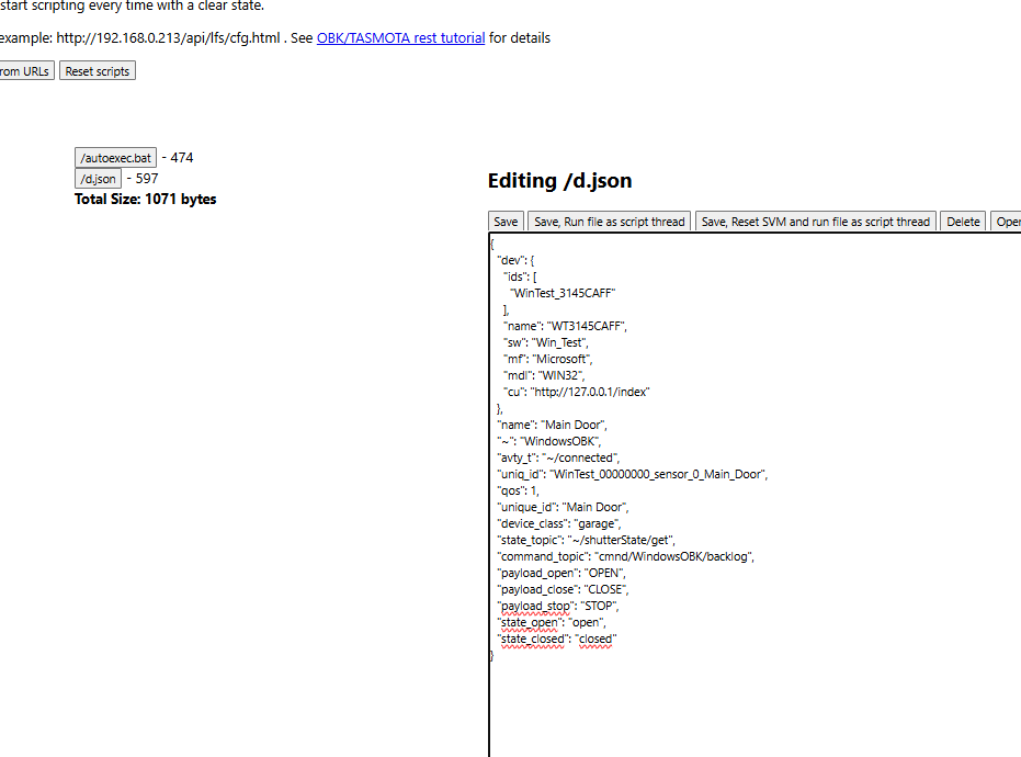

  • OpenWBK Home Assistant discovery and button script setup
    #15 21767428
    Posts: 14770
    Rate: 12913

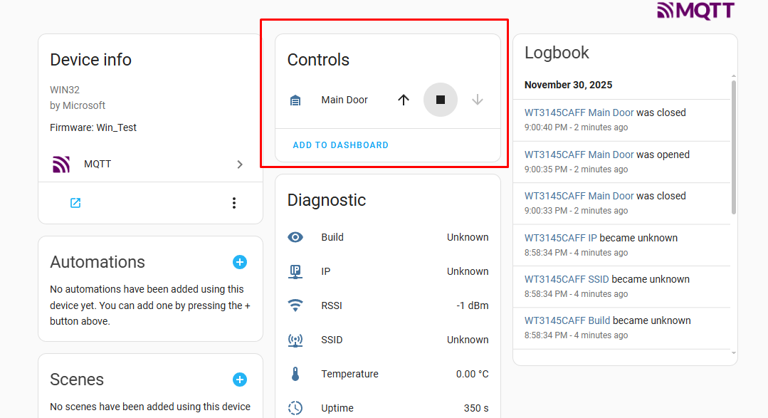

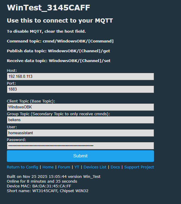

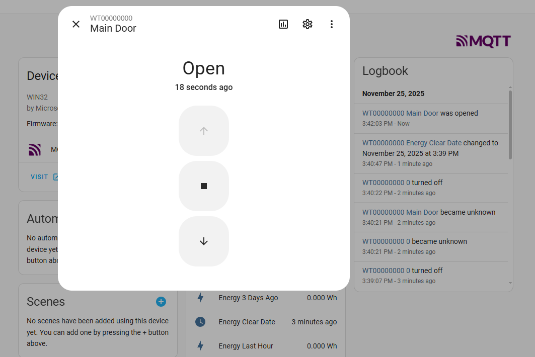

    We would need a C driver for best results, but currently, with latest OBK update, you can do something like that.
    Screenshot of JSON editor displaying configuration for Main Door sensor
    1 HA discovery JSON:
      "dev": {
        "ids": [
          "WinTest_3145CAFF"
        "name": "WT3145CAFF",
        "sw": "Win_Test",
        "mf": "Microsoft",
        "mdl": "WIN32",
        "cu": "http://127.0.0.1/index"
      "name": "Main Door",
      "~": "WindowsOBK",
      "avty_t": "~/connected",
      "uniq_id": "WinTest_00000000_sensor_0_Main_Door",
      "qos": 1,
      "unique_id": "Main Door",
      "device_class": "garage",
      "state_topic": "~/shutterState/get",
      "command_topic": "cmnd/WindowsOBK/backlog",
      "payload_open": "OPEN",
      "payload_close": "CLOSE",
      "payload_stop": "STOP",
      "state_open": "open",
      "state_closed": "closed"
    2. autoexec stub:
    alias open echo "Your open handling"
    alias close echo "Your close handling"
    alias stop echo "Your stop handling"
    addEventHandler OnDiscovery 0 publishFile homeassistant/cover/WinTest_00000000_sensor_0_Main_Door/config d.json 1
    scheduleHADiscovery
    startDriver httpButtons
    setButtonEnabled 0 1
    setButtonLabel 0 "Send closed"
    setButtonCommand 0 "publish shutterState closed"
    setButtonEnabled 1 1
    setButtonLabel 1 "Send open"
    setButtonCommand 1 "publish shutterState open"

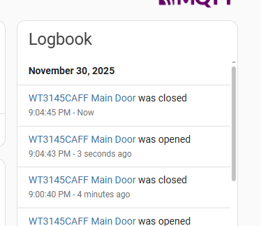

    HA should see:
    Main door control panel with MQTT branding and diagnostic data display

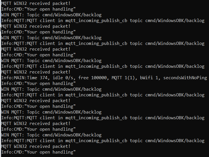

    if you press buttons in HA:
    Console with repeated MQTT debug messages showing packet receipt and command handling\
    If you press buttons in OBK:
    Event log from November 30, 2025 showing WT3145CAFF door opening and closing.
    Note that you need to edit json to have your mqtt device name:
    MQTT configuration screen with input form and device information
    Added after 36 [seconds]:
    This is basically a communication stub for HA, to be linked with existing script
  • Need to adapt autoexec.bat to local hardware

    Well, I assumed that you are familiar with basic programming, but here are more hints:
    1. you need to adapt json file to is has your device topic and name
    2. you need to adapt your autoexec.bat , I basically did only communication with HA
    2.1 you need to adapt calls from HA, replace echo with your aliases:
    Comands "open", "close", "stop", must not change - that's what HA sends.
    2.2 to tell HA that shutter state is, for example, closed, you need to call publish shutterState closed in your code

    Added after 4 [hours] 2 [minutes]:
    Ok i tried many things today but i can't either make it recognize as a cover , and still operate it "per relay " which is pretty bad in term of self destruction.
    I'm going to need some more help ( if possible )
  • #21 21768003
    Posts: 14770
    Rate: 12913
    I don't think that AI is reliable source of information.
    I'd suggest to first try to get it working with hardcoded MQTT name, I can make it flexible later.
    Also, set channels as hidden so they don't get discovered along with cover entity.
    My first question is - did you manage to get cover entity discovery working?

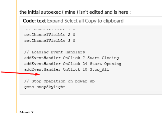

    #22 21768019
    Acefx
    Posts: 23
    Your're totaly right, IA is completly out of subject, going in wrong direction. and i'm lost !
    Let do it step by step.
    1. the d.json is on the module
    the initial autoexec ( mine ) isn't edited and is here :
    // Autoexec file for Etersky WS01, please adapt to your hardware if different
    // Set up Aliases
    alias Set_Stop backlog setChannel 3 0; setChannel 1 0; setChannel 2 0; setButtonColor 3 CornflowerBlue; setButtonColor 2 CornflowerBlue; setButtonColor 1 CornflowerBlue
    alias UPmouv_Stop backlog  setChannel 1 0
    alias DWmouv_Stop backlog setChannel 3 0
    alias Set_Open backlog setChannel 1 1; setButtonColor 1 Coral
    alias Set_Close backlog setChannel 3 1; setButtonColor 3 Coral
    alias Set_Finish backlog setChannel 2 1; setButtonColor 2 Coral
    alias Start_Opening backlog stopAllScripts; startScript autoexec.bat openSkylight
    alias Start_Closing backlog stopAllScripts; startScript autoexec.bat closeSkylight
    alias Stop_All backlog stopAllScripts; startScript autoexec.bat stopSkylight
    alias Stop_led_up backlog setButtonColor 1 Coral
    alias Stop_led_finish backlog setButtonColor 2 Coral
    alias Stop_led_dw backlog setButtonColor 3 Coral
    // create GUI buttons for HTTP panel
    setButtonLabel 1 "Open"
    setButtonCommand 1 Start_Opening
    setButtonEnabled 3 1
    setButtonLabel 3 "Close"
    setButtonCommand 3 Start_Closing
    setButtonEnabled 2 1
    setButtonLabel 2 "Stop"
    setButtonCommand 2 Stop_All
    // Hide the default GUI buttons
    setChannelVisible 1 0
    setChannelVisible 2 0
    setChannelVisible 3 0
    // Loading Event Handlers
    addEventHandler OnClick 7 Start_Closing
    addEventHandler OnClick 24 Start_Opening
    addEventHandler OnClick 10 Stop_All
    // Stop Operation on power up
    goto stopSkylight
    // do not proceed
    return
    openSkylight:
    DWmouv_Stop
    delay_ms 5
    Set_Open
    setChannel 2 0

    Adjust d.json to match your device name and mqtt topic.
    Then paste my autoexec.bat content here and do hass discovery:
    Screenshot of code with three addEventHandler functions and a red arrow pointing at one.
    Then, maybe, hide the relays you mentioned from HA with SetChannelPrivate command in your script. When you retry discovery, just to be sure, remove old device discovered by HA

    Acefx
    Posts: 23
    Ok, following your hint, I still have the channel visible in MQTT Explorer so I may have placed the
    SetChannelPrivate at the wrong place/syntax
    I added:
    SetChannelPrivate 1
    SetChannelPrivate 2
    SetChannelPrivate 3
    SetChannelPrivate 4
    Is it the right way to do it?
    Added after 35 minutes:
    Update,
    I think the autoexec with the cover routine is messing everything up.
    Even when renaming all the MQTT topics and names, I get the 5 raw relays straight to Home Assistant after the HA discovery procedure.
    If you don't have time to rewrite the script cleanly (even the one that makes the cover work), I will do it with some HTTP API calls as before.
    I think I don't have the knowledge to insert some code inside a script whose function I barely understand.
    If you have time to rewrite something I can test it on all the devices I have here, if not: thanks for the effort.

    Posts: 14770
    Rate: 12913
    Documentation table showing SetChannelPrivate command and its description
    This command requires two arguments, second should be 1 to set channel to private to hide it.

    Acefx
    Posts: 23
    Ok, I had some time working a bit on this (what a pain).
    After all my integration & test
    I succeeded understanding the autoexec
    I succeeded understanding the backlog concept
    I succeeded hiding the "Raw" relay to let only the logic command.
    I succeeded hiding it from Home Assistant MQTT
    I also succeeded in sending the Home Assistant discovery @ start... But it's not sending it with the good prefix
    I find it inside the device topic (instead of root). Any idea for this? I think it's the last problem
    Edit: Not really the last one, are you aware of another bug? When I browse into the "flag" section of the firmware, it starts to load then freezes the module (unresponsive) for approx 20 to 30 min then comes back to life.
    Added after 56 [minutes]:
    Re-Edit.
    My d.json was somewhere faulty, now I can get a correct publishing in Home Assistant topic, and a cover entity that calls the correct backlog. Pain Pain Paiinnnn
    Next step is certainly the publishing of the shutter state, after each move / stop so I can get correct information.
    Seems there is also a big mismatch between names:
    MQTT topic / shortname has to be the same ...
    My state @ the end of the night is that I finally got an entity for the shutter, with the correct command (not yet the state update)
    but for now I got the modules on another side...

    Ok so i managed to get these info, pretty everything that we need to command it
    BK7231N device control panel with diagnostics and recent activity sections
    Diagnostic informations are transmitted only when the flag [2] is activated
    by the way, the flag ui page display under certain circonstance freeze the module for approx 20 minutes.

    and d.json ( discovery template )
      "dev": {
        "ids": [
          "VOLETS_02"
        "name": "VOLETS_02",
        "sw": "1.18.221",
        "mf": "Beken Corporation",
        "mdl": "BK7231N",
        "cu": "http://192.168.241.152/index"
      "name": "Volets 02",
      "~": "VOLETS_02",
      "uniq_id": "VOLETS_02_cover",
      "qos": 1,
      "unique_id": "Volet living 01",
      "device_class": "shutter",
      "command_topic": "cmnd/VOLETS_02/backlog",
      "payload_open": "Start_Opening",
      "payload_close": "Start_Closing",
      "payload_stop": "Stop_All",
    Next step is to implement variable based on Mqtt topic and shortname so we don't have hardcoded shitty d.json
