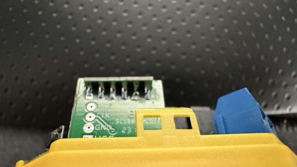

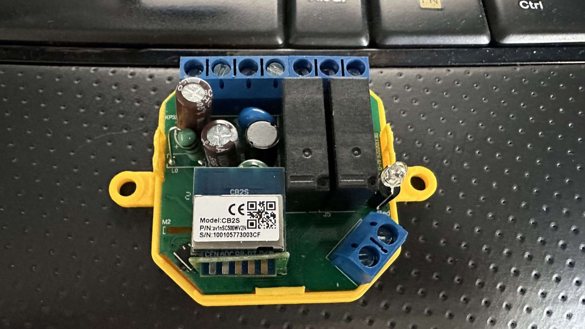

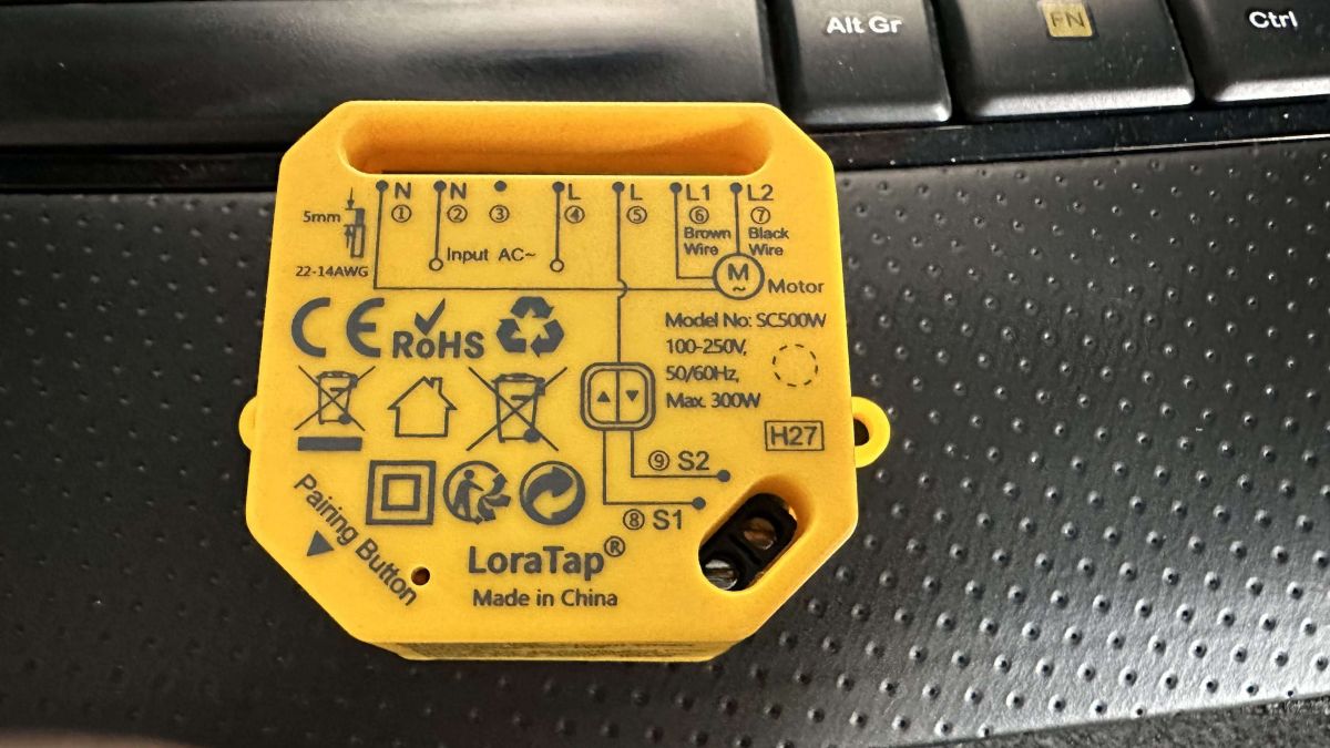

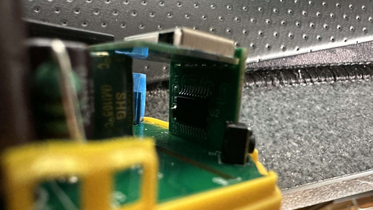

    in order to repair my curtain, I've ordered this switch and here are some pictures:
    It can control a 3 wires curtain and you can also attach an up/down switch to the S1/S2 contacts
    Yellow LoraTap SC500W module on a keyboard background.Electronic module CB2S on a keyboard.
    PCB with pins and markings CLK, GND, and VCC.Close-up view of an electronic switch with a mounted integrated circuit module.
    As you can see, a good old CB2S soldered only on one side to a kind of raiser holding what I supposed to be the MCU.

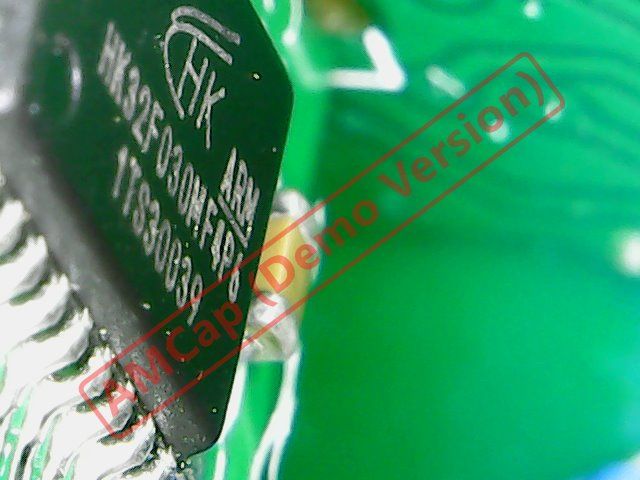

    This component you can see on the last picture below the CB2S is that one:
    Close-up of an HK32F030MF4P6 MCU microprocessor on a green circuit board.
    Info from Tuya app are:
    - main module: V2.0.2
    - MCU Module: V1.0.0
    I've dumped the original firmware but no config found.
    Do you think this device could be converted to OBK or this MCU (if it is one) is not supported?

    This is most likely TuyaMCU device. This may be tricky to convert but end result will be very good, as the main shutter logic is on the MCU , and not on the WiFi module.
    Here is a broad TuyaMCU guide: TuyaMCU flashing, setup and configuration guide - configure dpIDs for Home Assistant
    Please familiarize yourself with it and then we can try to convert this device to work with OBK. I will guide you step by step.

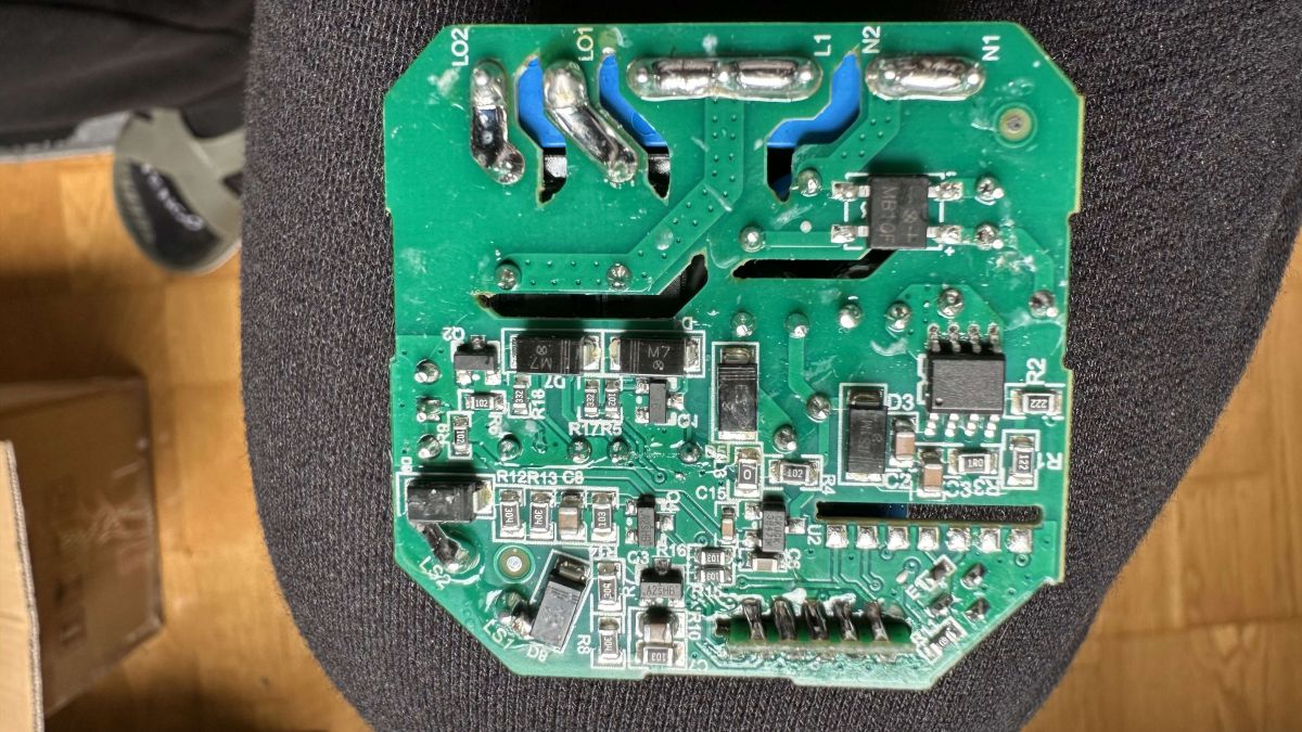

    Are you able to find the AMS1117-3.3V or the step down converter on this board?

    i can't find the former voltage regulator for 3.3V and not skilled enough to find the other voltage regulator/dropdown components. Here is a picture of the board :
    Image of a green electronic circuit board with various components like capacitors and resistors.

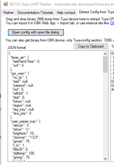

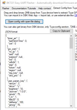

    if you run your backup through Easy Flasher here, does it produce a json output?
    eg
    [CB2S/BK7231N] Loratap SC500W-V2N2-YELLOW Smart WiFi Curtain Switch
  • Tuya device info dump with UUID and keys
    #13 21927878
    opfer15
    Posts: 8
    >>21927860
    yeah i get the following output

    Sorry, no meaningful pins data found. This device may be TuyaMCU or a custom one with no Tuya config data.
    Baud keyword found, this device may be TuyaMCU or BL0942. Baud value is 115200
    No module information found.
    Device internal platform - bk7231n, equals BK7231N.
    And the Tuya section starts, as usual, at 2023424 (0x1EE000)
