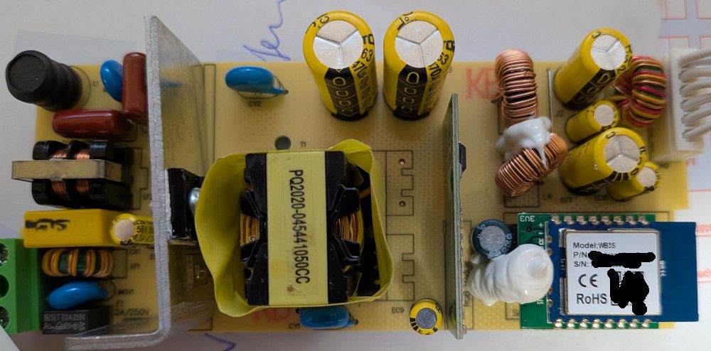

    Hi folks,
    I bought it by accident for cheap (40 euros), was not aware it only works with cloud, so it's my first Tuya device. Was looking around how to "fix" it and perform cloud exorcism :) I found this forum and OpenBeken alternative firmware and flashed it (serial w/o desoldering the chip).

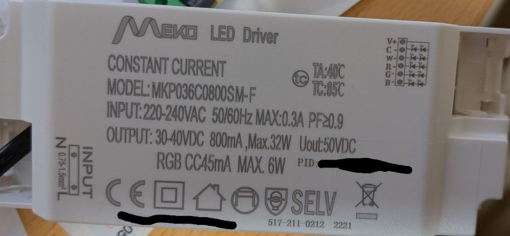

    It looks quite similar to https://www.elektroda.com/rtvforum/topic4025977.html but with an extra RGB, not backlight, but frame (EAN: 4058075752641).
    I am not sure if this device type is already known, though it works. I used the JSON created with the GUI flash tool. But only one at a time works: the white panel or the RGB frame. Would be great if both could be on at the same time (from home page).
    edit: in the webapp when I set the channel values directly I can enable both lights simultaneously: 2 channels coldwhite+warmwhite are for the main ambient light and three for the RGB frame.
