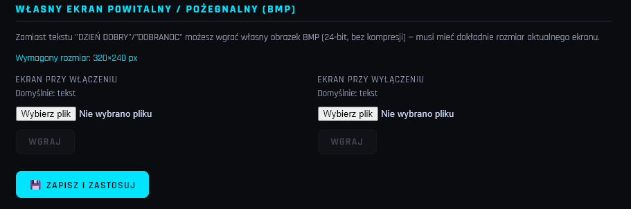

    Added in version 1.0.4_I:
    ⭐ Custom welcome/goodbye screen — in the Display tab, you can now upload your own image instead of the ‘GOOD MORNING’/‘GOOD NIGHT’ text when switching the radio on/off

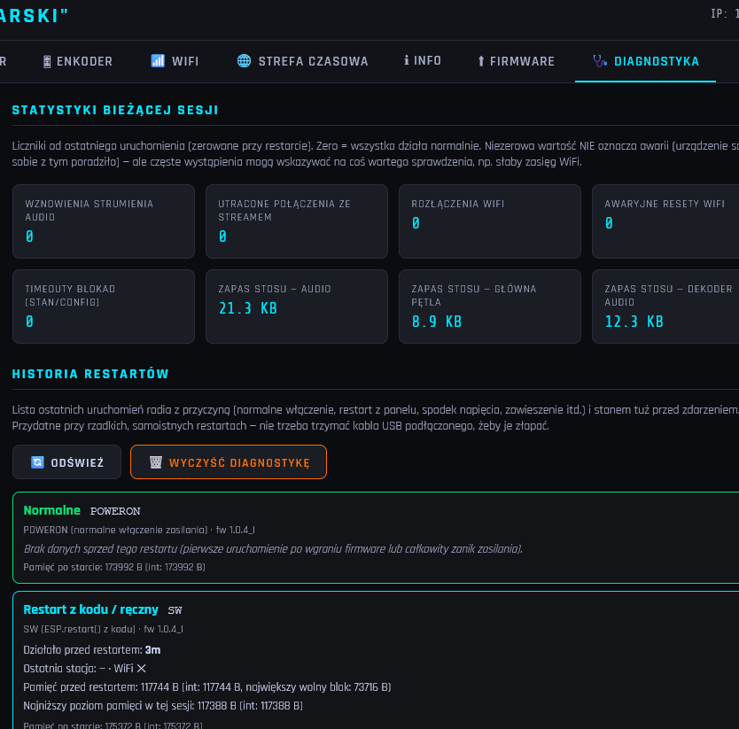

    Do you have to wait a long time every time you switch on the radio?
    Which file did you flash?
    The simplest Internet radio on the ESP32-S3? No installation required – just upload it and it works!
    From the description, it sounds as though there’s a problem with the partitions – in other words, the upload went wrong.
    Once it’s up and running, what does the ‘Diagnostics’ tab show?

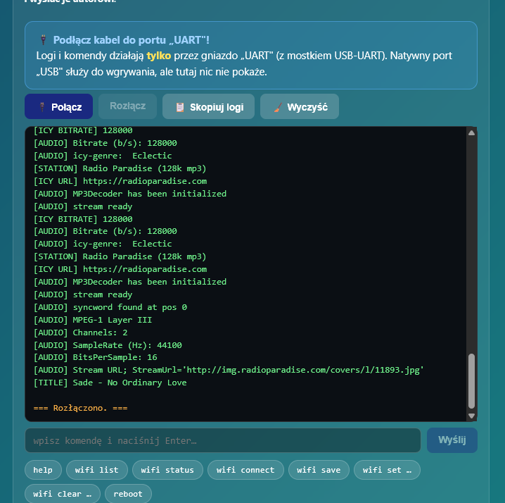

    Is there any chance of getting data from the terminal? For example:

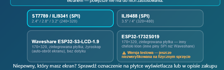

    I installed firmware 1.0.4_I via a USB cable on a board with an ILI9488 display, and so far everything is working perfectly. The only thing I’ve noticed is that the welcome screen appears twice every time I switch the device on. Then ‘WiFi OK’ appears and the radio starts playing. The control indicators are running smoothly.

    I installed firmware 1.0.4_I via a USB cable on a board with an ILI9488 display, and so far everything is working perfectly. The only thing I’ve noticed is that the welcome screen appears twice every time I switch it on. Then ‘WiFi OK’ appears and the radio starts playing. The control indicators run smoothly.d5374d24a
    Thank you for letting me know. The changes were quite extensive to handle all these displays without any issues, so I may have made a few mistakes. I’ve already installed the new version on a few radios for my family and haven’t encountered the sort of problems described by others. But as we know, every case is different.
