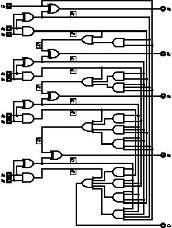

  • Serial arithmetic units in older Odra computers
    #38 21928881
    TechEkspert
    Editor
    Posts: 7353
    Help: 17
    Rate: 5719
    I’ve just been asked about the Odra in connection with this article, specifically regarding the arithmetic units in older Odra models and computers from that period in general. It turns out that serial arithmetic units were used to save on the number of transistors required. These involved single-bit operations combined with shifting the contents of registers. Such operations were slower, but the hardware was less complex. Also, for example, whilst the K-202 performed a million operations per second, it took many cycles for the arithmetic unit to complete its calculations.
    Let’s see what elektrodabot knows about its predecessors ;)
    @ElektrodaBot how did serial arithmetic units work in the Odra series of computers, for example in the Odra 1305? How many cycles of the arithmetic unit were required to perform addition and multiplication in both fixed-point and floating-point versions? Were there any special versions of the arithmetic units with increased precision? If the KAR-65 computer performed 100,000 floating-point operations per second, what must the internal clock speed of the arithmetic unit have been?
  • Odra 1305 used parallel, not serial arithmetic

    We need to distinguish between two things here:
    1. Serial arithmometers were indeed a natural solution in older machines, especially those with drum memory and shift registers , for example in the Odra 1003/1013 class.
    2. The Odra 1305 was no longer a typical machine with a serial arithmetic unit . The Odra 1305 catalogue documentation specifies its operating mode as parallel, asynchronous , a 24-bit word + check bit , TTL technology and operation times: fixed-point addition 2.1 µs , fixed-point multiplication 10 µs , floating-point addition 18 µs , floating-point multiplication 29 µs . In OCR scans, the character ‘µ’ is sometimes mistakenly recognised as ‘p’, but from the context it is clear that these are microseconds. ( historiainformatyki.pl )
    In other words: if we are asking about pure serial arithmetic units, then we are likely referring to earlier Odra models; if we’re asking about the Odra 1305, we should be talking about the execution time of an instruction/microprogramme, rather than a simple calculation: 1 bit = 1 cycle.
    How a serial arithmetic unit worked
    The serial arithmetic unit did what every pupil does today ‘on the back of a piece of paper’, only in the binary system:
    - the operands were stored in shift registers,
    - in a single clock cycle, one bit from the first argument and one bit from the second argument,
    - the one-bit adder calculated the result bit and the carry,
    - the carry was stored in a latch and used in the next clock cycle,
    - after each step, the registers shifted their contents.

    Fixed-point and floating-point arithmetic
    In machines with a serial arithmetic unit, the difference between fixed-point and floating-point arithmetic was enormous.
    Fixed-point
    Addition:
    Code: text
    In a serial arithmetical unit:
    1. clearing the carry,
    2. shifting bits from least significant to most significant,
    3. sum of bits + carry,
    4. storing the result,
    5. overflow check.
    For 39 bits: approximately 39 bit steps .

    In fact, every addition operation works, as it were, in series ;)
    Addition always starts from the least significant bit, and the result of the next bit must be corrected by a carry; in reality, therefore, each addition is delayed by the number of bits multiplied by the gate delay.
    Such a serial circuit has another advantage, apart from the obvious reduction in the number of components – meaning it is cheaper – namely that, in principle, numbers with any number of bits can be easily added together, regardless of the data bus width.
    A similar solution, namely a serial arithmetic unit, was used in the Datapoint 2200 terminal, whose unit – built using TTL circuits – served as a model for the designers of the i8008 processor and, consequently, for all Intel processors in the 8080 and x86 families, etc.
  • #45 21929040
    tzok
    Posts: 38925
    Help: 3179
    Rate: 6567
    It is possible to use addition with carry-lookahead (CLA)... this is a much faster solution, but it requires the use of a greater number of transistors/gates.

    Yes, but then the demand for gates and connections increases exponentially, which starts to become a problem with low-integration circuits, and the increase in speed is rather modest.
    Not least because instruction cycles take considerably longer than the propagation time of a single gate.
    What’s more, the architecture is further complicated by the move away from BCD arithmetic, which was dominant in early computers.
    That is why most early processors used microcode.
    As a point of interest, a 16-bit 68000 took quite a long time to multiply two 16-bit numbers, a time that depended on the number of ones in the operand according to the formula
    38+2n for the MULU instruction, and if the result of the previous multiplication was taken into account, it depended on the number of combinations of 10 for the input data with the MULS instruction.
    The worst-case scenario was for the input 0x5555.
    It was even worse for division, where the average instruction execution time was 158 cycles.
    So, all in all, the 8-bit 6502 processor, which lacked multiplication instructions, required a comparable number of cycles to perform multiplication via a subroutine at the same clock frequency.
    And these are external clock cycles; the 68k processor actually operated at twice the external clock speed.
    There is also something known as the ‘Manchester carry adder chain’. However, it cannot be implemented in every technology.
