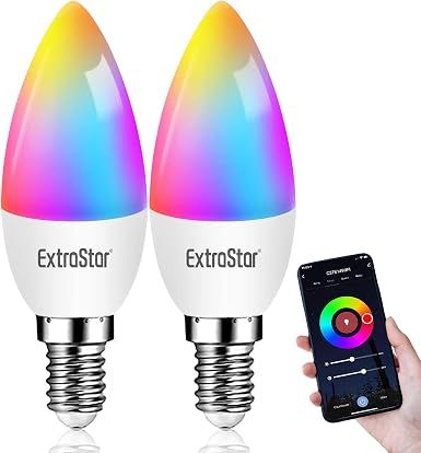

Hi everyone,
I successfully flashed an EXTRASTAR E14 6 W RGB+CCT with OpenBeken and wanted to share the working configuration.
Device: EXTRASTAR E14 6 W RGB+CCT
MCU: BK7231N
LED driver: BP5758D
GPIO configuration:
P24 = BP5758D_DAT
P26 = BP5758D_CLK
LED type:
RGB + Warm White + Cool White (RGBCW)
Working LED mapping:
1 0 2 3 4
Command:
Everything has been tested, and the five channels are working correctly.
Hopefully this helps other EXTRASTAR E14 6 W owners.
