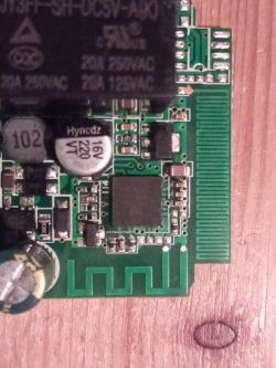

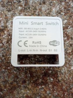

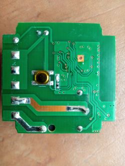

    bought some of these so called 'Mini Smart Switches' from our favorite Chinese marketplace, For incredible 2.59€ per piece.
    Tuya Smart Switch 16A WiFi module with technical specs and customer ratings
    Mini Smart Switch housing showing technical specifications and connector labels
    again a new variant of this device. At least I've not seen such on this forum.
    Unfortunately with a T34 directly mounted on the board. Even with all of our beloved flash signals exposed somewhere on the board.
    Electronic module with relay, capacitors, and PCB antenna on wooden surface
    Green printed circuit board with visible traces and solder points
    Except TX. Holy crap no way to grab this pin except removing the whole chip :-(
