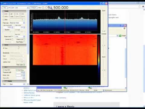

Yes, it is possible to listen to frequencies from the computer.
And it is not necessary to buy devices at cosmic prices.
All you need is the Not Only TV DVB-T USB DELUXE LV5T TV tuner.
Here is a youtube video showing the whole process.
