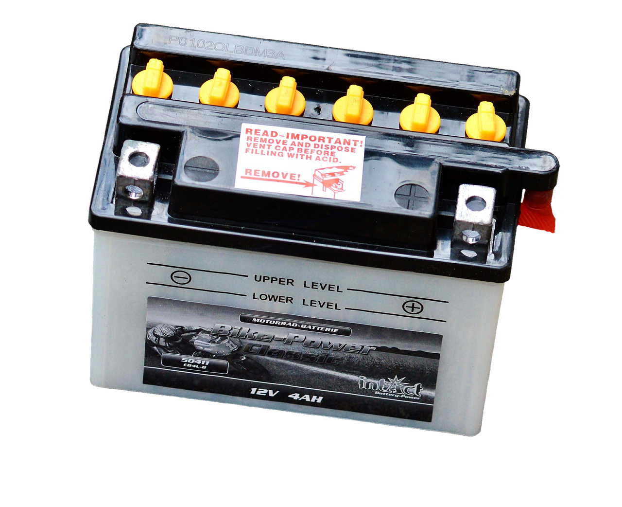

  • Ampere-hour capacity describes how long a battery can supply a given current, so 1A from a 1Ah battery lasts about one hour.
  • A 10Ah battery can theoretically run a 1A load for 10 hours or a 2A load for 5 hours, though real capacity drops at higher discharge currents.
  • Voltage matters too: 12V 10Ah equals 120Wh, 6V 10Ah equals 60Wh, so watt-hours better compare total stored energy than ampere-hours alone.
The receivers draw a certain current from the battery or accumulator. How long they can operate depends on the capacity of the cells that make up the battery. If the receiver draws a current of 1A, it will take a 1Ah charge within an hour. A 10Ah battery could theoretically power a receiver requiring 1A for 10 hours. In theory, for a receiver requiring a current of 2A, the working time on a 10Ah battery will be shortened to 5 hours (in practice, the higher the discharge current, the smaller the actual battery capacity). Resistive loads (e.g. a light bulb) will consume lower current as the battery voltage drops. Receivers equipped with a DC / DC converter can receive constant power with changes in voltage, i.e. when the supply voltage drops, they will consume more current.
We left out the voltage of the battery and only focused on the ampere-hours for its capacity. Both the 12V 10Ah battery and the 6V 10Ah battery can power a receiver using 1A current for 10 hours, but in the case of 12V the receiver will use 12W and in the case of 6V it will be a 6W receiver. Therefore, the capacity of the batteries is often specified in Wh, i.e. a 10Wh battery can supply a receiver with 1W power for 10 hours. The aforementioned batteries have a capacity per Wh, respectively: battery 12V 10Ah -> 120Wh, while 6V 10Ah -> 60Wh. You will also find watt hours, or rather kWh, in electricity meters in the home power supply system.
