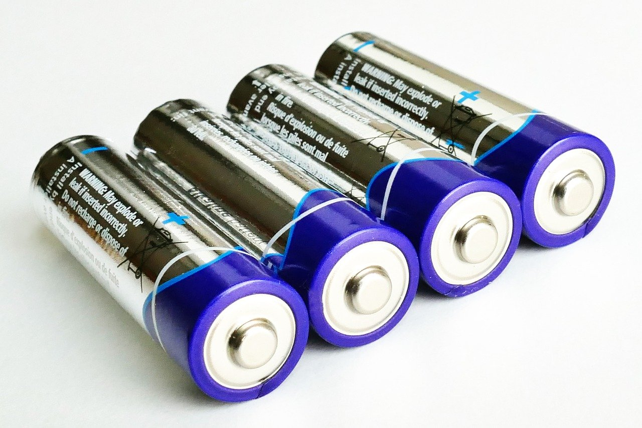

Can a battery "have amps"? We can correctly say the capacity in ampere-hours or the maximum current that an alkaline battery can generate, this current depends on its internal resistance. The internal resistance of a cell will depend on the type of cell and the degree of discharge and temperature. For a fresh R6 zinc carbon cell, the internal resistance will be greater (i.e. maximum current lower) than for an LR6 alkaline cell (approximately 0.2?-0.3? ;) . A fresh L91 / FR6 lithium cell will have lower resistance (approximately 0.1?-0.2? ;) than the alkaline cell. An additional feature of FR6 cells is their lower mass than LR6 and longer storage period without loss of properties.
From practice I will add that the useful instantaneous current of an LR6 (AA) alkaline cell with a voltage drop to about 1V can be as high as 2A-4A. For an AAA alkaline cell, it will be 1-1.5A for the same conditions.
An important parameter of galvanic cells is the capacity expressed in Ah (or Wh), the capacity depends on how long we will be able to draw current from the cell with a certain intensity. How do you imagine what an ampere hour is?
The capacity of AA cells can reach:
-R6 1Ah,
-LR6: 2Ah,
-FR6: 3Ah.
