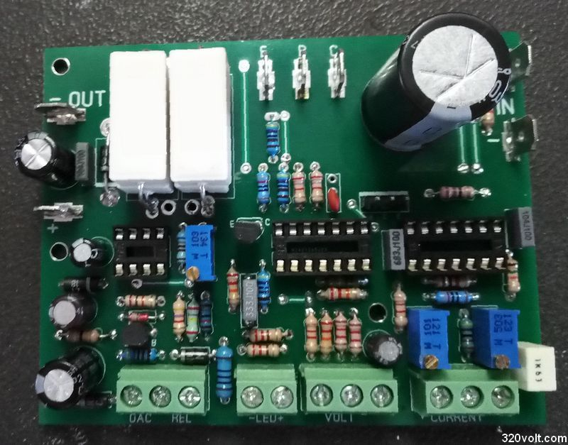

  • A 0-30V, 0-10A laboratory power supply uses a Velleman K7200 new printed circuit board control card.
  • The design includes Sprint Layout PCB drawings, Gerber files, and a single-layer PCB sized 91.6X72.2mm.
  • It offers continuously adjustable output voltage from 0 to 30V and current limiting from 0 to 10A.
  • The supply works fine, with 8A continuous output, 10A peak, 0.5mVsk ripple, LED current-limit signaling, and short-circuit protection.
Tried the 0-30v 0-10a power supply circuit works fine, sprint layout drawings on PCB and gerber files. velleman k7200 new printed circuit board control card Single layer PCB 91.6X72.2mm
This laboratory power supply will undoubtedly be a valuable device for both a professional electronics engineer and an amateur.

Since the "laboratory power supply" should (?) Have a housing, current and voltage meters? As it stands it is just an idea for a power supply. In addition, I miss the oscillograms of the output voltage... [Read more]
Anonymous 18 Aug 2020 19:16
Plusik for originality and complete documentation. The housing depends on the transformer and heat sink you have. I do not believe in the 0.5mV ripple at the output. [Read more]

Stabilizer 723 does not cause problems? The system is resistant to voltage applied to the output? This happens, for example, when a battery is connected to the switched off power supply. [Read more]

The filtration in the power supply is very poor, the 10mF capacitor will not live for too long, because you exceed its operating current (it will simply boil). [Read more]
Freddy 02 Sep 2020 07:04
Where do you see a 10mF capacitor because I can't find it? [Read more]
CodeBoy 02 Sep 2020 08:28
In the video 0:41 the question is whether only for testing or ultimately. [Read more]
Anonymous 02 Sep 2020 08:44
C11 and C12 in the diagram, on pcb you can see in # 11 that he has a lot of space for them. Let's face it, if someone actually uses a solid hit and will constantly charge 5A or more, it needs to... [Read more]
Freddy 02 Sep 2020 12:04
Well, it's 2x4700uF, not a 10mF capacitor, and that's the difference. I am curious about the justification of this current of work. Are you not exaggerating with these capacities? [Read more]
398216 Usunięty 02 Sep 2020 13:40
I must admit that I would also like to learn something new ... How would the operation with 100Hz supercharging "boil" a capacitor? I would not like to be smart, but does it not depend (probably about... [Read more]
worlinx 04 Sep 2020 12:37
As for me: 1. 2x15v on a hit is not enough for a 0-30v 10A power supply 2. 2x4m7 in filtration - too little, but see point one 3. it is not feasible to achieve the range of 0V and 0mA without supporting... [Read more]
