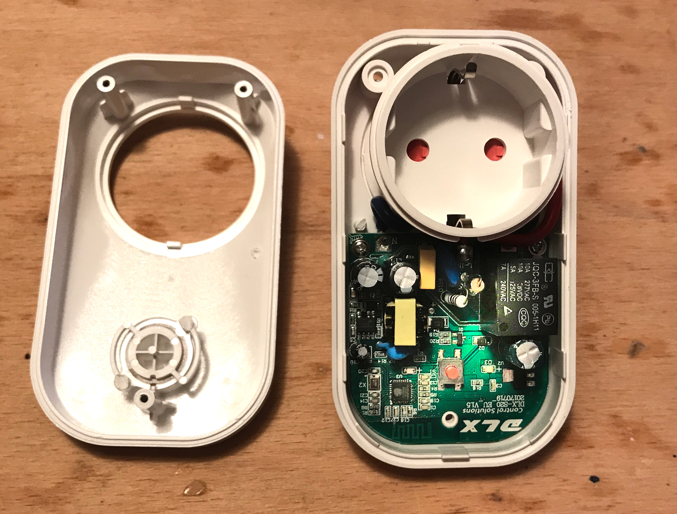

Interior of the PS-16-M .
The case is held on by three black screws:
Once opened, we are shown one larger board on which both the microcontroller, relay and small power supply are located:
Whole in operation without top cover:
Under the yellow capacitor you can see the rectifier bridge and a little further on is the pulse power supply circuit in flyback topology realised on a PN8366 and a small transformer.
The PN8366 is a so-called 'Ultra-low standby power quasi-resonant primary-side feedback AC-DC converters' made by Chipown. It has a distinctive pin arrangement (one is missing):
There is an example diagram of its application in the catalogue note (presumably this is what the power supply section of the board in question looks like):
In this circuit, the transistor from the inverter is already built in and no external one is needed.
Its catalogue note:
PN8366-Ch..wn.pdf (384.96 kB)You must be logged in to download this attachment. .
A little further down you can see the LDO CJT1117B 3.3 regulator:
Catalogue note for this LDO:
Changjiang...C78777.pdf (2.05 MB)You must be logged in to download this attachment. .
It provides a stable 3.3V for the chip's main controller.
The main controller is the 32-bit ESP8285:
ESP8285 datasheet note:
0a-esp8285...eet_en.pdf (873.69 kB)You must be logged in to download this attachment. .
Next to the ESP you can see the distinctive 26MHz quartz clock and the antenna from WiFi realised on the PCB:
The ESP8285 is not here as an external module; it is soldered to the main (only) controller board. Its housing is a QFN-32:
Internal schematic of the ESP8285:
There is no other microcontroller on the board - ESP takes care of everything.
A little further down you can see the transistor, signed Q1 on the board, which is used to control the relay:
And the relay itself (JQc-3FB-S 005-1H11):
From the underside of the PCB we have just one small bonus - the RX/TX connector, probably useful for a standalone firwmare upgrade:
It's also worth noting that the relay only disconnects the phase wire (assuming you haven't connected the socket in reverse). In the photo below you can see the wire markings, to the board goes N (Neutral) and L_OUT (Live output) and L_IN (Input Live):
The earth is not connected to the circuit at all (it is just passed through to the other side).
