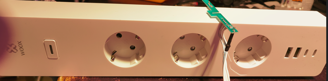

    Well, usually, I am okay with just configuring the device, preferably without cracking the case. However, Once I finished configuring the relays, I noticed it should come with a power meter. And that means looking for the chip that does the monitoring thing.

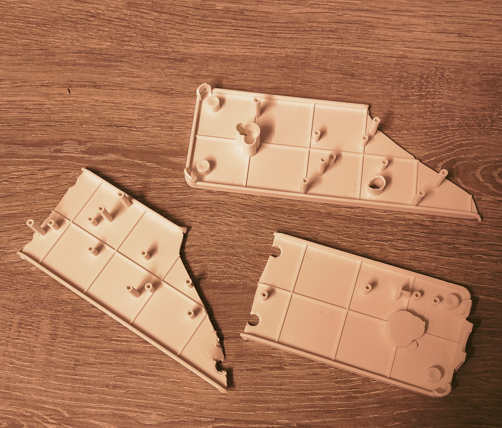

    In this case, the screw heads were flattened, and there was no way for me to open the casing. So, I sacrificed one unit.
    bottom plate ;(
    Three pieces of white plastic casing on a wooden table.

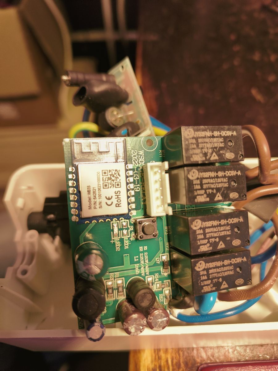

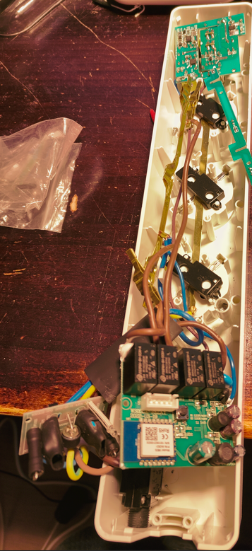

    After opening the unit, the inside looks like this.
    Interior of a disassembled Woox R6132 power socket.
    Main circuit
    Inside of the socket with circuit board and relays.
    So, the technical details:
    The unit comes with a WB3S (https://developer.tuya.com/en/docs/iot/wb3s-module-datasheet?id=K9dx20n6hz5n4) labeled board soldered on the main circuit board. Our trustful BK7231T module is doing its job.
    The WB3S controls the four relays, the power meter circuit (BL0937), and mine ran Tuya v1.3.5.
    Getting it into recovery mode is straightforward. Power it on. Push the button until the led starts blinking slowly. Release the bottom and press it again until it goes off. Bang. You're in recovery mode.
    Run cloudcutter and flash it with BK7231t 1.3.5 firmware cutter and flash it the flavor of your choice.

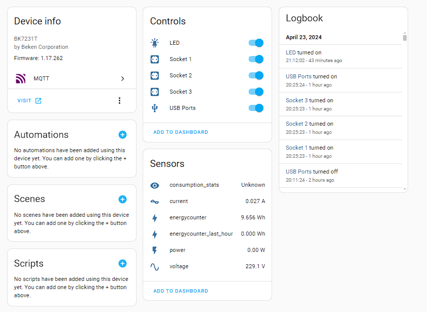

    Here is the template:
    Once you have applied it, please remember to calibrate the power using a 60-watt light bulb and a multimeter.
    PowerSet 60 (for the wattage of the bulb)
    VoltageSet 231 (set your voltage from the multimeter)
    CurretSet 0.261 (calculated 1000*(60/231)
    Configure HomeAssistant, and it will nicely show up
    Control panel and log of Woox R6132 socket
    I played around with it, and it works like a charm.
