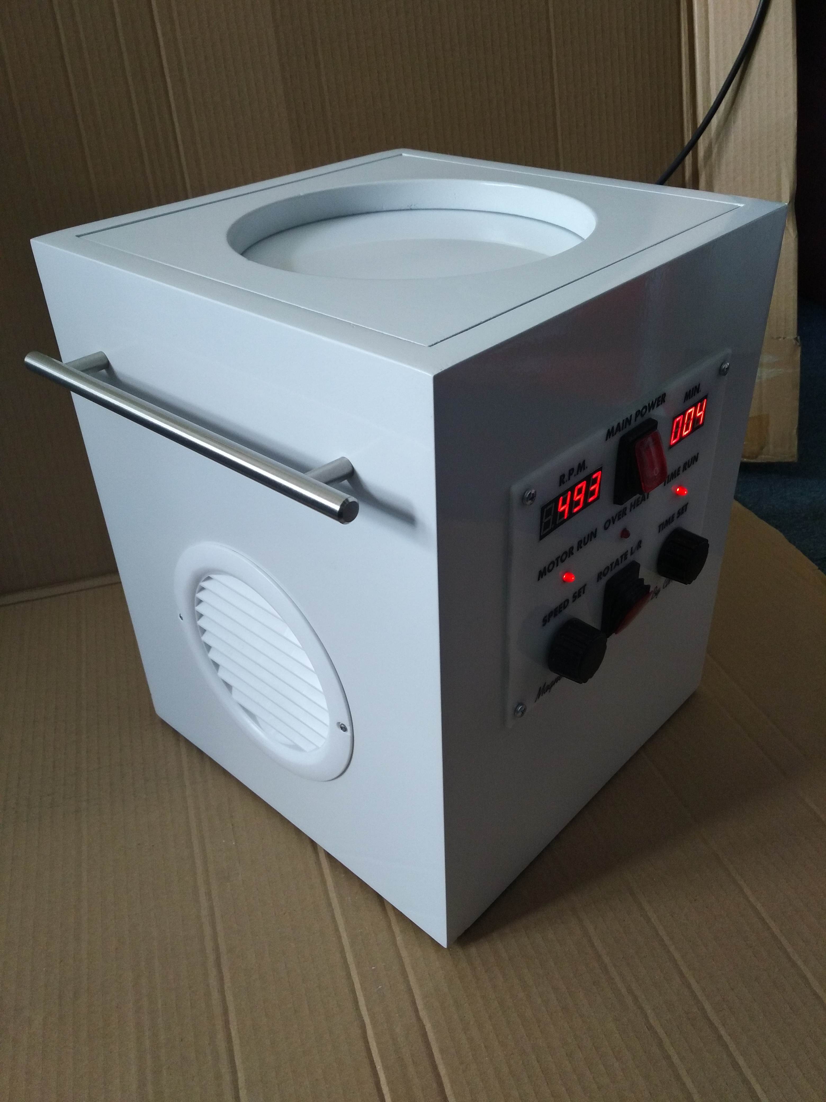

DIY magnetic jewelry polisher in a rectangular case with a handle and ventilation opening.
Front panel of a handmade magnetic polisher with red display and buttons.
Homemade magnetic polisher with a visible control panel.
A DIY magnetic polisher with control panels on a cardboard background.
The final result.
As I mentioned, I will not describe the vicissitudes of the entire construction, because it would take as long as the construction itself. You have pictures to see and read, a few sentences of text.
Maybe I will mention the security features.
If the motor housing exceeds 50 ° C (which did not happen during the tests), the fans will start.
If for some reason (despite the fans running) the motor reaches 85 °, the power to the inverter will be disconnected (the fans will, of course, remain powered).
And there is also an ordinary 20mm glass fuse.
At this point, I would like to thank my colleague BESTLER for this
