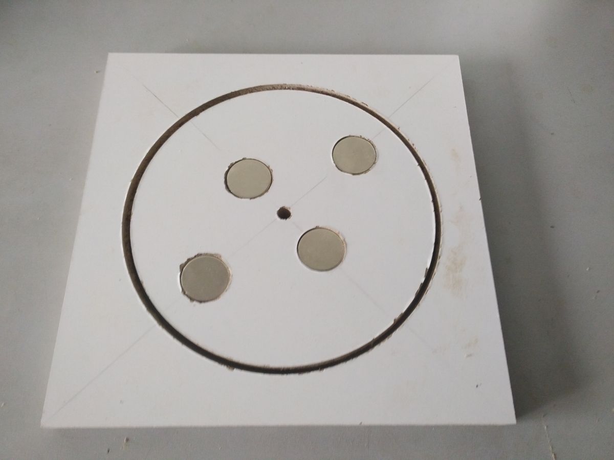

    The general principle of operation is simple. We have a spinning "plate" on which four strong neodymium magnets are mounted. Two of them are placed close to the outer edge of the plate and directed upwards with the N pole, and the other two are close to the center of the plate and directed upwards with the S pole. This creates a kind of rotating magnetic field wave which alternately attracts and repels the material . And the material is needles ... But more on that later.

    View of the rotating plate with four mounted neodymium magnets.
    It was the plate.

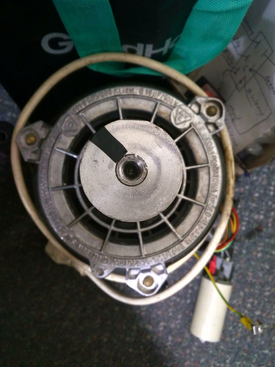

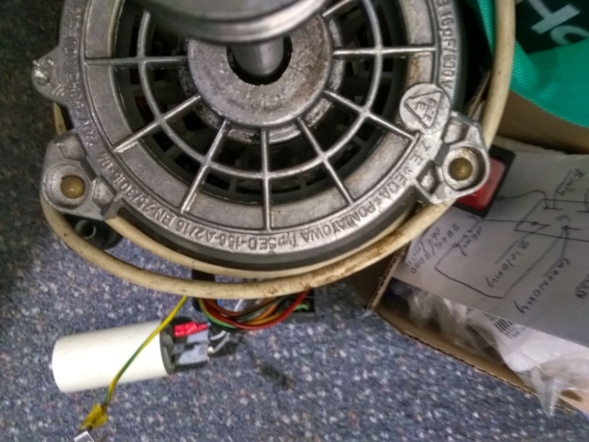

    Here is the engine that turned out to be a total failure and had to be reworked to 3-F. For this I am proud of the thread in the shaft. As I couldn't pull off the pulley in any way, I drilled and threaded the motor shaft. Not having taps for blind threads.

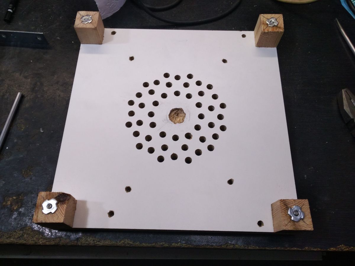

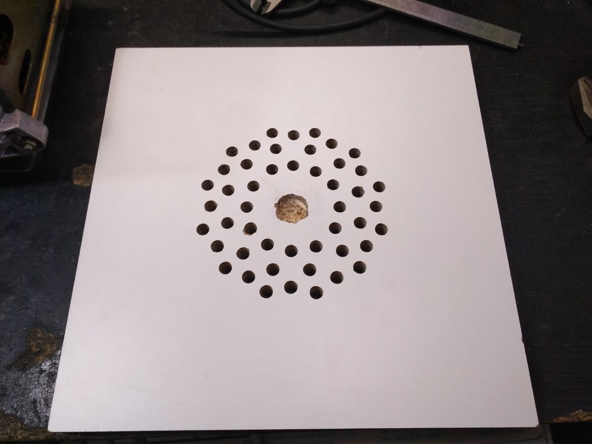

    Square panel with small holes arranged around a larger central hole.
    Square panel with circular arrangement of holes.
    Base of the housing with holes and wooden mounts for a magnetic polisher.
    Bottom housing construction with ventilation holes.

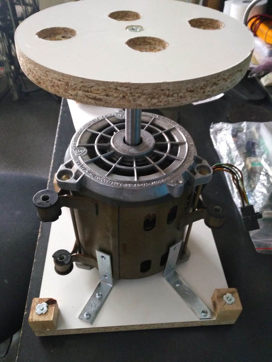

    Bottom of the housing and engine mount.
    Interior of the enclosure with a visible motor and electrical wires.
    Motor of a magnetic polisher mounted on a workbench.
    Close-up of a partially assembled magnetic polisher on a workshop table.
    Motor with mounted disc featuring mounting holes on a base.
    And here is the engine itself with a plate.

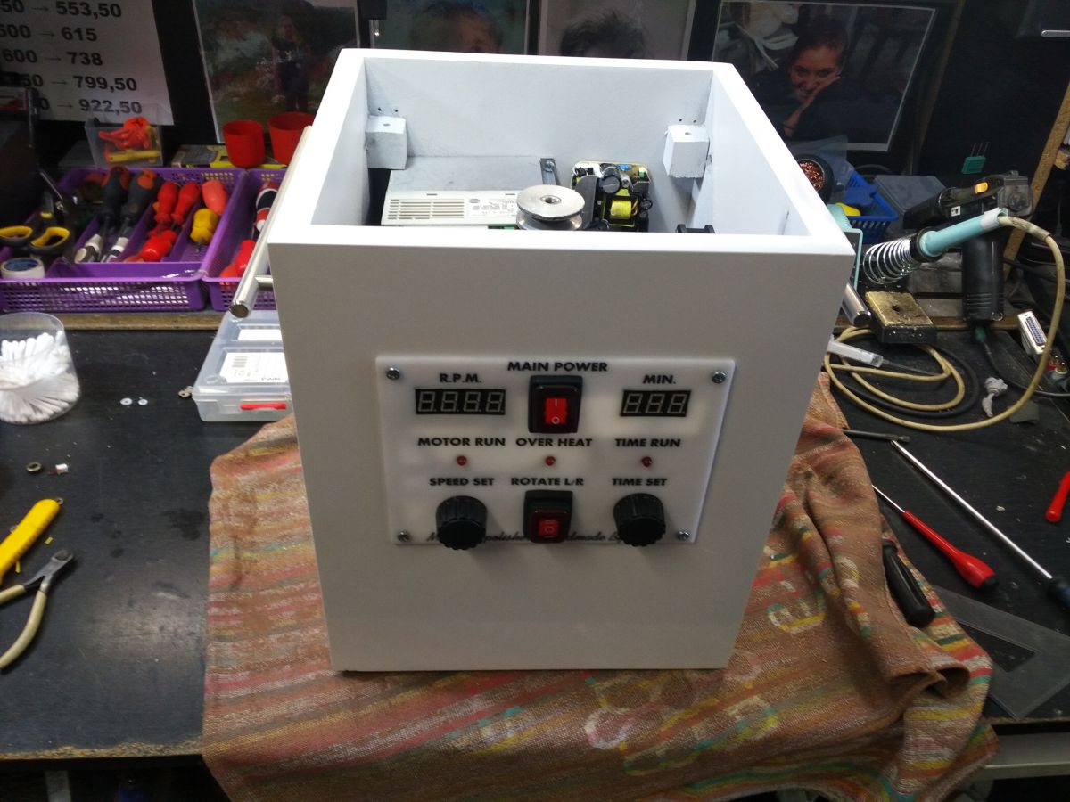

    This is what it looks like inside.
    Control panel of a handmade magnetic polisher.
    Control panel of DIY magnetic polisher.
    DIY magnetic polisher on a workbench.

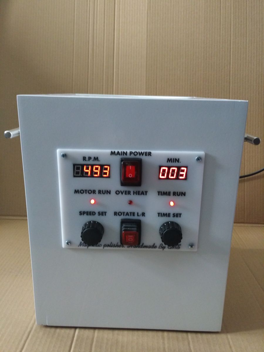

    Homemade magnetic polisher with a control panel displaying RPM and runtime.
    And so from the outside.

    The final result.
    As I mentioned, I will not describe the vicissitudes of the entire construction, because it would take as long as the construction itself. You have pictures to see and read, a few sentences of text.
    Maybe I will mention the security features.
    If the motor housing exceeds 50 ° C (which did not happen during the tests), the fans will start.
    If for some reason (despite the fans running) the motor reaches 85 °, the power to the inverter will be disconnected (the fans will, of course, remain powered).
    And there is also an ordinary 20mm glass fuse.

    However, you did not take good advice. Rewinding the washing machine motor to three-phase in order to push it with an inverter - nonsense, technical and economic. For the cost of rewinding, you would have 2 used 0.18kW three-phase motors and there would be more for the turner to remake the axle. A better solution - commutator motor, speed easily regulated by voltage. Using the motor from the washing machine, with tacho feedback, you would have almost 100% torque throughout the speed range. The whole thing would be much smaller and lighter. And definitely 3 times cheaper.

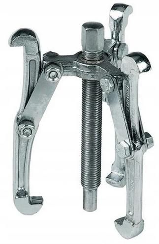

    CMS , you write that there was a problem with removing the pulley.
    Have you tried to use something like this (called bearing puller ):
    Three-arm bearing puller
    (I don't know - maybe you know it and it didn't help, or maybe - it will be useful to someone else?)
    greetings
    - MaciekM

    One more very important thing. The disc with magnets sticks to the motor axis on the screw - with a right-hand thread. When switching to "left" it will unscrew ...
    Marcin, you had to heat this circle. Overall, the structure is interesting and quite unusual.
    I listened to the advice and took it to heart. I will certainly use them in future constructions.
    Here, however, the replacement of the engine at the stage when it became apparent that it was not suitable was too late. It was more profitable to pay PLN 300 for rewinding than to fit the existing structure to another engine.
    Would it be 3 times cheaper, I dare to doubt. The engine cost a hundred, winding 300. How much would I save on another engine, and how much time would I waste to fit. If I had consulted with you earlier, when we were not at an advanced stage yet, we would probably have used a different engine and would have built the rest for it, but I wouldn't have saved a lot either.
    Matheu wrote:
    Maybe you tried to use something like this (known as a bearing puller):
    I tried to remove the pulley, exactly with the puller as shown.
    I thought about it. Between the disc and the pulley, there is a silicone washer of the pulley diameter. After 6 hours of testing, nothing loosened. And as if you can always drip blue thread glue.

    I was heating, but the main problem was that the shaft was immobilized so that it would not spin when I pressed against the puller.
    As for the motor, it was a coincidence that we owned one, and it was also coincidence that it operated with an inverter. Only during the final tests, when the machine was about to go to the customer, it turned out that it works, but not for more than a few minutes, and then the inverter crashes. The engine turned out to be damaged, and since everything was already built to the size of this particular engine, it was more profitable to spend 300 than to convert the entire structure to another engine.
    So let's finish the engine topic. I know that there are better solutions and I will use them in the future.
    However, there is a plus in using this engine - I gained a lot of useful knowledge ... For example, that such an engine is not suitable for such an application :) . I learned how to configure inverters and that the instructions from them are written in such a way as not to make it easier to use, and certainly not to someone who has to deal with it for the first time.
    I also learned (experimentally) that the French engine cannot be connected via autotrafo, i.e. it can be connected, but I do not recommend switching it on.

    CMS wrote:
    Would it be 3 times cheaper, I dare to doubt. The engine cost a hundred, winding 300. Well, how much would I save on another engine,
    So a total of 400, - These motors from washing machines in scrap yards are going to get for 20 PLN for 30 PLN. New Besel engine 0.18kW - PLN 200- 300. So you already have half. Used 0.18kW motor - from a gear motor or fan below PLN 100 - that is 1/4 of your price. Commutator motor - used around PLN 50. Phase regulator on the triac - let's say another PLN 50. With the efficiency of the magnetic coupling below 20%, even no speed stabilization would be needed, the motor would roughly have the speed directly dependent on the voltage.
    On the commutator motor from the washing machine and the phase regulator, I made a drive for the honey centrifuge. With heavy, full frames, it spins slowly, it accelerates as the mass of them loses - which is even beneficial for throwing out the remains "to the bottom".

    robokop wrote:
    We wrote simultaneously.
    Now I understood that these 3 times cheaper was for the engine itself. I understood that you are talking about the whole.
    At the cost of the whole, these PLN 300 was a fraction.
    I wrote about the whole. A commutator motor would be cheaper - an expensive inverter would also fall off. So probably a thousand less together. For a hundred you would have a motor with a phase regulator.

    The inverter was a lucky, because 86pln was a lucky (here a separate story)

    In such polishers, the plate with magnets should be well balanced so that the machine does not behave like a block shaker. Have you had trouble balancing your shield?
  • #23 18931499
    PPK
    Level 30  
    Posts: 1957
    Help: 94
    Rate: 428
    A long time ago, a friend was doing such a polishing machine for a guest from Gdańsk, but without the rotating parts. Instead of rotating magnets (there were no neodymium ones yet), he installed TTL-controlled electromagnets, probably 74154 and transistors as drivers. Generator for 555 (with adjustable fill) and some series / BCD. There was a problem with induced voltage but it handled it with separate power supply and chokes ...... I am so in awe of your workshop work. I have always had problems with the housings ..... :)
  • #24 18932884
    CMS
    Posts: 8468
    Help: 258
    Rate: 2601
    Buddy andrzejlisek, create your own topic, because your discussions have nothing to do with the polisher.
    Added after 5 [minutes]:
    The plate itself is well balanced. Without load, the polisher does not vibrate and is almost silent.
    On the other hand, placing a vessel with needles and the processed material makes the whole thing vibrate together with the table on which it stands. The needles also make a lot of noise. But the client said it was normal.
    Basically, it can only be balanced roughly - the engine does not reach the nominal speed, but much lower - otherwise, once the rubbing needles would generate a lot of heat, the centrifugal force would lead them against the walls of the box, instead of the entire volume.
  • #27 18948074
    CMS
    Posts: 8468
    Help: 258
    Rate: 2601
    Rob, I limited the speed (in the inverter settings) to a maximum of 2400rpm, because at the nominal 3400rpm, while the plate itself caused a slight brumm (but not vibrations, only audible), with the needles on board there was such a forage harvester that the microwave was standing on the same (the metal table) as the polisher wanted to jump off it.
    Only then did I find out that the needles are flooded with water with dishwashing liquid, which significantly reduces vibrations and heating the whole thing).
    robokop wrote:
    otherwise the rubbing needles would generate a lot of heat,
    Not that much, as I found out experimentally when, not knowing yet that water was pouring there, I polished a few elements for 6 hours. They were warm, but not above 40 ° C.

    anski
    Posts: 18
    Cool design, only these inscriptions. Can't you speak Polish?

    CMS wrote:
    Tomek515 wrote:
    A foreigner ordered it from you
    Yes.
    More precisely, one of the contracting authorities is not a Pole.
    However, the subtitles are in English because they are shorter and it was easier to fit.
