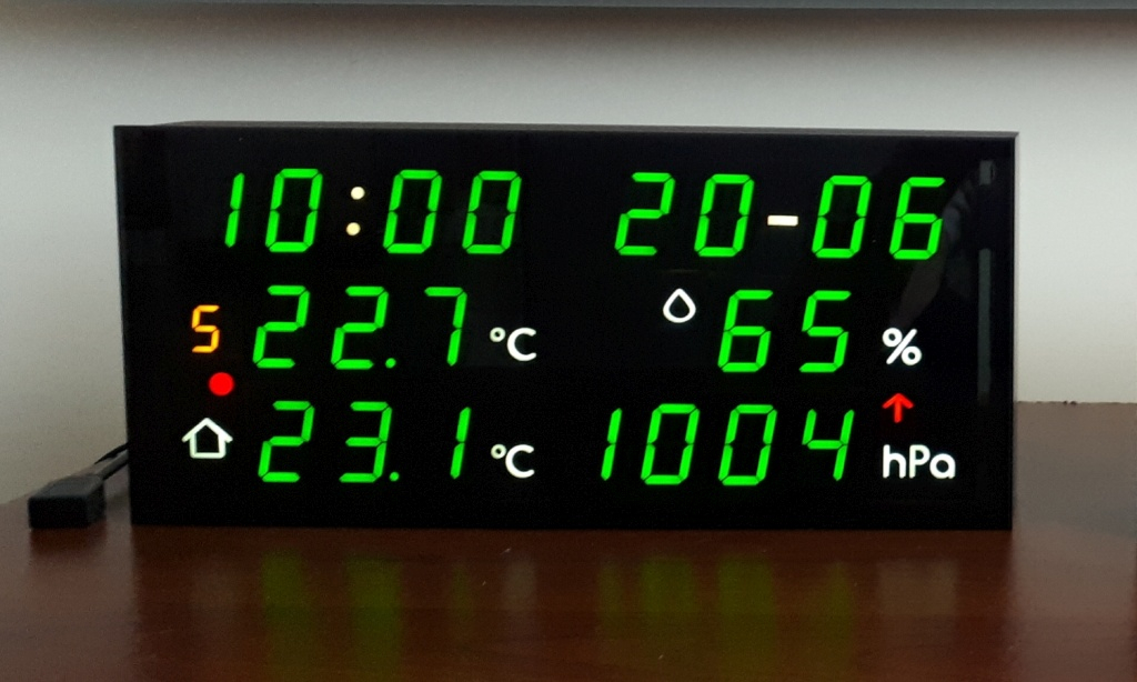

  • Built an LED weather station with seven-segment displays, NTP clock/calendar, and support for up to 9 temperature/humidity modules.
  • ESP-Now links the ESP12 sensor modules to an ESP8266 receiver, while an Atmega64 drives the LEDs, trends, alarms, and station web pages.
  • A 2000 mAh 18650 battery powers a sensor module for about 6 to 7 months when it sends measurements every minute.
  • The 27.5 x 12.5 cm front panel shows time, date, module temperatures, home temperature, humidity, pressure, trend arrows, and alarm icons.
  • RC5 and RC6 remotes are not suitable, and subzero temperatures shorten battery life.
The title picture is probably a bit familiar from my previous topic about pictograms.
Today the device is ready. Generally available weather stations have one thing in common - the LCD display. It has its advantages and disadvantages. When it comes to the readability of these panels, it is different. So I decided to build a station using seven-segment LED displays. The height of the figures in the design is 2.5 cm. Visibility is excellent from a distance of several meters in the dark as well as in bright rooms and at large viewing angles.
The front dimensions of the device are 27.5 x 12.5 cm.
The panel displays the current time, day of the month, month, temperatures from modules 2 to 9, "home" temperature, humidity, atmospheric pressure, temperature and pressure trend arrows. As well as alarm icons - lack of communication with the module, low battery status of the module and others.
I made several such stations in different versions, for family and friends. Also versions without clock and calendar. Pictures below.
The device is fully configurable. You can set the number of sensors, the action of measurement tendency arrows, panel brightness, time of automatic switching of measurements, etc.

As the LED displays glow quite strongly in the dark, I used brightness adjustment depending on the ambient light. This adjustment is configurable according to your preferences. Two brightness points are set. Contractual minimum and maximum. Display brightness is set to minimum in low ambient light. Similarly, in bright light, the maximum brightness is set. The device remembers the brightness of the environment and the level of illumination of the display. The entire range of brightness changes in 30 levels. The brightness of the display changes exponentially. To the eye, such changes are more linear.
The station is powered by a 12V 1.5A plug power supply. Power consumption depends on the brightness of the display and ranges from 1 to 5W.

The station housing is made of 6mm MDF board with tinted glass on the front. Black Antisol, 6mm thick. MDF is covered with a black matt veneer. The rear wall is cut from black polystyrene with a thickness of 1mm.

The software is written in the Arduino Ide environment and is a set of codes available on the Internet and own. I am not a professional programmer, so I am asking for the understanding of the professionals, but I would love to hear your comments about the sources.
Pictures do not reflect the actual appearance. It is difficult to photograph glowing LEDs.
And that's it, in a nutshell :)

And! 21 Feb 2021 17:06
The case made of veneered MDF turned out very well, maybe you can write something more about processing and preparation? [Read more]
