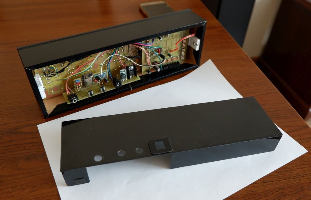

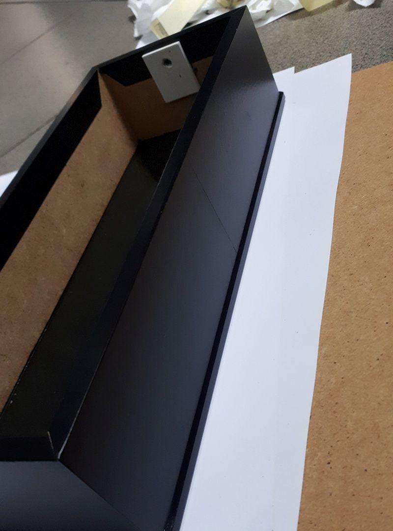

    The station housing is made of 6mm MDF board with tinted glass on the front. Black Antisol, 6mm thick. MDF is covered with a black matt veneer. The rear wall is cut from black polystyrene with a thickness of 1mm.

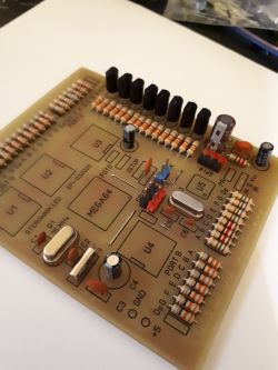

    Atmega64 deals with displaying data on LED displays, calculating the trend of measurement data, enabling alarms, etc. The IR receiver is connected to the Atmega8, which sends processed data from the remote control to Atmega64 via 4 data lines.

    The display board. One-sided. Unfortunately, you need to do about 150 guides on it.
    LED weather station with NTP clock and calendar
    Atmega64 board and drivers

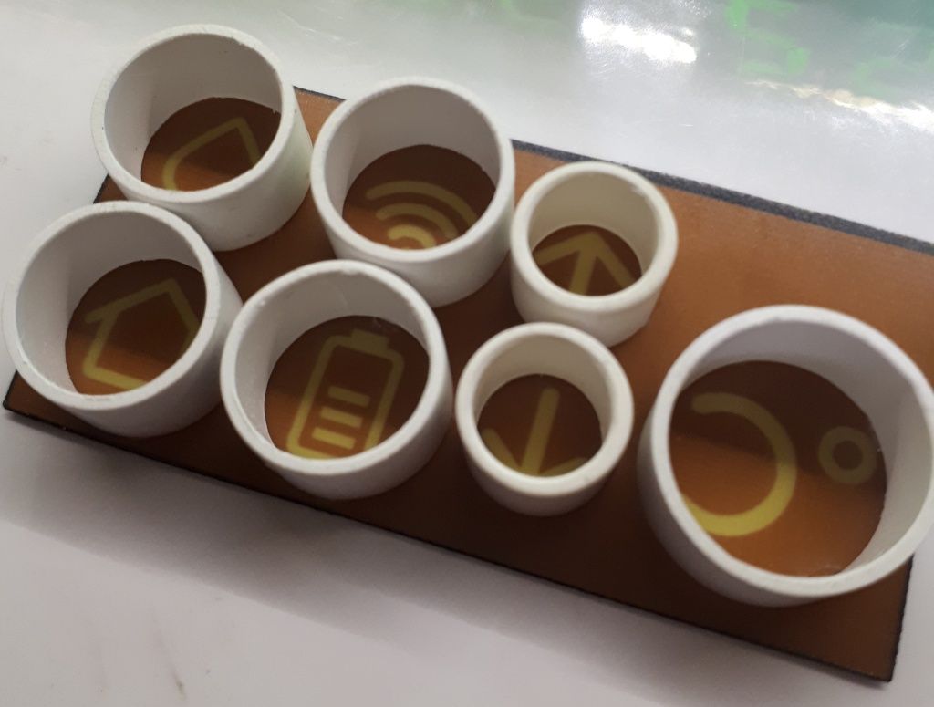

    pictogram covers

    general view of the station

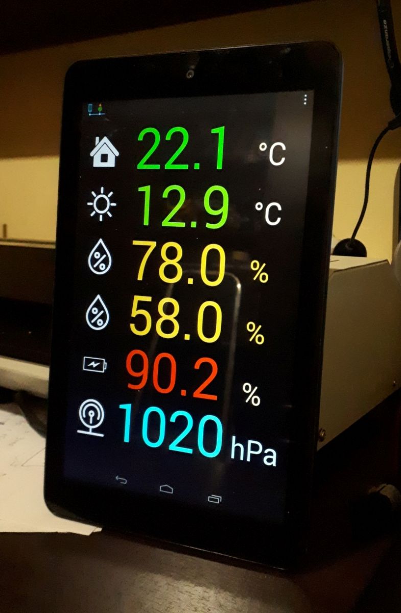

    Well done. In the bedroom, I had a reading of internal and internal temperature and pressure. The system is based on the HD44780 display. It worked for many years, but the aesthetics of this solution was poor. I have already bought a larger TFT display to build a new chip - data was to be downloaded from the server via esp8266. I wanted a large size so that readability would be good at a distance. Ultimately, however, I did it differently - I took an old tablet from my son, which had a lockable cover. I removed the material so that only the plastic frame remained. From the back, I attached a piece of wood with a heat-glue as a leg that also provides the right angle of inclination. Of course, the frame includes a tablet that is permanently connected to the power supply. For aesthetics, the micro USB plug is angled. Now it's time for software - there is no philosophy here - it's just a website. Use the property of Chrome for Android - the ability to pin a page to the home screen. This is very important as there is no address bar after launch. Here is the result (screen content):
    The image is dim because the astronomical clock has detected the night. On the website I present the date, time, Google RSS, weather forecast and of course the outside and bedroom temperature, plus additional information about the alarm.
    Dimming is a big problem (the tablet didn't have one). The astronomical clock solves the problem to a large extent.

    I also used to "play" with an old tablet, but in combination with Virtuino. However, this program is only for Android. In the code of the published station, you can add the Virtuino library and send data to a tablet or phone. I made such attempts. However, the web browser is cross-platform.
    Such attempts ...
    When I started to play with electronics, you could only dream about LCD displays. But I have a great fondness for seven-segment displays and I just like their lighting :) .

    I do not have too many photos of gluing the housing, but there is some outline.
    Description of gluing the housing with MDF.
    There is no great philosophy here. After cutting the elements, I glue them together and press them until they dry or the glue is stably caught.
    After the glue is completely cured, I sand it with a 180 gram paper and then ground it with nitro Kapon varnish. After the varnish has dried, I sand it again and I no longer ground it. The frame glued in this way is quite delicate. It will gain stiffness after sticking the windshield.

    I cut the tape with a knife as shown in the picture. The remaining paper tape should not go under the frame.
    I cover the frame with painter's tape as shown in the picture and put black silicone on it. It should be spread not too thick over the entire mdf surface. But no fear. Anyway, the excess will go beyond the outline of the frame when pressed against the glass.
    I put the frame to the glass and remove the excess silicone.
    Inside, it can be done with a wooden stick.
    Remove the remaining silicone with a paper towel and denatured alcohol or spirit :) . Inside, sticks with cotton balls are also useful.
    Caution!. The frame is a bit unstable in the plane on fresh silicone. Leave everything to dry, preferably with the glass facing down.

    I made several such stations in different versions, for family and friends. Also versions without clock and calendar.
    Why, if you were doing a few, did you not take advantage of the option of ordering a double-sided plate from JLC or a similar tiling company?
    It was the possibility of making a double-sided plate with metallized holes, something inaccessible at home, that pushed my design tests to a much higher level.

    Well . There was such an idea, but I was looking at Polish companies for the production of PCBs and unfortunately the price was not attractive. For a single-sided 25 x 11cm display plate, there was probably something like 60 PLN per piece, with a few pieces. I will not mention two-sided. It's not cheap. Besides, in the past, you had to combine everything for the construction yourself, and it probably stayed that way :) . But maybe one day you will have to try it for the first time and order it from a professional company.
