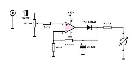

Recently, I got my hands on two dial indicators. I used two such systems to drive these indicators based on the LM358 integrated circuit. I made the pcb project in TraxMaker. The whole thing is placed in a plastic housing.

Housing not too nice - good for some workshop power supply, not for an audio set element; the wires inside are routed sloppy, but the biggest error is the visible diodes illuminating the scales of the... [Read more]

There are numbers on the scale of the indicators, what do they mean? And how does the electronic circuit convert the input signal into a signal that drives the indicators of the appropriate value? [Read more]

Overall a plus for wanting to :) As for the performance, there are a few mistakes, first, as already written, the LEDs are terribly tiring at the front, they should be covered from the front. If you have... [Read more]

Because that's where the logarithmic amplifier should work ... https://obrazki.elektroda.pl/2526971600_1617560531_bigthumb.jpg https://obrazki.elektroda.pl/4712490200_1617560592_bigthumb.... [Read more]
Anonymous 04 Apr 2021 20:46
It is correct. In the diagram from the title project, the opamp is in a non-inverting configuration and the D1 diode causes that for small signals the amp works as a comparator, and for larger signals... [Read more]
398216 Usunięty 04 Apr 2021 21:04
They should not be on the front of the indicator at all. The indicator housing is specially adapted to be illuminated from the back - in the original, it is an all-glass bulb without a socket. This is... [Read more]
Gizmoń 04 Apr 2021 21:19
You had to make full use of one LM358 chip instead of two, only half of each. How can amplifiers be wasted like this? :D Everything would then fit nicely on one PCB. If any amps are already left unused,... [Read more]

Such an indicator does nothing. It works 0-1. Let this maximum scale be practically unattainable. If you heal it a little, it will be cool. [Read more]

I had such a problem with the LED backlight for the bulb, I used a piece of silver; a half cylinder placed on the diode and a flat piece at an angle of 45 degrees from the face where the most light. [Read more]
elektronik.b 05 Apr 2021 12:52
Welcome back. Thanks for such comprehensive answers. 1. As for the leds illuminating the scale (why didn't I hide them?), I just wanted to use them as a bedside lamp, because I often listen to music... [Read more]
