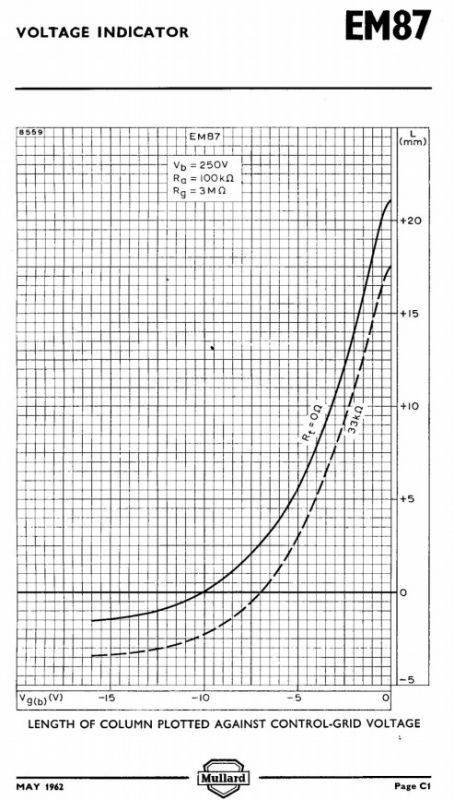

    The visual effect is interesting - I mean "snapping" the straps. For those who don't want to play with high voltages, something like this could be simulated on an OLED display.

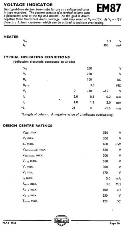

    The stripes can overlap and then shine very brightly, even in DS this is written as an overload function.

    The lamp itself has little power needs, the vast majority is absorbed by the 30V stabilizer.
