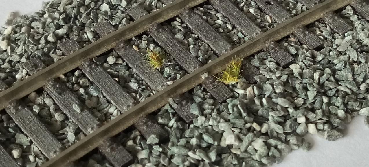

  • A DIY electrostatic grass planter, also usable as an upholstery flocking machine, creates miniature H0-scale garden terrain.
  • A NE555 oscillator drives a BD135 transistor and salvaged HP printer transformer, followed by full-wave rectification and a voltage-multiplier cascade.
  • The NE555 operates at about 12 kHz with a 60% duty cycle, while the transformer has a 3 Ω primary and 4 kΩ secondary.
  • At 12 V input, the unmultiplied rectified secondary output measured 1.4 kV; the final stage uses 6 kV/5 mA diodes, 3.3 nF/6 kV capacitors, and a 100 MΩ resistor.
It's full of grilling time, and since I don't have a plot, and somehow not so much on the balcony, I have come up with my own little garden, so I sometimes decrease to the H0 scale 87 times.
I present an electrostatic grass planter for mock-ups.
If you prefer - a flocking machine for car upholstery.
The generator is NE555, frequency around 12kHz, duty cycle 60%.
The WN trafko keying transistor - BD135, and the trafko comes from an HP printer (I don't remember the model, I think M15) Primary 3R secondary 4k.
At 12V power supply, on the secondary side (without a duplicator) after full-wave rectification and smoothing with a capacitor, Sonel CMM10 showed 1.4kV.
Next, a traditional duplicator on elements also removed from the printer.
Cascade of 6kV / 5mA diodes and 3.3nF / 6kV capacitors
At the end, a 100M resistor. Until you feel this wind of electrons :)
Tile - Thermal Transfer.
And these are the effects:

Justyniunia 21 Jun 2021 22:30
I suggest you read about the Flock technique. This weed is a textile shearing. It is applied by means of an electric field to a surface covered with an adhesive. The fibers are attracted and electrified,... [Read more]
