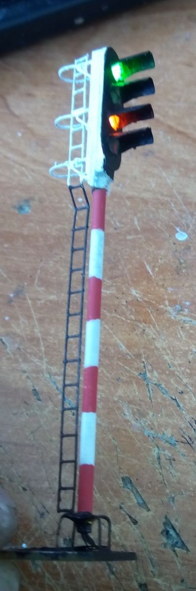

    You can choose from:
    Minikol - 3mm diodes stuck in a piece of metal plate
    Hulacki - 3mm LEDs stuck in a piece of plastic with a ladder
    Ostbahn - Signs for self-construction of a semaphore with SMD 0603 LEDs (about PLN 20, I buy these)
    Kluba - ready-made semaphores made of metal plates, the most realistic, but the price is> 100 PLN and the waiting time is several months.
    The order is not accidental.
    This is what the Ostbahn dwarf maneuvering disc looks like when folded.
    The price is PLN 8 and a half hour of fun.
    There is no better alternative in terms of price and quality.
    FLOCK, electric grass planter
