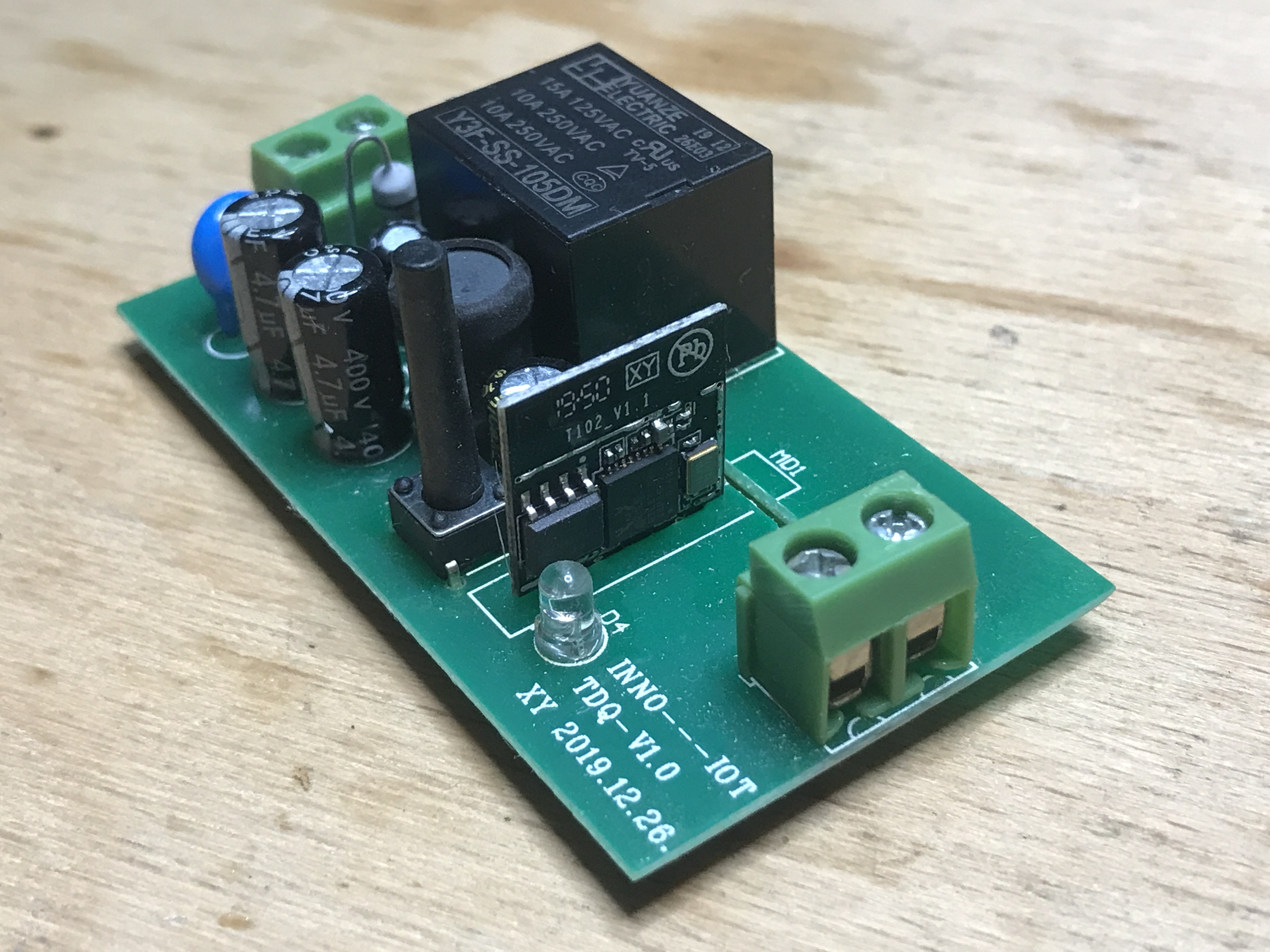

Interior
You can get inside by simply levering the casing:
The housing is so matched to the board that you do not need screws:
Plate:
Varistor protecting the system against overvoltage (07D471K):
A filter with two 4.7uF 400V capacitors and a choke (pi type filter), in the background a fuse resistor:
The bottom of the board, the whole system is transformerless powered by On-Bright OB2222MCP (OB2222) which gives about 5V at the output, for the 3.3V WiFi module it provides AMS1117 3.3:
Transistor J6 switching the relay on and the necessary diode parallel to the relay coil (so-called freewheeling diode):
Relay itself, Yuanze Electronic, Y3F-SS-105DM:
And most importantly - the WiFi module (it was already with the cover removed, sometimes I meet with something like that, e.g. in the case of two XR809 door sensors that I had, one was without a screen and the other with):
Unfortunately, ESP8266 is not here. There is a Realtek IC, RTL8710BN:

RTL8710BN comes with Flash on SPI (similar to ESP), let's take a closer look at how:
Boya Micro, 25Q16BSTIG as far as I can see, similar to 25Q16BVSIG (BY25Q16BS family).
NOR Flash memory with SPI interface, 16M BIT or 2MB.
T102_V1.1 module (such a different WR2?) From inside
I desoldered the WiFi module from the inside to be able to read the pin names.
Leads are signed. there is also a catalog note on the network under the entry T102_V1.1:
Its parameters:
Pinouts and roles of pins:
There are also UART pins:
In addition, I noticed that the Tuya, WR2 module (also implemented on RTL8710BN) is very similar to it:
Pin 29 in the photo is EN in the schematic and 30 is ADC.
The information about the 40MHz resonator is also correct, the module from the topic has it visible on the board:
Pinout WR2:
Additionally, the pinout is compatible with TYWE2S (which is already based on ESP):
and TYWE3S can already be bought sometimes (and there are different prices, the one in the screenshot is not very attractive, actually it is more than the cost of the entire relay):
There are some of these modules, so much good that they match as they come out.

I started the module on the contact plate. It does not require anything other than a power connection to start up:
In this configuration, the Tuya mobile application continues to work and allows you to control the module. I connected the LED to the pin that previously controlled the relay and the control also works.
I also checked the UART ports of the module:
Nothing is happening on the normal RX / TX pins. In contrast, the UART debug output sends some information with baud = 115200.

Diagram
Based on the photos and catalog notes of the elements, I have prepared a full diagram of this relay.
NOTE: The scheme uses markings such as on the board, in addition, the resistor values are in the SMD code (e.g. 152 means 1.5 k? ;) .
In a nutshell: we have a few simple protections (at least there is a fuse, etc.), then a transformerless power supply (buck) on OB2222 giving 5V, a 5V relay controlled by a transistor and a 3.3V LDO powering the WiFi module, button, diode and that's it.
You can see some differences from the scheme proposed in the catalog note OB2222. The manufacturer of the relay resigned from the rectifier bridge in favor of one diode, but added an additional filter (two electrolytic capacitors and a choke forming the PI filter).
The rest is in line with the note (R1 and R2 are the power supply for OB2222, together with the C2 electrolytic capacitor), RS1 (S in the name is from Current Sense) is a low resistance resistor, a shunt to control the inverter current, further downstream elements D3 and L2s are already characteristic of every buck converter.
General diagram of a buck converter:
(source: wikipedia, https://en.wikipedia.org/wiki/Buck_converter)
OB2222 obviously has the transistor integrated with the rest of the controller in its housing.
This additional D2 diode connected to the FB (Feedback) pin is a feedback for current control via OB2222.
OB2222 provides 5V which is used to turn on the relay and supplies the 3.3V LDO stabilizer AMS1117.
Only this 3.3V supplies the T102_V1.1 module with RTL8710.
Pin IO14 is connected to the transistor with the J6 code (I suspect it is S9014) through the R6 resistor limiting the base current and the R7 resistor acting as a pull down.
The IO0 pin is just for the LED (informs about the relay status and the pairing status).
Pin IO5 is a button with a pull up resistor R5 and surprisingly with a capacitor C8 which probably reduces the problem of contact vibration.
