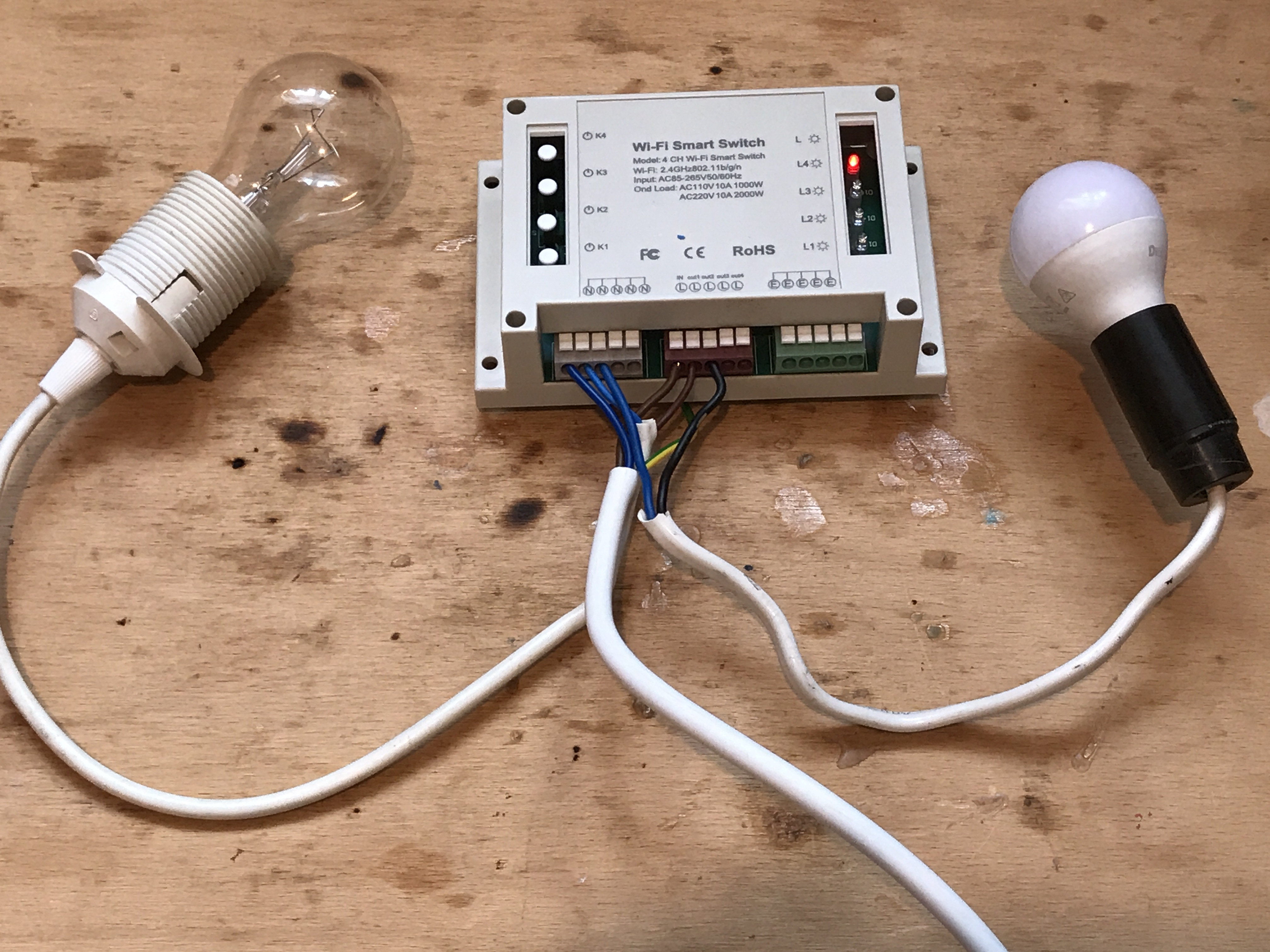

Hello, here I will sho the teardown, detailed photo documentation, PCB analysis and schematic drawing of another Tuya product. This time it will be a controller for 4 relays, pluggable into a DIN rail, controlled as usual via WiFi via a phone application.

Product purchase
I found the product by searching for "4CH 4Gang Wifi Light Smart Switch 4 Channels Circuit Breaker IOS Android Tuya App Control interruptor wifi 4 canales ios" for about PLN 60 (supposedly in promotion, normally for less than PLN 100). Below are screenshots of the offer:
Graphics from the seller:
Kit contents
The set includes only a relay and instructions (I censored the seller's sticker because there is no need to do unnecessary advertising):
Instruction (information on how to pair with mobile App, etc.):
Controller:
Terminals:
Mounting mechanism on DIN rail:
After removing the plugs, you can reveal the buttons and LEDs informing about the status of relays and the device:
I do not know who would like to have these buttons covered, after all, without them, if there is a problem with WiFi, there is no way to control the device.

Relays only cut off the phase wire. The groundplane connects the primary and secondary sides, you can see in the photo that the mass reaches up to the mass of the 400V 4.7uF filter capacitor, which is just behind the rectifier bridge.
