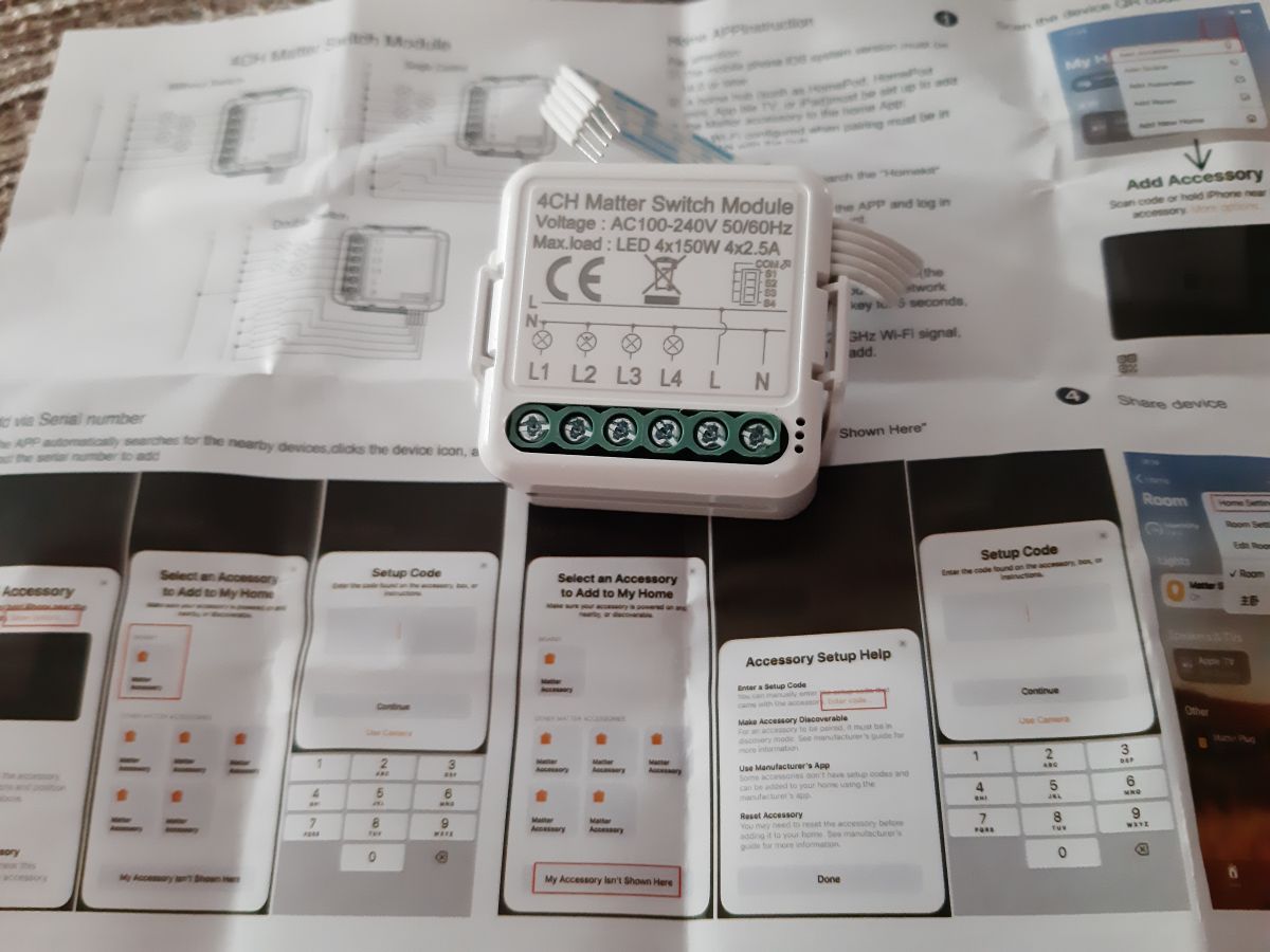

    Now, I found this "matter" 4-channel device
    Experience with IHOMECAM matter 4-Channel Smart Relay Using Tuya?
    running under the "brand" name IHOMECAM, and it does say that it is running Tuya. So I deciced to give it a try.
    While waiting for delivery, I want to use the waiting time to collect information about this device. Anyone yet had to deal with it?
    Moreover, I want to use it in a slightly different way than usual: I want to switch N (instead of L) to the four outputs. Anyone tried that before? Is it possible to simply connect L to where the connector says N, and N to where it says L? Getting the N line switched that way? Or will I have to separate the relay circuits on the board from the wired internal connection to L and connect it to N there?

  • BL2028N pinout and OpenBeken support confirmed
    #3 21206283
    io2345
    Posts: 273
    Rate: 7

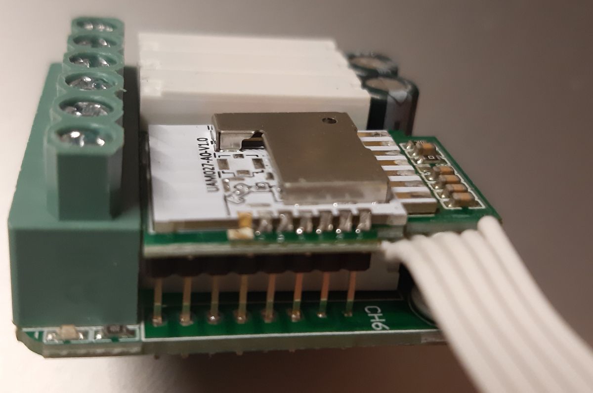

    It is more or less the same device that @ferbulous reported here under #11:
    https://www.elektroda.com/rtvforum/topic4058227.html#21126861
    The "smart device" has the same identifier than the one on his picture: UAM027-A0-V1.0
    @ferbulous, can you please tell me, which of the 5 pins that you connected for flashing has which function? Did you manage to flash it with OpenBeken?
    After knowing which Pin connects to where, it certainly would be clever to dump the original firmware first, right? Which tool to use for that and where to find it?
    And for flashing: Is there already a software that suits? Well, Ferbulous should be able to tell us that, too.

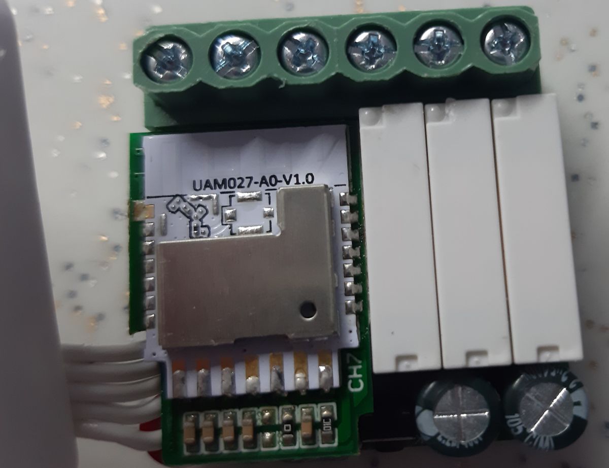

    Smart device UAM027-A0-V1.0 with five screw connectors and three large white buttons. Label on a 4CH Matter Switch Module with technical and contact information. Electronic device circuit board with visible components. Close-up of an electronic circuit marked UAM027-A0-V1.0 with cable connections. Smart switch module on top of a user manual
    Hinzugefügt nach 10 [Stunden] 36 [Minuten]:

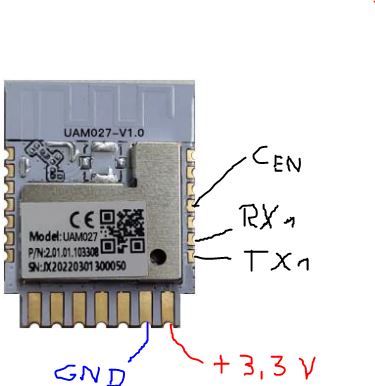

    Found the manual for UAM027 now, so no more doubts about the necessary connections: https://fccid.io/2A68EJX-UAM027/User-Manual/User-Manual-6761203.pdf
    Pins to connect should be then:
    UAM027 module with pin labels and identifier
    To tell from the manual, main Chipset is BEKEN :BL2028N
    Is this type of chip supported in OBK?
    Found it, obviously it is supported (maybe some late Beta, though): HowTo flash BK7231M/BL2028N mit 000000 Schlüsseln
  • No RF restore option after successful flash

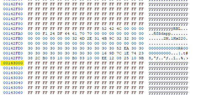

    I don't know how much success you're going to have. I've tried quite a lot with my uHome UAM devices.
    The reported Encryption key: 00000000 00000000 00000000 00000000 on these is because reading of the key is disallowed rather it actually being 0000s I believe.
    Also the OTA and other partitions are in different places to standard Tuya.
    See my builds here with different coeff and partition layouts
    https://github.com/openshwprojects/OpenBK7231T_App/pull/1260
    https://github.com/openshwprojects/OpenBK7231T_App/pull/1257
    Also, I've detailed my journey with these in https://www.elektroda.com/rtvforum/topic4058227.html and https://www.elektroda.com/rtvforum/topic4032988.html#21106354
    Did you get a boot log with factory fw and a full backup before any flashing?

    Posts: 5236
    Help: 449
    Rate: 918
    and if you open it in HxD and go to 143000 does it look like this?
    Screenshot from HxD hex editor highlighting the field starting at address 00143000. The hex values are predominantly FF.

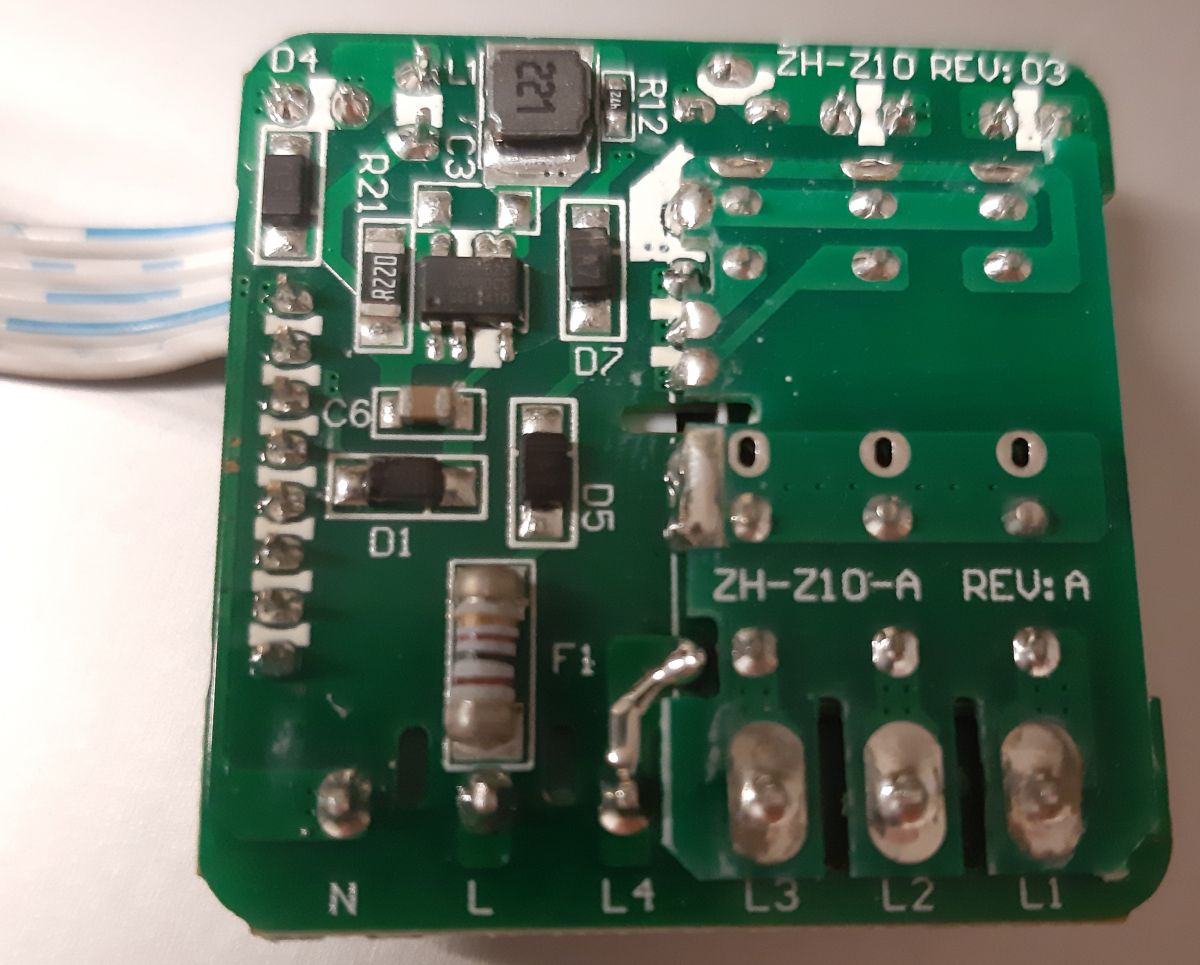

    Never got it to boot succesfuly with openbeken or esphome
    I ended up just swapping the chip with another cbu or esp8684-wroom-06
    Also I made a mistake of wiring COM to L instead of N. That kind of blew up the relay when I pressed the switch ending any further testing.
    On the plus side, this matter relay is slightly slimmer than other tuya wifi relays.

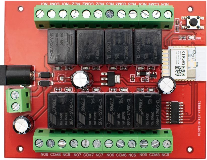

  • Seeking an 8-channel relay board compatible with OBK
    #9 21209005
    io2345
    Posts: 273
    Rate: 7
    Oh, I see. Well, if even specialists like you didn't get it to work, what can I do? I'll just send the device back. Anyway it wasn't exactly what I was looking for. In fact I would need a 8-channel switch for the eight floor heating valve actuators to control. Doesn't even have to be that small, there is plenty of space. Is there a smart device with eight relays, that can be used with OBK (or at least without any manufacturers cloud services)?
    I found this on Ali, but as the smart controller board says "CBU", I'll run into the very same problem, right?:

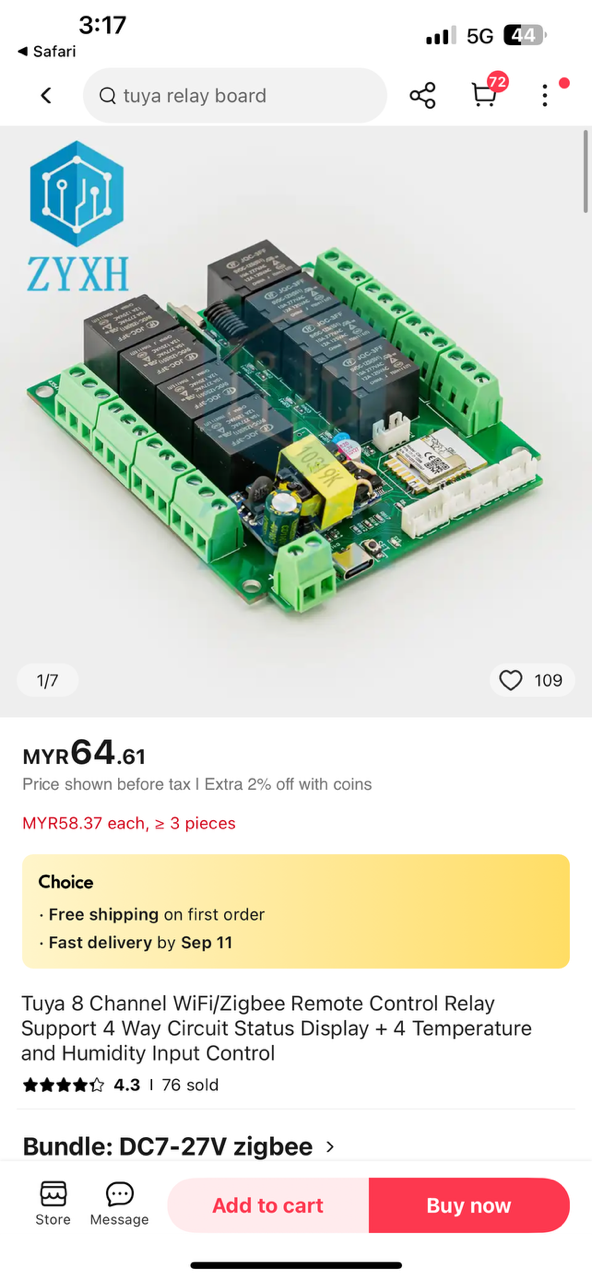

    I think you could use this one
    Just found this amazing item on AliExpress. Check it out! MYR16.17 | Tuya 8 Channel WiFi/Zigbee Remote Control Relay Support 4 Way Circuit Status Display + 4 Temperature and Humidity Input Control
    https://a.aliexpress.com/_oB5JIPL

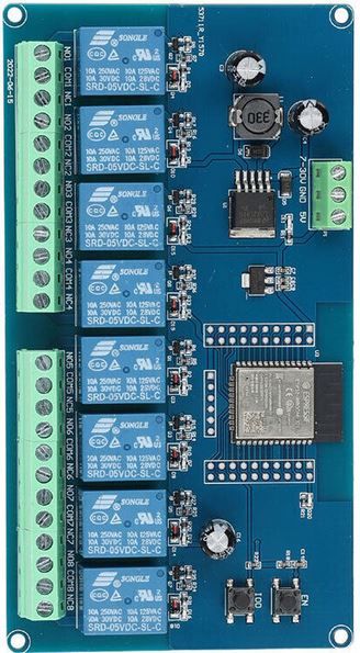

    This should be an option: running with ESP32 WROOM: Which Software to use with that. Is OBK possible on that hardware?

    Link seems to work fine to me, you could search for tuya 8 channel relay on AliExpress
    Tuya 8-channel relay board with ESP32 and Zigbee connectors for remote control.
    For that board with esp32, you can flash tasmota or esphome

    If it's a standard Tuya device then there will be no issue running OpenBeken on it
    this would be a Tasmota job

    Hinzugefügt nach 8 [Stunden] 31 [Minuten]:
    yes, exactly the same in HxD (reply to Divadiow's question in #7)
    One more information: After flashing back the original firmware, I tried to add the device in Tuyas SmartLife-App. That fails with the message: "Error 3062. This Matter device is not supported." It get's detected by Samsungs SmartThings as UA-SmartSwitch (2524). But I can't connect, it says: You need a Hub to connect

Which 8‑channel alternatives work with open firmware?
Standard Tuya 8‑channel relay boards can run OpenBeken. For ESP32‑based boards, use Tasmota instead. As one expert put it, "this would be a Tasmota job." Pick hardware with accessible headers and documentation. [Elektroda, divadiow, post #21209119]
