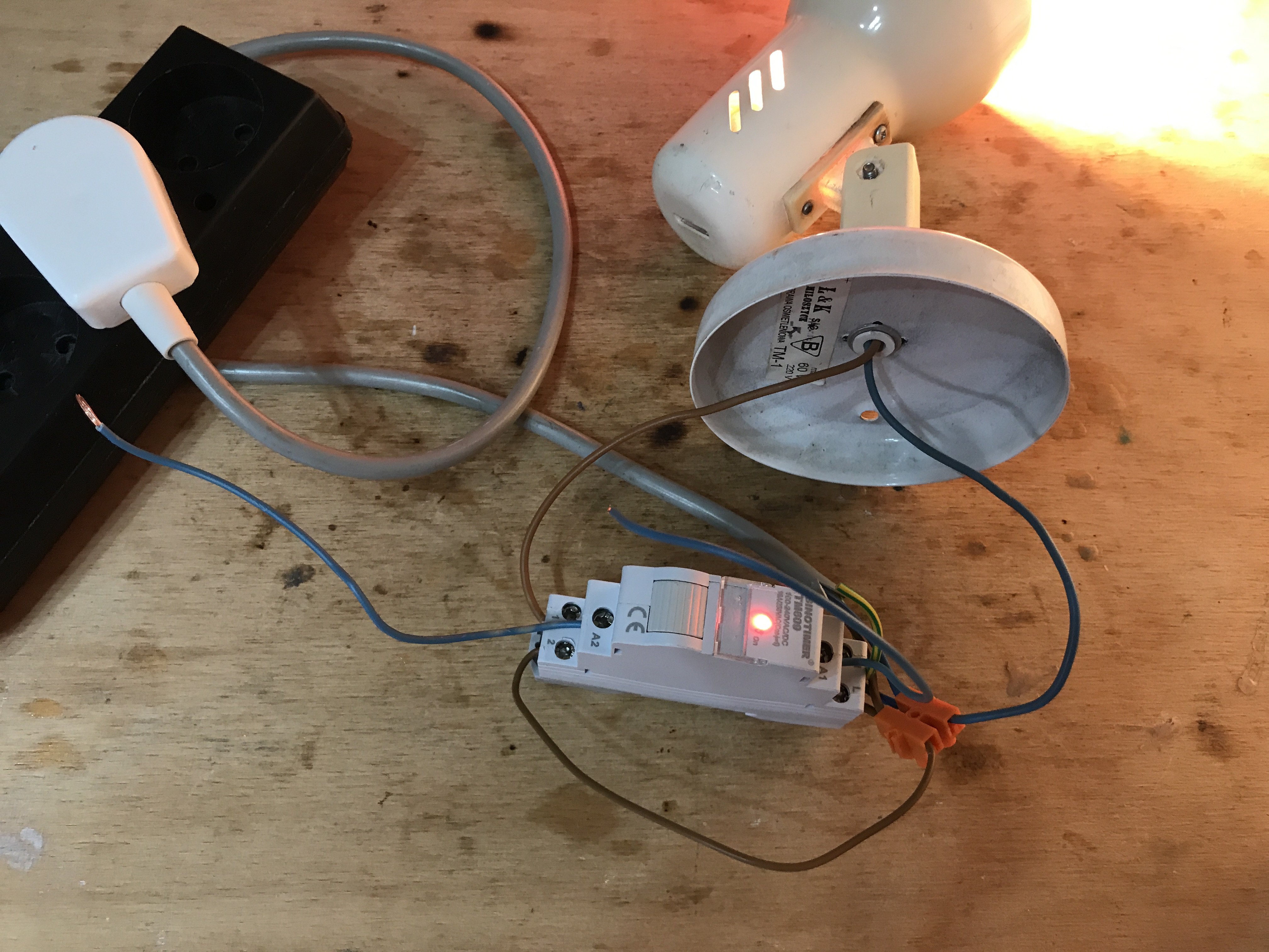

Here I will present an unusual Tuya relay that (unlike many others) is able to remember and execute its work schedule even if the WiFi connection is lost. This is something new, as the Tuya/SmartLife devices I've tested previously relied entirely on the manufacturer's cloud and didn't even timer locally. The product in this theme is different - as the manufacturer itself emphasises several times. Will it work in practice? Let's find out.

Does it actually hold the schedule after WiFi is turned off? .
I tested this several times, both with the Countdown option (i.e. "turn off in 10 minutes" etc) and the Schedule option ("Turn light on Fridays at 7pm").
For the test, I switched the router off the power, depriving the whole house of internet (as well as depriving the LAN).
4:33am - let's set the schedule to 4:40am and turn the router off:
NOTE - the state of the relay is determined by "Switch:O n", i.e. it will turn it on. This "Toggle" (switch) on the application GUI is from turning on the action execution itself.
O 4:40:
It works! Several tests show that the product does indeed remember the schedule without WiFi access.

Does the product hold the previous state when power is lost? .
I was already about to give a positive verdict, but was still tempted to check something else....
What happens when the relay is off and we cut the power to it and restore it after a period of time?
The product remembers the state before power was lost, but the light flashes for a while. At first I thought there was a relay shorted by default, but not.... so there must be an unwanted high state on the relay output for a while during ESP booting, and probably before it boots (or before it reads the previous setting from memory) this moment passes and the light flashes....
Can this controller be controlled by a phone on the same WiFi network when the WiFi itself has no internet access? .
The mobile phone was disconnected from WiFi. I then disconnected the main internet cable from the router (WAN), disabled mobile data on the phone and connected it to the same WiFi as the subject device was.
The device was detected by the phone and could be controlled.

ditomek 07 Jan 2022 12:00
if the device keeps track of the schedule without access to the cloud, how does it handle the countdown? [Read more]
krzbor 07 Jan 2022 12:06
An interesting circuit, but something doesn't sit right with me - if it works properly when the voltage returns, it must have some sort of RTC. Permanent state saving is also a problem - ESP doesn't have... [Read more]
p.kaczmarek2 07 Jan 2022 12:12
. It must be counting it down on the ESP (with little accuracy as there is no watch quartz inside). Then when WiFi comes back it probably syncs. Maybe this +-30 seconds accuracy message is also coming... [Read more]
Anonymous 07 Jan 2022 12:36
. I wonder if there is a supercapacitor in there.... (you can't see it from the photo). The ESP remembers the logic state after a loss, but does it also timer after a power loss? As nothing a typical... [Read more]
p.kaczmarek2 07 Jan 2022 12:54
Same question as @krzbor asked - the answer is no, the device only manages when there is no WiFi for a while (or thereabouts, no internet) but the power must be on all the time. If you unfortunate lose... [Read more]
Anonymous 07 Jan 2022 13:07
All in all, the manufacturer could expand its range.... Anyway, that "flashing" when the power is switched on doesn't sound interesting.... Didn't your colleague think about modifying this circuit ? Anyway,... [Read more]
krzbor 07 Jan 2022 13:10
. Every ESP has a quartz (though rather a generator with a quartz). Wi-Fi requires good timing parameters. Here is an example of the ESP-01: https://obrazki.elektroda.pl/9350876600_1641557187_thumb.jpg... [Read more]
p.kaczmarek2 07 Jan 2022 13:18
. Oy, we misunderstood here. Watch quartz (bold in quote mine) = 32.768kHz, used for precision timing in RTCC. This "32.768kHz" value was not chosen quite arbitrarily. And that every ESP has a 40MHz... [Read more]
Anonymous 07 Jan 2022 13:29
No well known point. Just divide that 32.768 value by 2 until you get to 1s. I think what he meant was that with a 40MHz quartz clocking the US, you can also get a reasonably accurate clock. Personally,... [Read more]
krzbor 07 Jan 2022 13:30
If the ESP has a resonator, the timing accuracy will be high. It does not need a separate watch quartz - it only needs a resonator to measure time. [Read more]
p.kaczmarek2 07 Jan 2022 14:56
It depends what you mean by "high accuracy", there is various information on the internet about the inaccuracy of timekeeping on the ESP: . https://nodemcu.readthedocs.io/en/release/modules/rtctime/ Of... [Read more]
krzbor 07 Jan 2022 19:52
The RTC you write about is used "while the module is sleeping" and is used for wake-up. During normal operation (as in this case), the time is timed exactly. In Arduino, for example, we have the millis()... [Read more]
