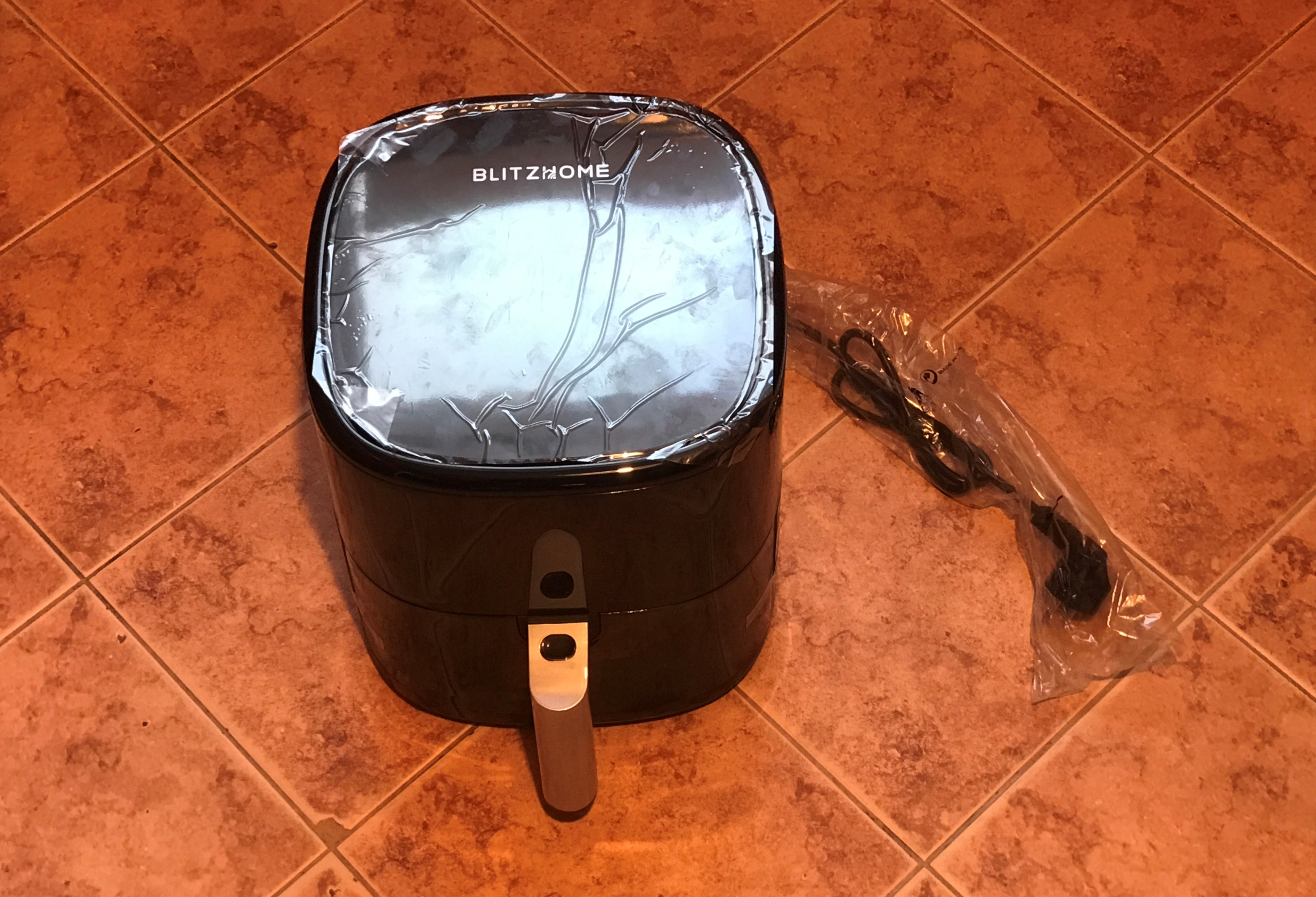

Postage, kit, instructions .
I received the parcel 3 working days after ordering (but there was still a weekend on the way). Hand delivery of course, although the courier did not take any signature from me.
Drawer with tray (it has these heat-resistant elastics on the four edges so that you can more or less align it with the middle of the drawer):

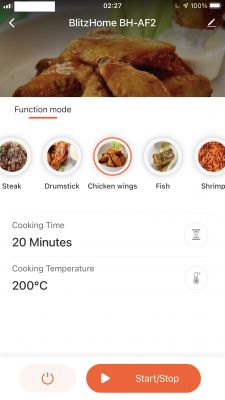

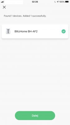

I first tested the product with its manufacturer's app, BlitzWolf.
I already had it downloaded from the Appstore (on iOS; on Android, on the other hand, we download it from Google Play).
Pairing is initiated by pressing the Power button until the WiFi icon starts flashing.
Then, in the app, we add the device from the Kitchen -> Fryer list, enter the SSID/password of our WiFi and confirm the connection.
Unless the app searches for the device beforehand on its own - this happened to me too.
Below are the screenshots:
Once paired, we can remotely switch the appliance on and off, select one of the pre-defined programmes, change the temperature and operating time as we wish (also during operation) and start and stop baking. We also have a preview of the current baking time:
In operation:

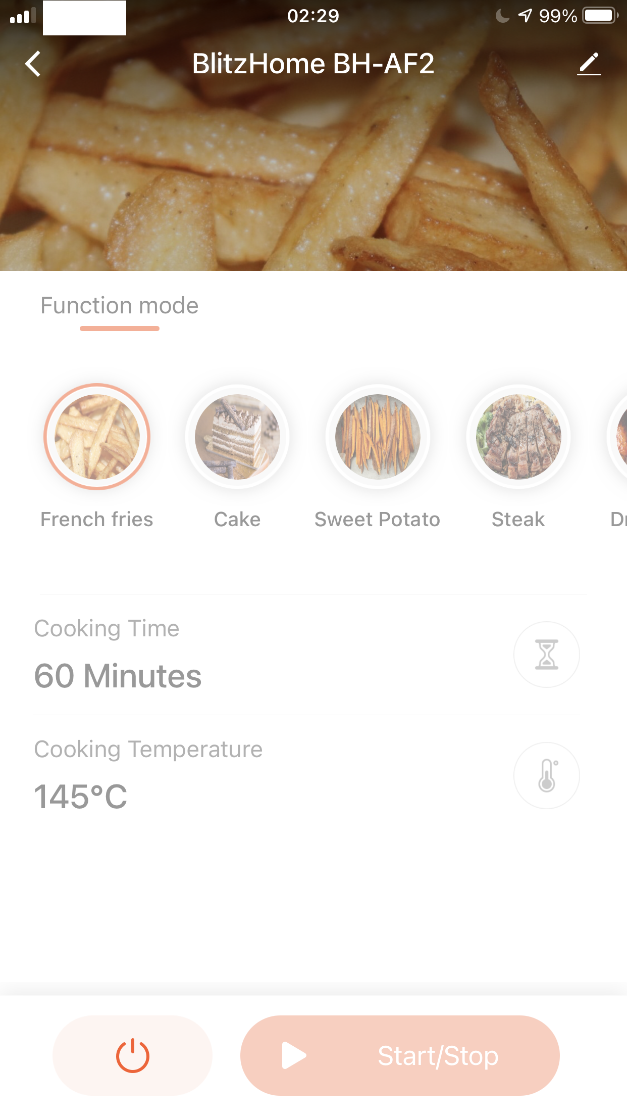

Automations .
The appliance supports automations/scenarios, so you can create your own baking programmes, even ones triggered, for example, by an external button or voice (Alexa, etc.).
Create automations - setting temperature (for example 145 degrees), time (for example 60 minutes):
Execution of automation:
It works - 60 minutes at 145 degrees!
