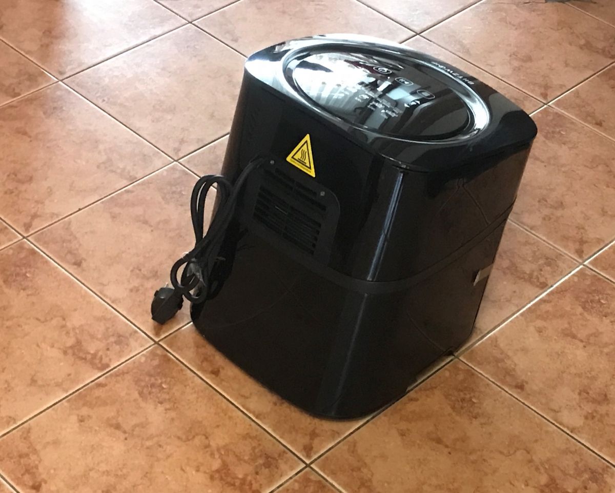

    Fryer:
    OpenBeken on BW-AF1 fryer with WiFi - interior, TYWE3S/WB3S, configuration OpenBeken on BW-AF1 fryer with WiFi - interior, TYWE3S/WB3S, configuration

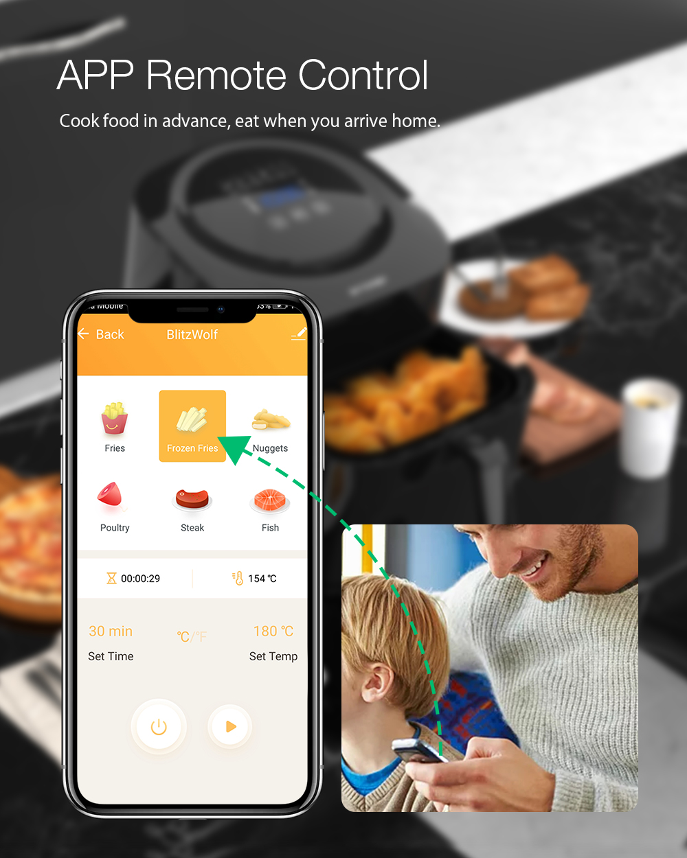

    Ready-made "recipes" for fish, chips, etc. (properly set temperature + time) are available only from the mobile application. The touch buttons only allow you to set the time and temperature manually, as well as pause the work. Ejecting the tray also automatically pauses the work.
    However, our home experience shows that these "recipes" from the application are worth nothing anyway - the baking time depends on the amount of product anyway, so you need to gain experience with this deep fryer and choose parameters based on previous experience.

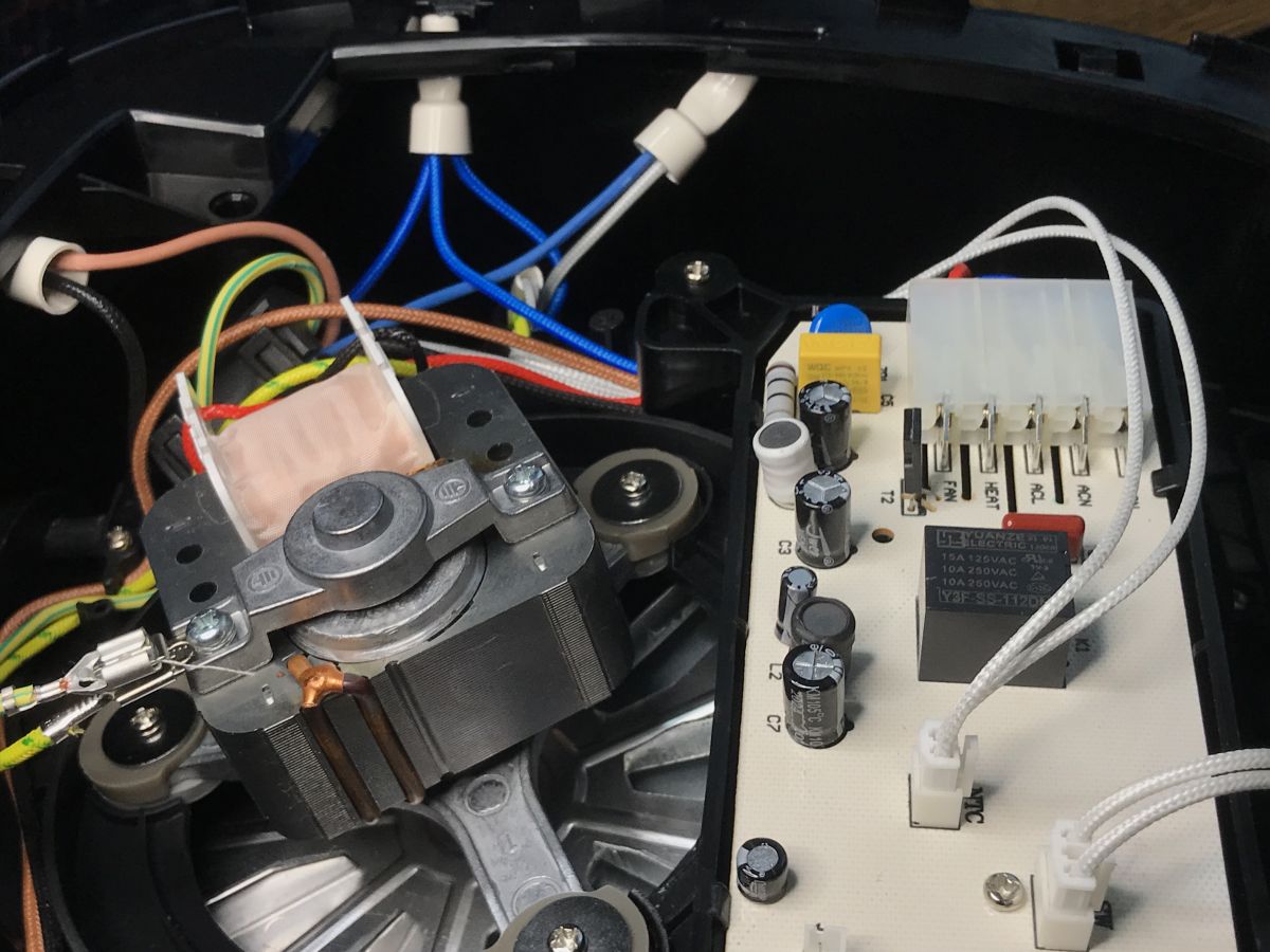

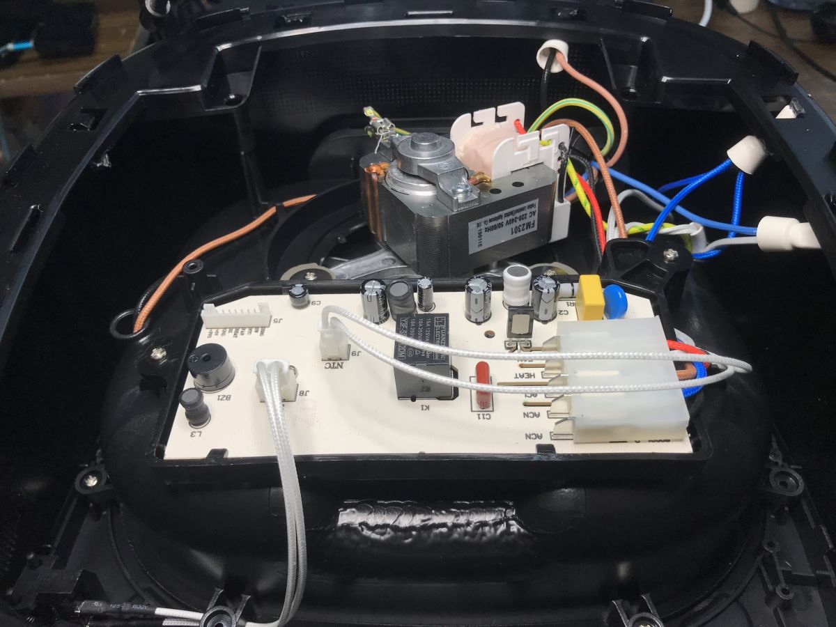

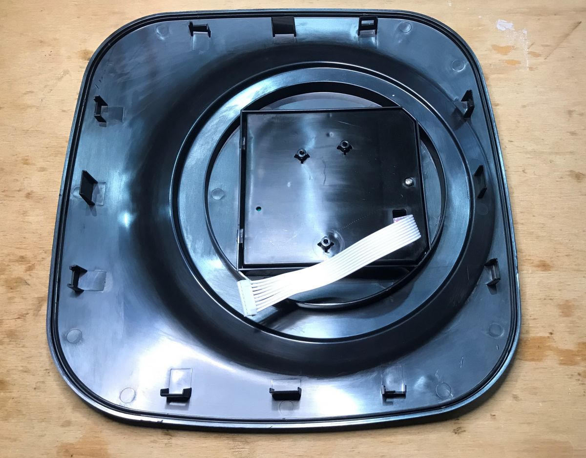

    Interior of the BW-AF1

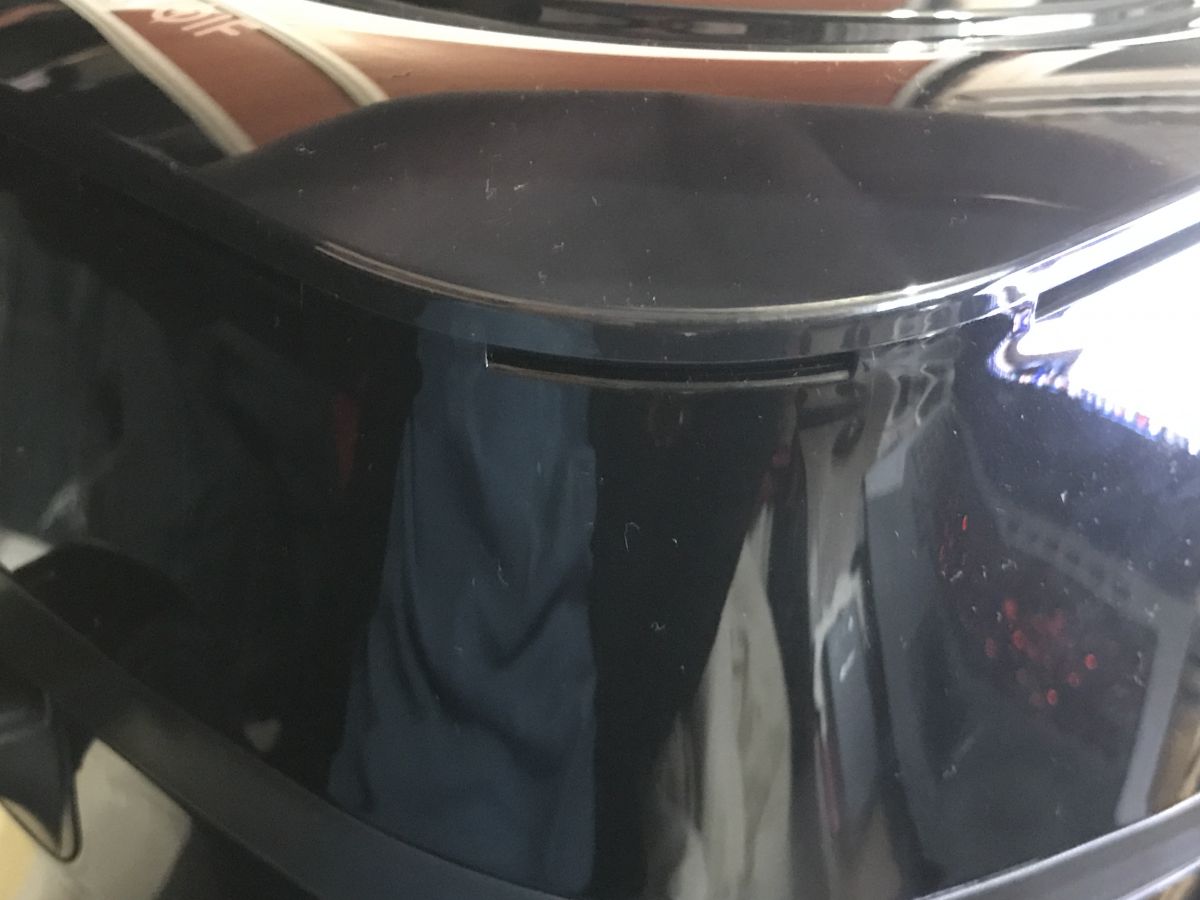

    The top cover is held on by hooks, but it is very difficult to remove it without damaging them.

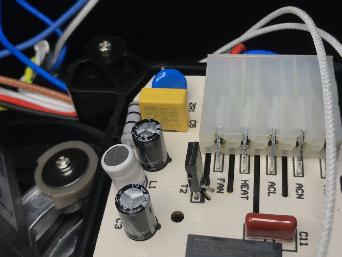

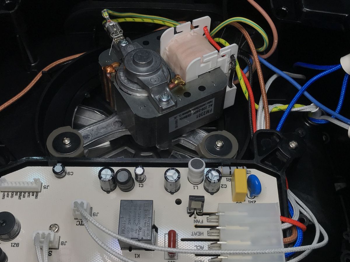

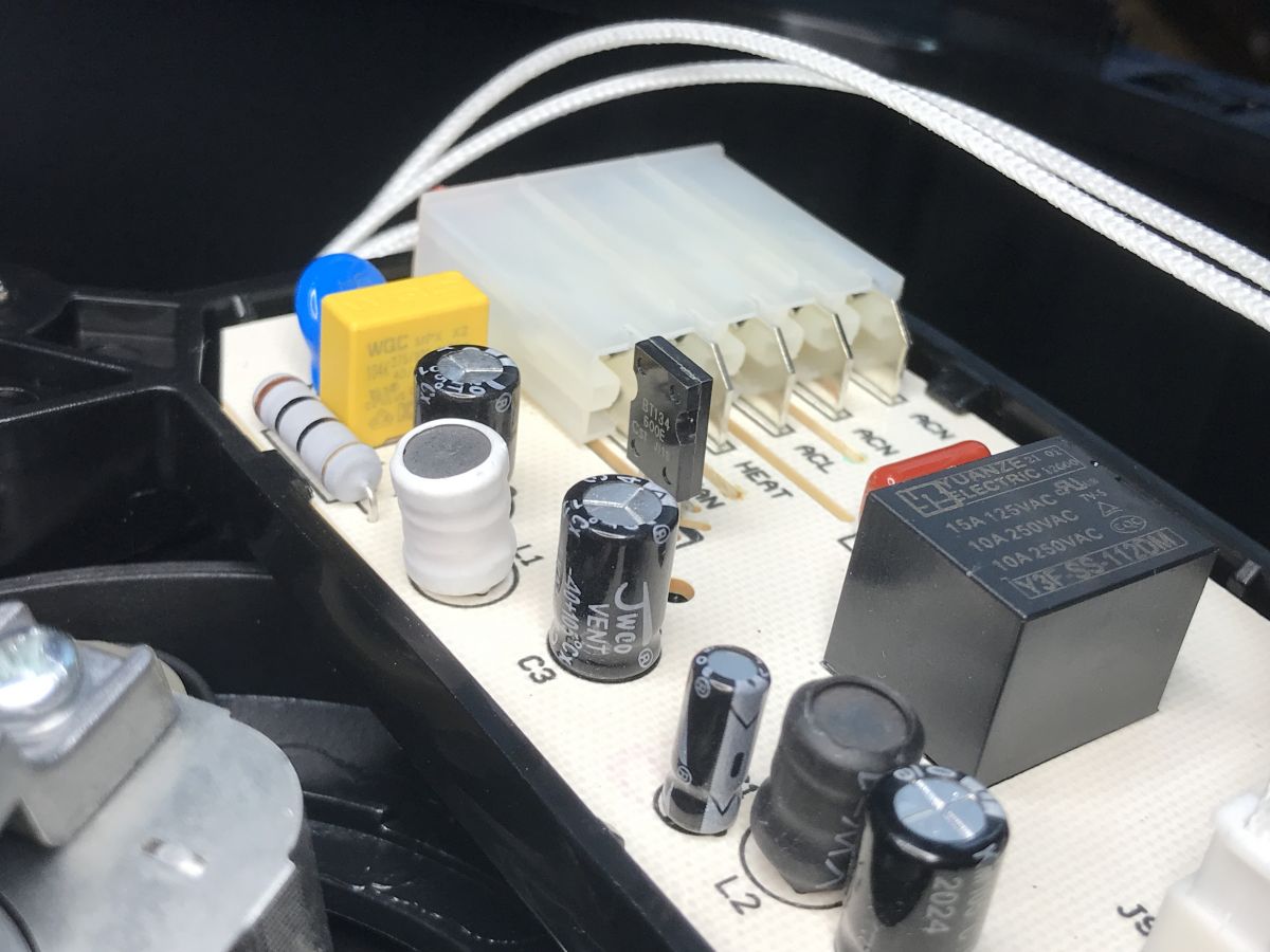

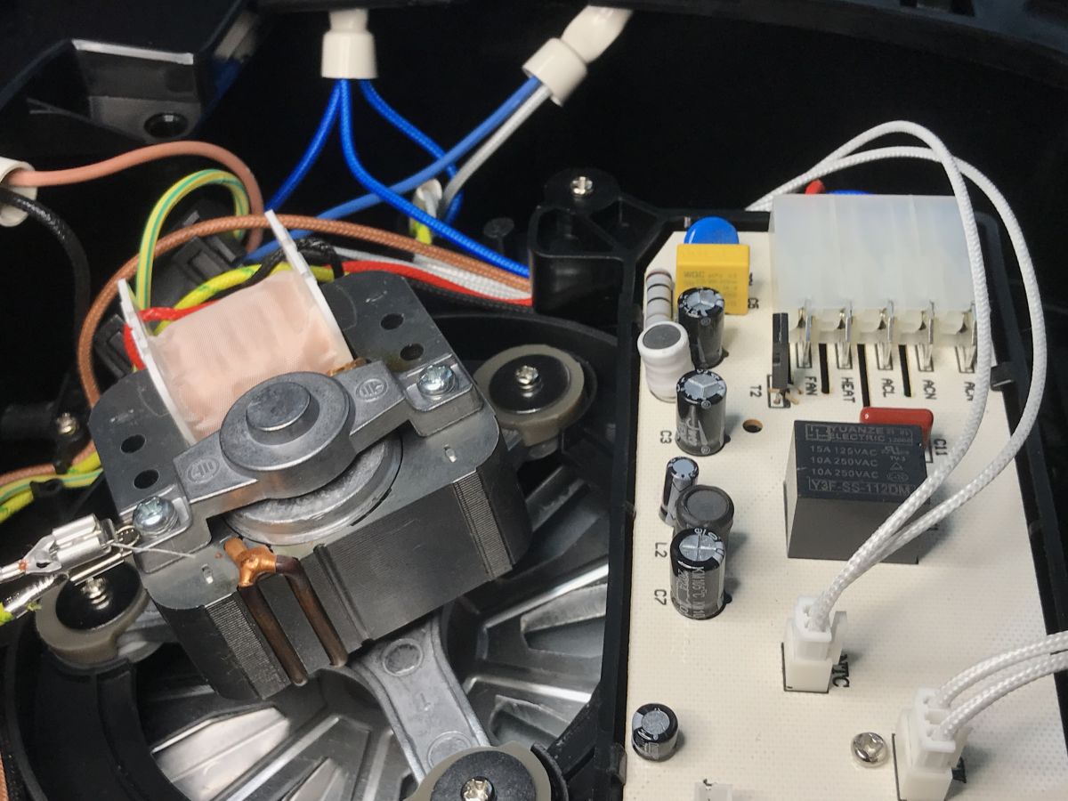

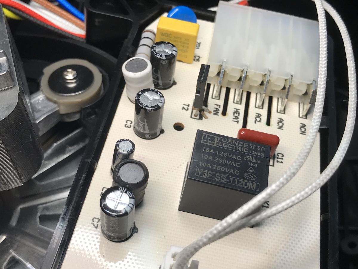

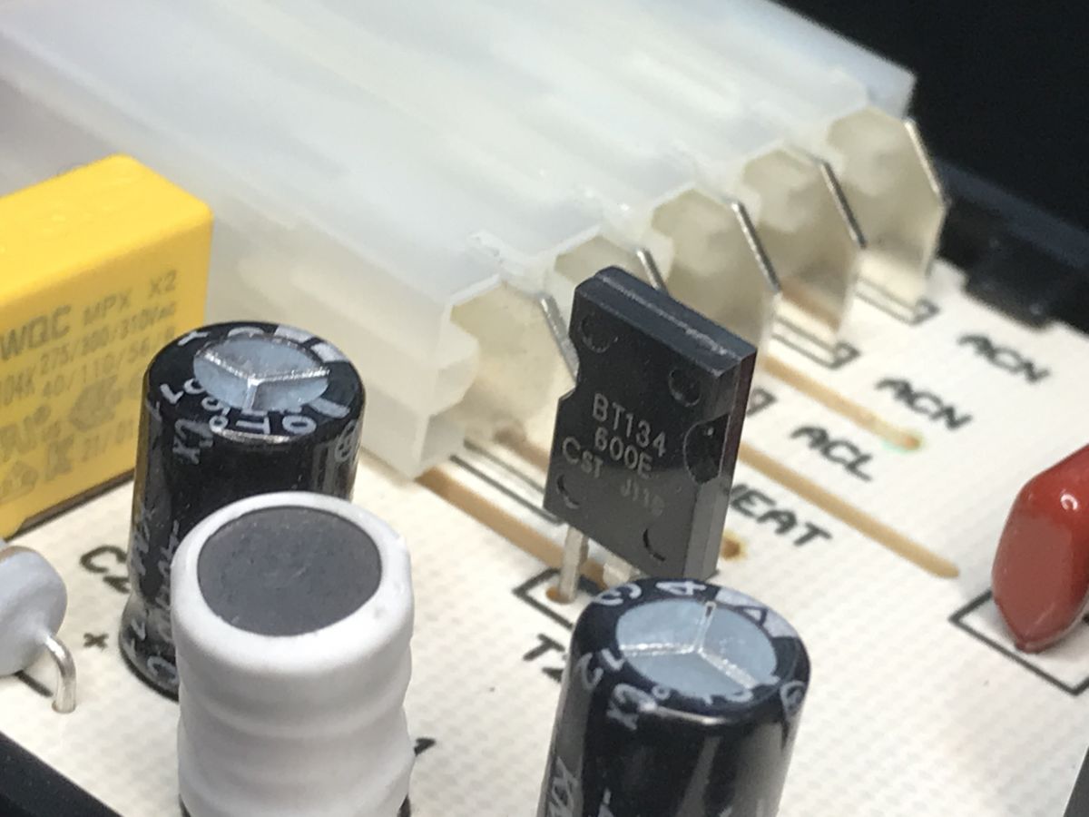

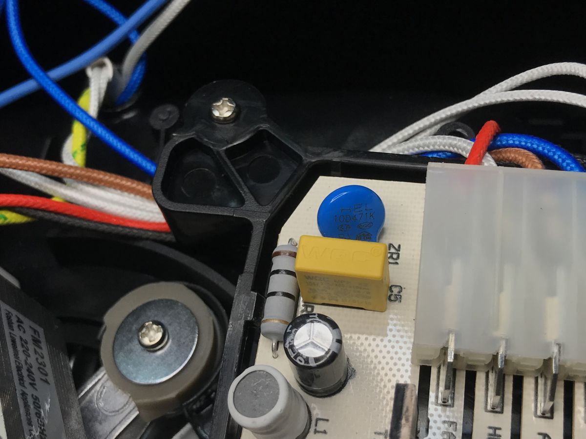

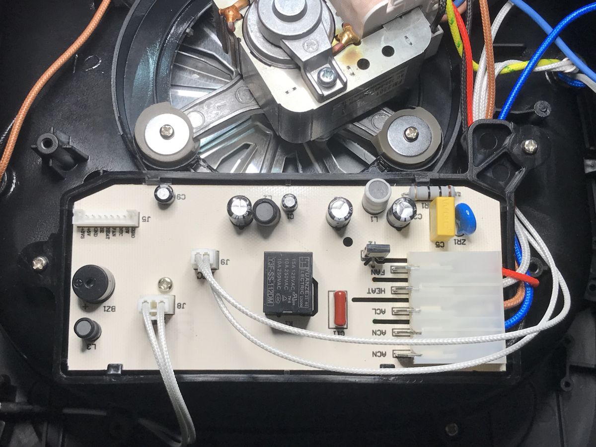

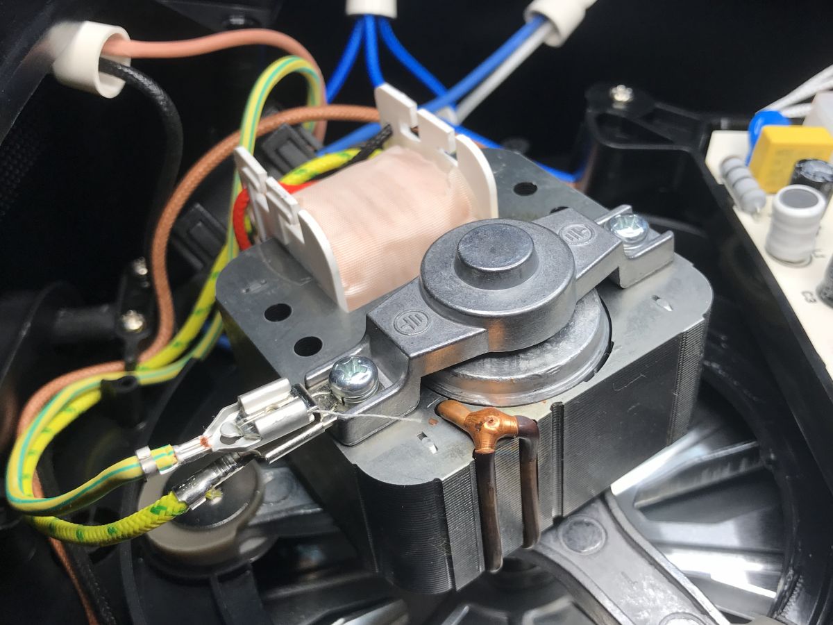

    After removing the cover and disconnecting the plug from it, we can see the fan motor and the heating connection with the relay (FAN, HEAT), there are also visible filters and input protections (varistor, capacitor, there is also a fuse resistor, etc.) and, for example, a buzzer:
    OpenBeken on BW-AF1 fryer with WiFi - interior, TYWE3S/WB3S, configuration OpenBeken on BW-AF1 fryer with WiFi - interior, TYWE3S/WB3S, configuration OpenBeken on BW-AF1 fryer with WiFi - interior, TYWE3S/WB3S, configuration OpenBeken on BW-AF1 fryer with WiFi - interior, TYWE3S/WB3S, configuration OpenBeken on BW-AF1 fryer with WiFi - interior, TYWE3S/WB3S, configuration OpenBeken on BW-AF1 fryer with WiFi - interior, TYWE3S/WB3S, configuration OpenBeken on BW-AF1 fryer with WiFi - interior, TYWE3S/WB3S, configuration OpenBeken on BW-AF1 fryer with WiFi - interior, TYWE3S/WB3S, configuration OpenBeken on BW-AF1 fryer with WiFi - interior, TYWE3S/WB3S, configuration OpenBeken on BW-AF1 fryer with WiFi - interior, TYWE3S/WB3S, configuration OpenBeken on BW-AF1 fryer with WiFi - interior, TYWE3S/WB3S, configuration OpenBeken on BW-AF1 fryer with WiFi - interior, TYWE3S/WB3S, configuration

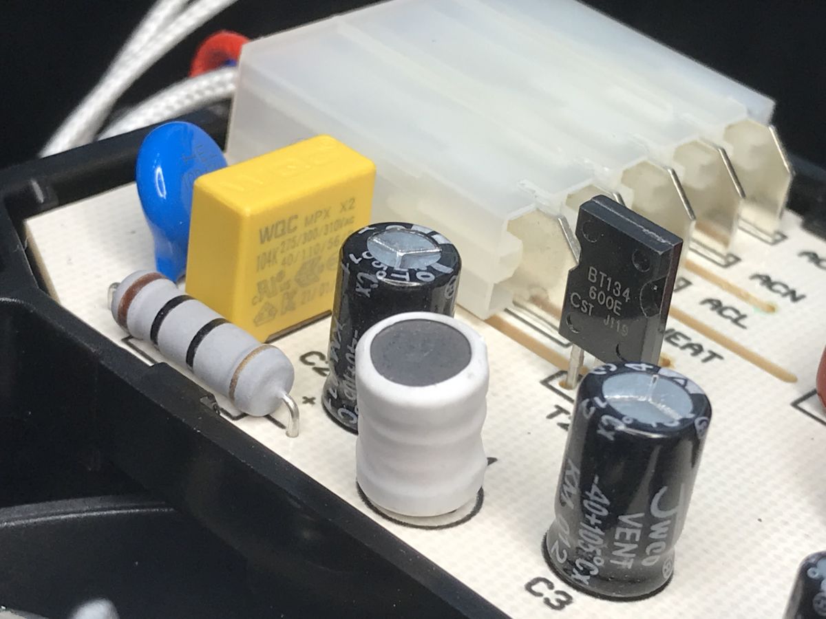

    The fan motor, as you can see, is 230V, it's probably the relay from it.

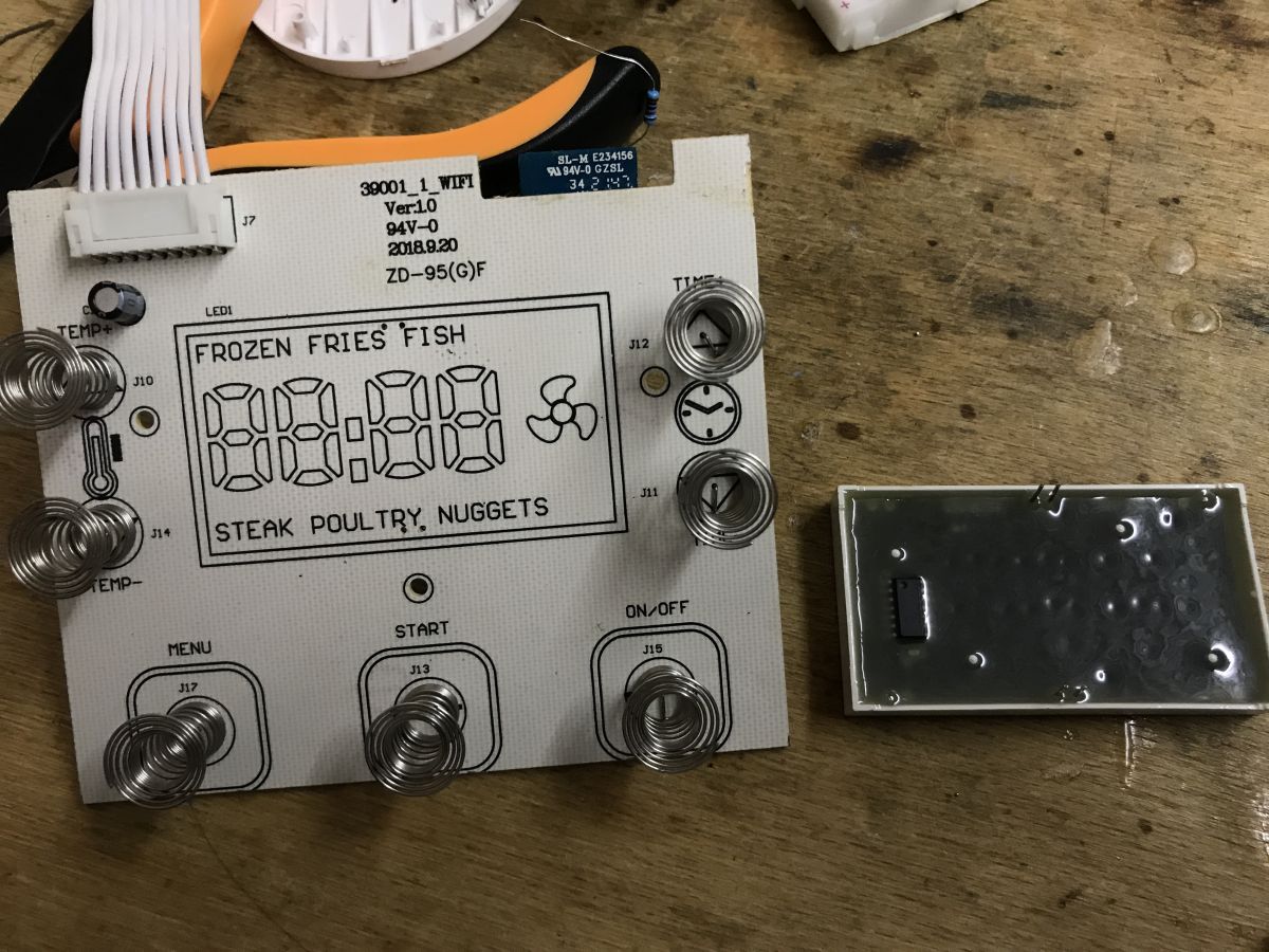

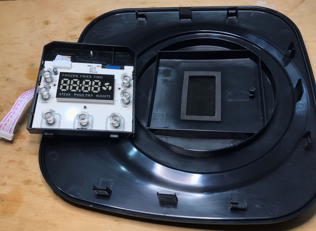

    Second part left:

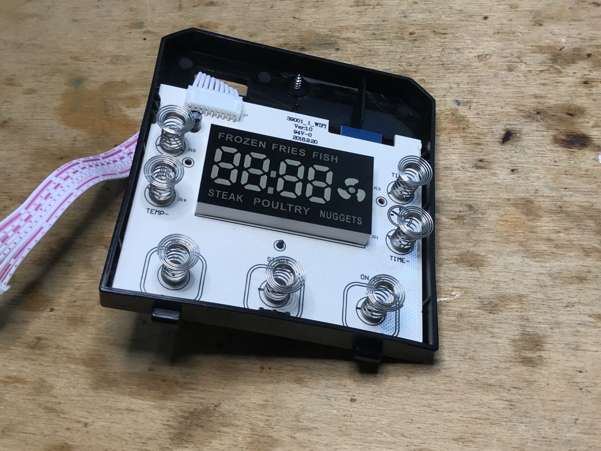

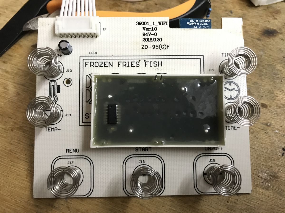

    Display, touch buttons:

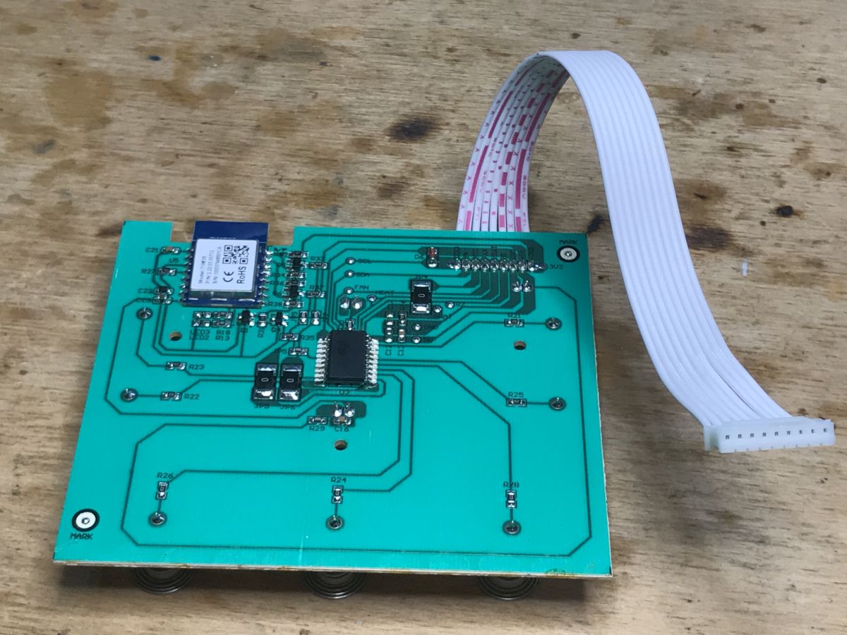

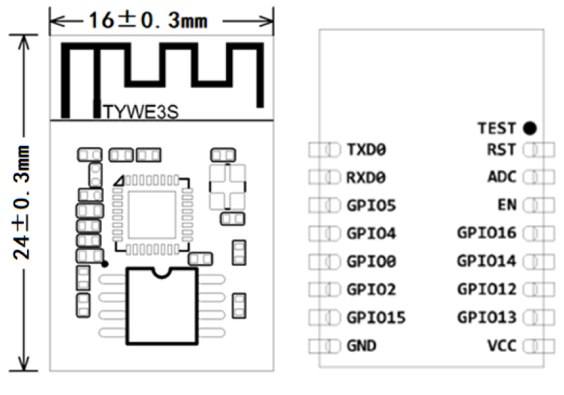

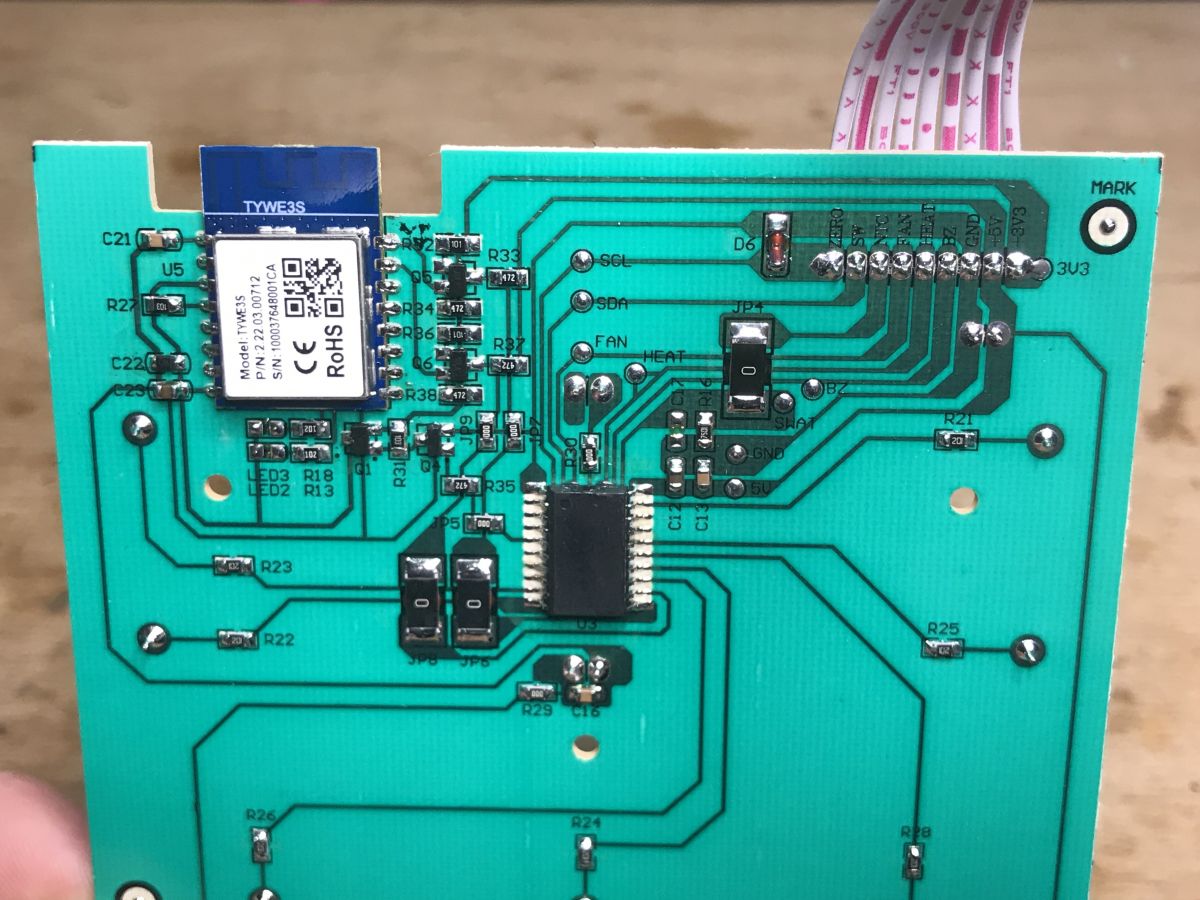

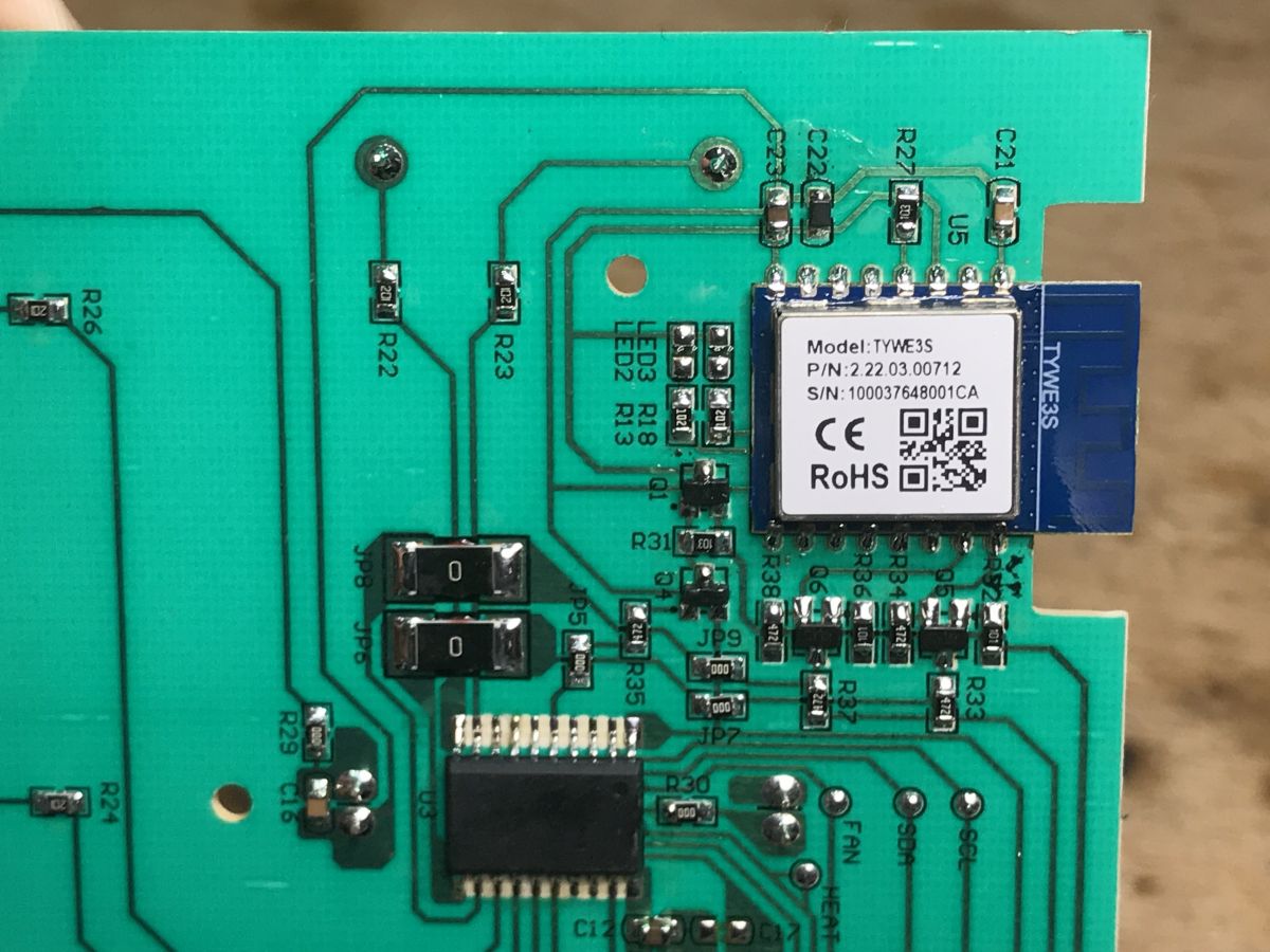

    BW-AF1 uses the TYWE3S module, i.e. ESP8266:
    Leads:

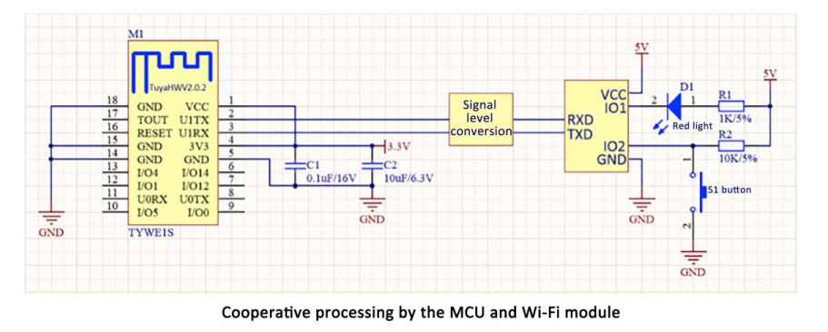

    There is also a microcontroller on the board. The product uses TuyaMCU . The WiFi module communicates with the microcontroller via UART.

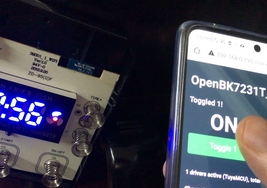

    Experiment with OpenBeken
    I tested the Tasmota template described earlier about a year ago and it really worked, but it didn't give me the satisfaction of doing something myself.
    As an experiment, I decided to try to fire mine OpenBeken on this fryer.
    It's just to better be able to test my firmare and verify my TuyaMCU driver - will it manage in a completely foreign environment?

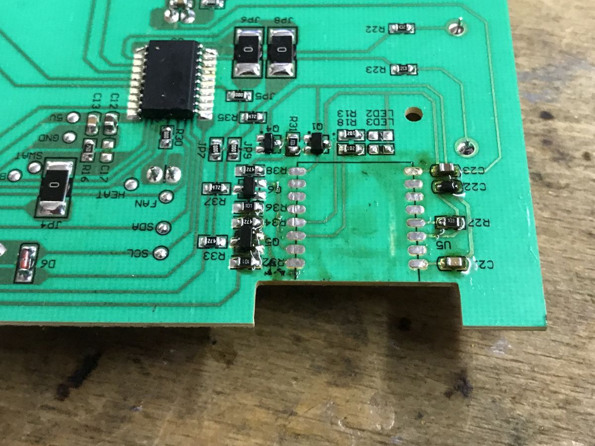

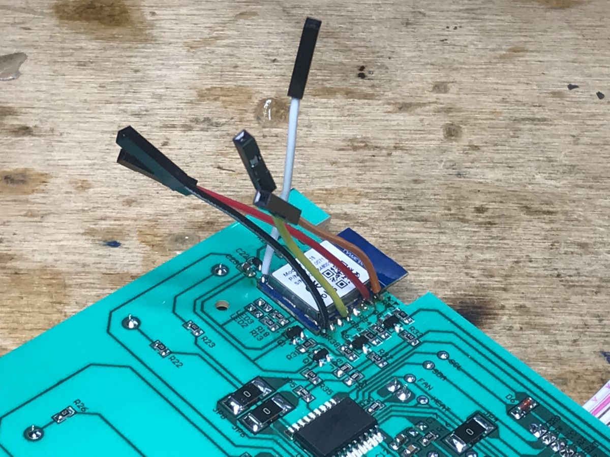

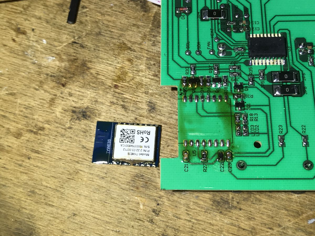

    I started the fun with the TYWE3S soldering:
    I cleaned the pads:

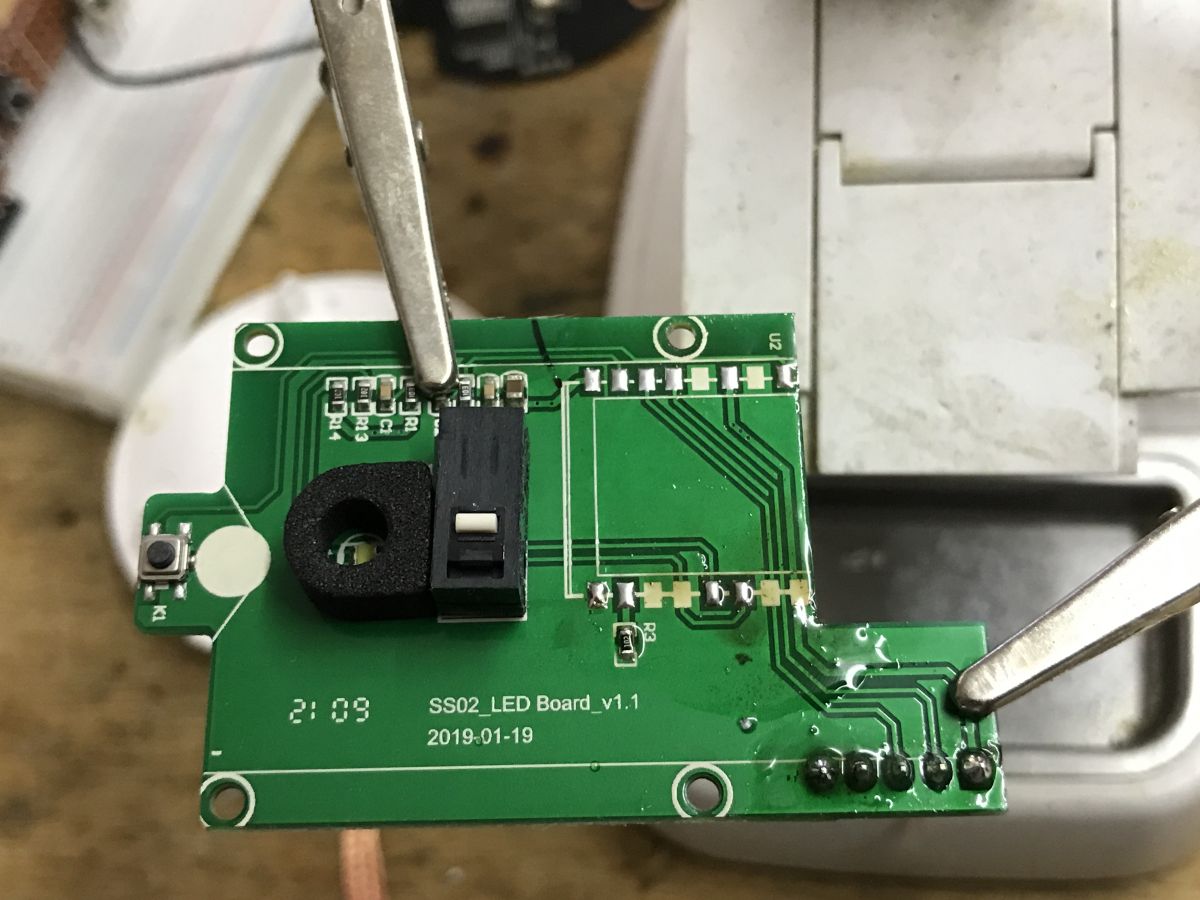

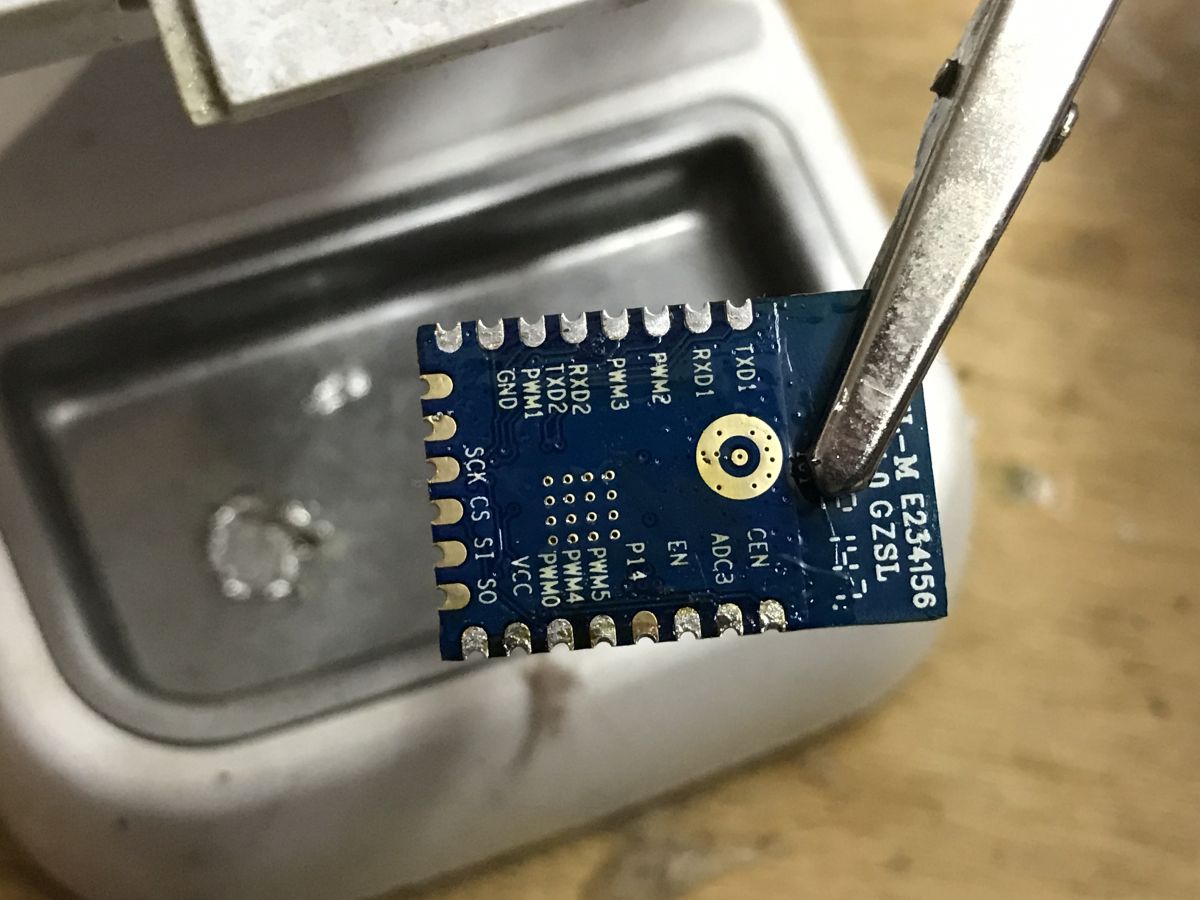

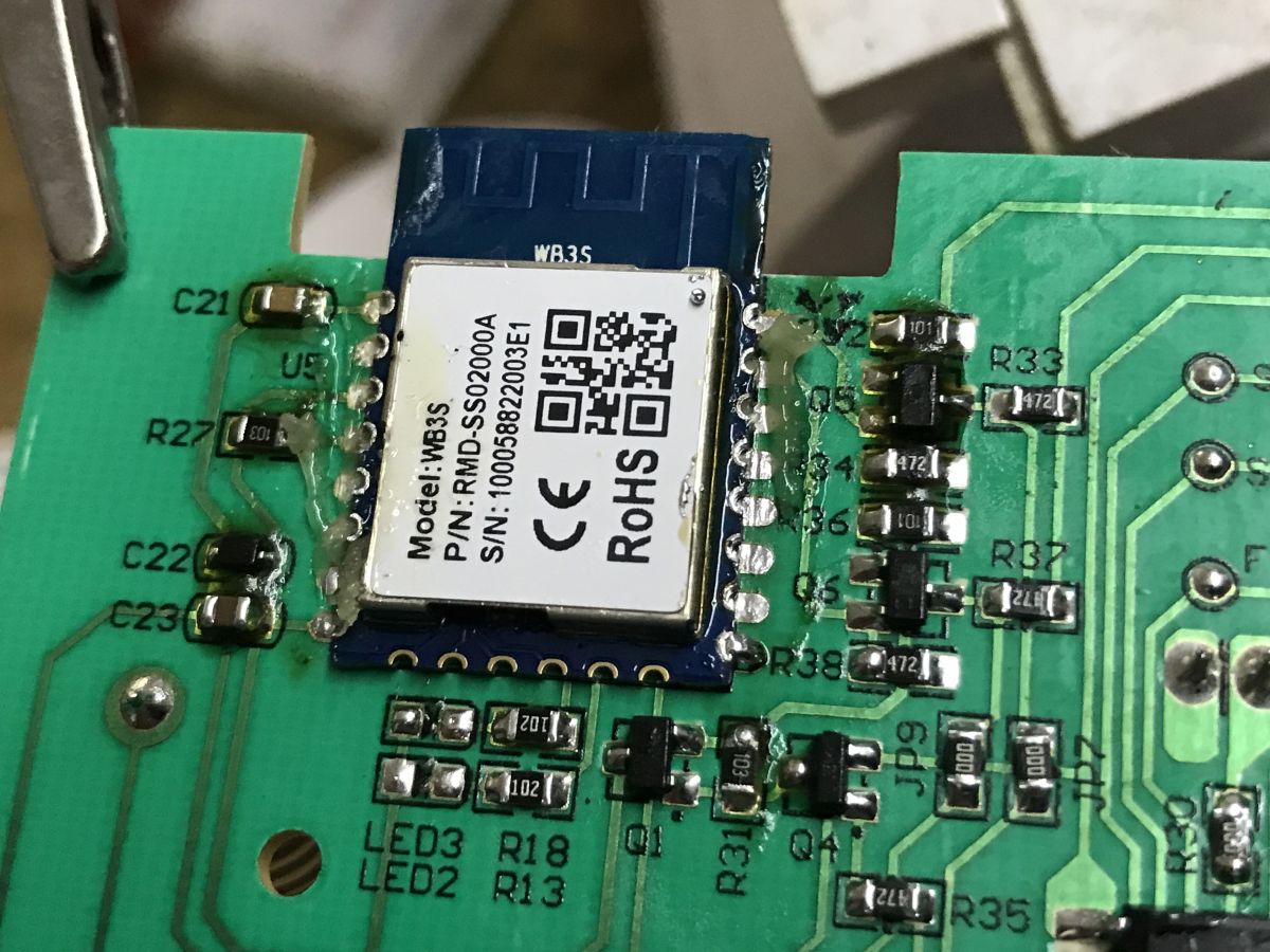

    I recovered WB3S from a light switch from the USA that I got from a reader:
    WB3S desoldered:
    WB3S in a new place:

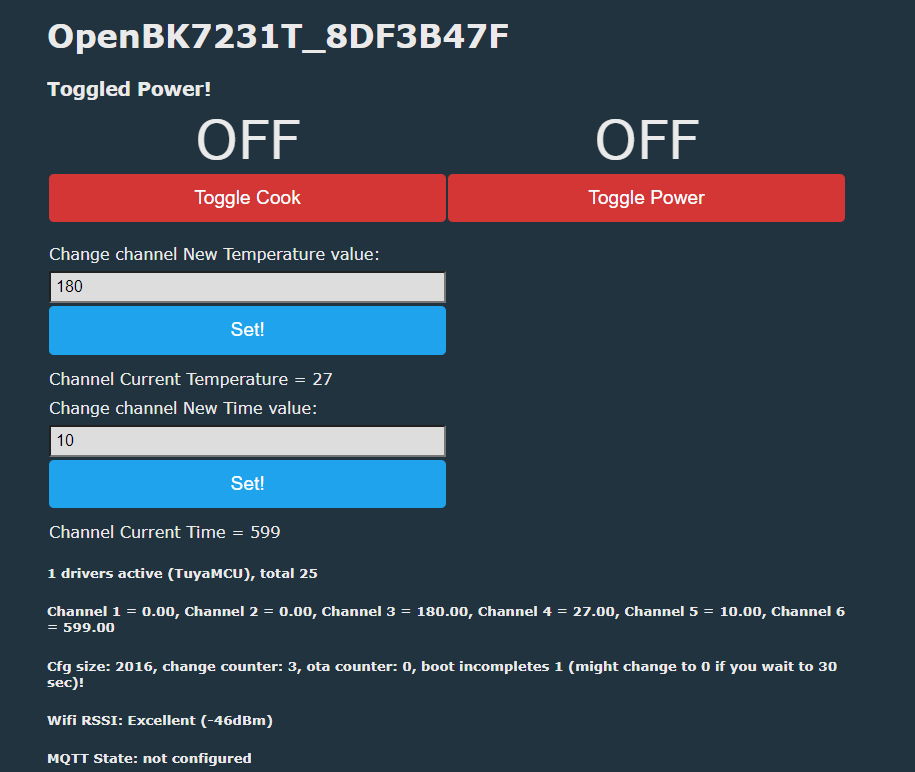

    Result in OpenBeken:
    The basic work algorithm is:
    1. Turn on Power
    2. Set the temperature to 180
    3. Set the time to 10 (setting is in minutes, time reading is in seconds)
    4. Enable Cook
    The above menu already allows it in this form, but it can be automated.

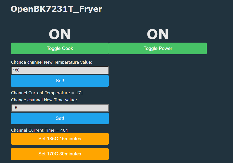

    You can create recipes via alias :
    alias cook185c15min backlog setChannel 2 1; setChannel 3 185; setChannel 5 15; setChannel 1 1
    alias cook170c30min backlog setChannel 2 1; setChannel 3 170; setChannel 5 30; setChannel 1 1
    The alias can be invoked just like a regular command, from the console or from a script, via MQTT, via publish, or from a GUI button.
    GUI buttons in OpenBeken can be freely scripted. Add to autoexec:
    startDriver httpButtons
    setButtonEnabled 0 1
    setButtonLabel 0 "Set 185C 15minutes"
    setButtonCommand 0 "cook185c15min "
    setButtonColor 0 "orange"
    setButtonEnabled 1 1
    setButtonLabel 1 "Set 170C 30minutes"
    setButtonCommand 1 "cook170c30min "
    setButtonColor 1 "orange"
    The meaning of the following commands:
    - startDriver httpButtons - starts the driver for scriptable buttons
    - setButtonEnabled 0 1 - enables the null button (index 0, state 1, i.e. ON)
    - setButtonLabel 0 "Set 185C 15minutes" - sets the label (displayed text) of the zero button
    - setButtonCommand 0 "cook185c15min" - sets the command for this button
    - setButtonColor 0 "orange" - sets button color to orange (HTML color name)

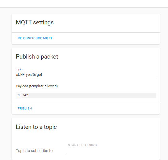

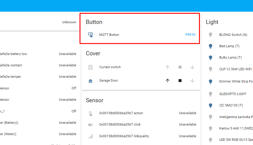

    But back to MQTT - this is what the alias call via publish looks like:
    cmnd/obkDevice12345/cook185c15min
    Payload may be empty. This has the effect of turning the fryer on and setting it to the specified time and temperature.
    As a test, it can be sent from Home Assistant here, from the Mosquitto MQTT broker:
    Now you can pack it into buttons and controls on the GUI home assistant.

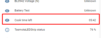

    Now it's a matter of time. You need to somehow display how many seconds are left until the end of the job.
    You could do this:
    Code: YAML
    But this is not a perfect solution - this will just display the given value without any formatting, e.g. 90 seconds as 90 and not as 01:30.
    Using the time formatting is quite simple though, just convert the value to an integer first:
    Code: YAML
    Much better:
    It's important to remember the passage value|int which converts the value to an integer, without it for me timestamp_custom didn't work.

  • I2C display controller behind TuyaMCU UART bridge
    #14 20464280
    Posts: 14797
    Rate: 12954
    I forgot to add it in the first post, so going back to the topic, I will mention that the display of this fryer was also interesting - it turned out to have an I2C controller, flooded together in its housing:
    Only four pins - SDA, SCL, ground, power.
    Of course, the display supports TuyaMCU, not the WiFi module, so changing the firmware is not a problem.
    So when we control the application, then ... first there are packets via TCP (say, HTTP is built on it), then the WiFi module sends via UART to the microcontroller, and then this MCU controls the display via I2C! A real Rube Goldberg machine, all just to make French fries, I wonder what will happen in 10 or 20 years...
The discussion revolves around the BW-AF1 fryer with WiFi capabilities, highlighting its configuration for Tasmota (TYWE3S) and potential modifications to integrate OpenBeken with a BK7231T WiFi module. Participants express skepticism about the necessity of IoT in simple household appliances, debating the practicality and potential risks of voice control features. Concerns are raised about the reliance on smartphone interfaces, with suggestions for local voice control solutions. The technical aspects of the fryer’s display, which utilizes an I2C controller, are also discussed, emphasizing the complexity of its operation involving multiple communication protocols.
