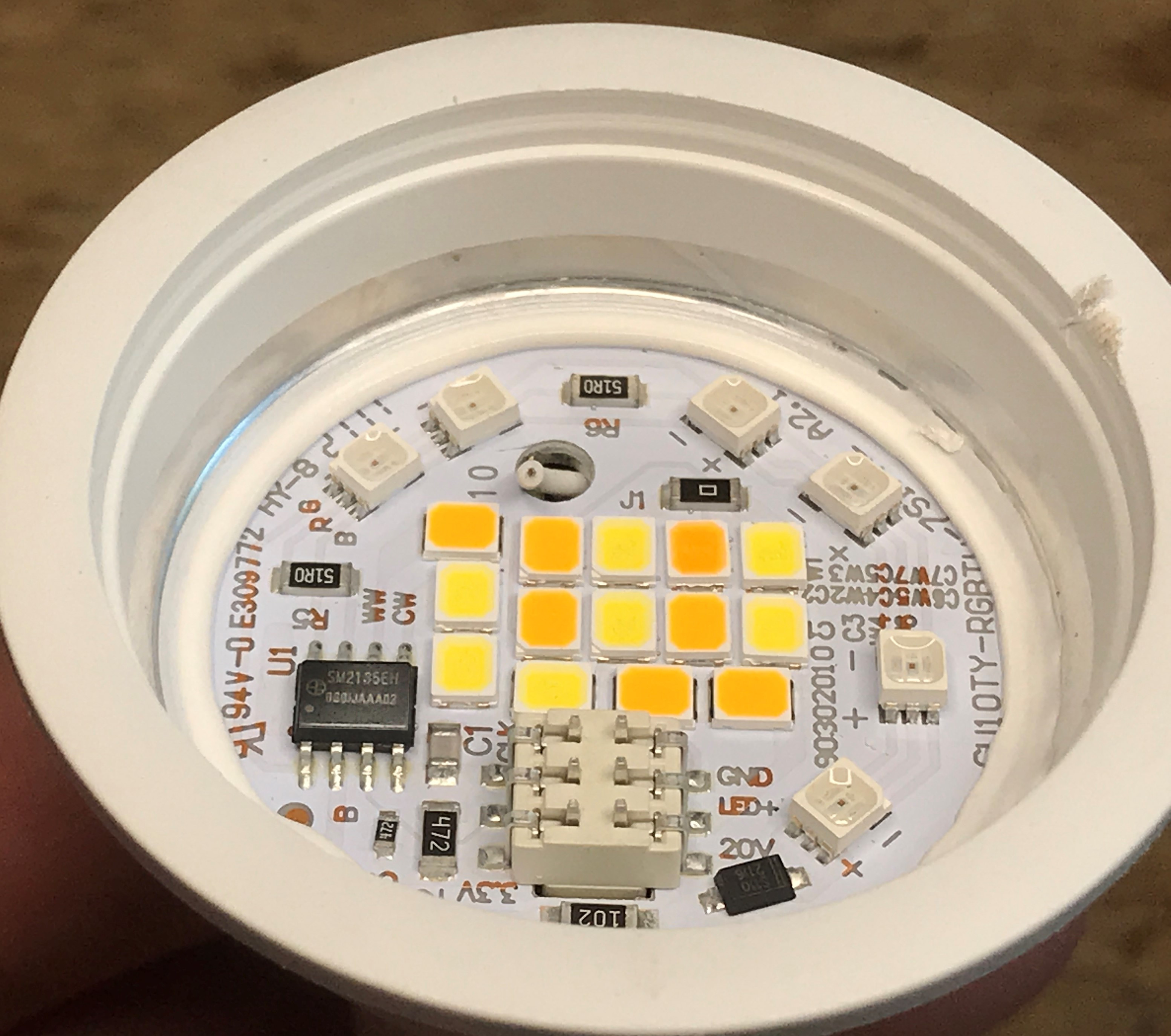

Teardown of WOJ14415
It is quite easy to remove the plastic transparent cover. Then you can see that SM2135 is inside:
I struggled a bit with the removal of the LED PCB. It was hard. Eventually I made a small hole on the other side and pushed it out.
The board pins are marked. You can see here, among others, CLK, which is the clock from I2C. The unsigned pin next to it is probably DATA, I2C data line. In addition, among others it is 3.3V (LED controller power supply), 20V (LED power supply?), ground...
The LEDs are separate warm, cold and colorful (RGB).

Five-channel I2C LED SM2135 controller
The SM2135 controller is used to operate RGBCW lamps, i.e. it supports 5 separate channels. It is controlled via the I2C lines, two signals: DAT and CLK, are sufficient to control 5 channels. In addition, it also requires power. 5 channels + 2 lines + power supply already gives us 8 pins, so the clever manufacturer gave the ground pad on the bottom of the chip:
SM2135 works on rectified mains voltage. No additional power supply is needed for it. An exemplary SM2135 application is presented below:
I must note that I suspect the signature "AC-> DC" on the step down converter powering the microcontroller (WiFi / Bluetooth module) is wrong, because there is already DC at the input. Aside from that, everything is correct, although sometimes there is no separate LDO regulator between the step down and the MCU module, as long as the converter gives a stable 3.3V for ESP or Beken chips (or other, less frequently used).
