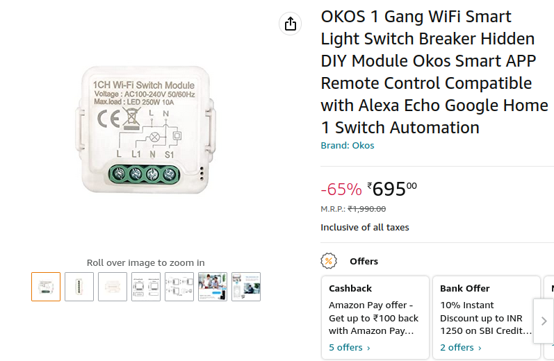

  • OKOS 1 Gang WiFi smart light switch module turns a traditional wall switch into an app- and voice-controlled relay for one light.
  • The module uses a WB3S MCU and autoexec.bat pin mapping for the relay, button, LED, and external switch, while the Okos Smart app links with Alexa and Google Home.
  • Technical specs list a 10A 250V relay and 2.4G Wi‑Fi support, with the countdown set in seconds from above 0 to below 86400.
  • Home Assistant integration adds MQTT control, countdown automation, and startup-state restore so the switch can remember Off, On, or the last power state.
  • Installation depends on the module fitting inside the switch box, so size confirmation before ordering is important.
OKOS 1 Gang WiFi Smart Light Switch Breaker Hidden DIY Module Okos Smart APP Remote Control Compatible with Alexa Echo Google Home 1 Switch Automation
Product Details
Easy convert your traditional switch into smart switch and get Remote Control, You can connect 1 light switch to this switch module by just installing 1 DIY smart switch module inside the switch board, suitable for installation inside switch box, please confirm the size before ordering.
Control On/Off of the bedroom lights via Your Voice Assistant like Amazon Alexa, Google Home or your mobile phone.
Wi-fi control via your mobile phone 2.4G Networks provides the needed connection to the DIY Switch Module without the need of a separate HUB.
Use the app "Okos Smart" on your Android / iOS device. Allows for Full Control of Your Lights or Compatible Appliances. Multiple Program Options Allow You to Plan the Exact Time to Turn Lights On/Off Automatically.
With this Wifi Switch module you can control your lights with the existing traditional switches and Mobile app simultaneously. Turning the light on via the traditional switch and turning if off via the mobile app/ voice commands is also supported in this unique device.
