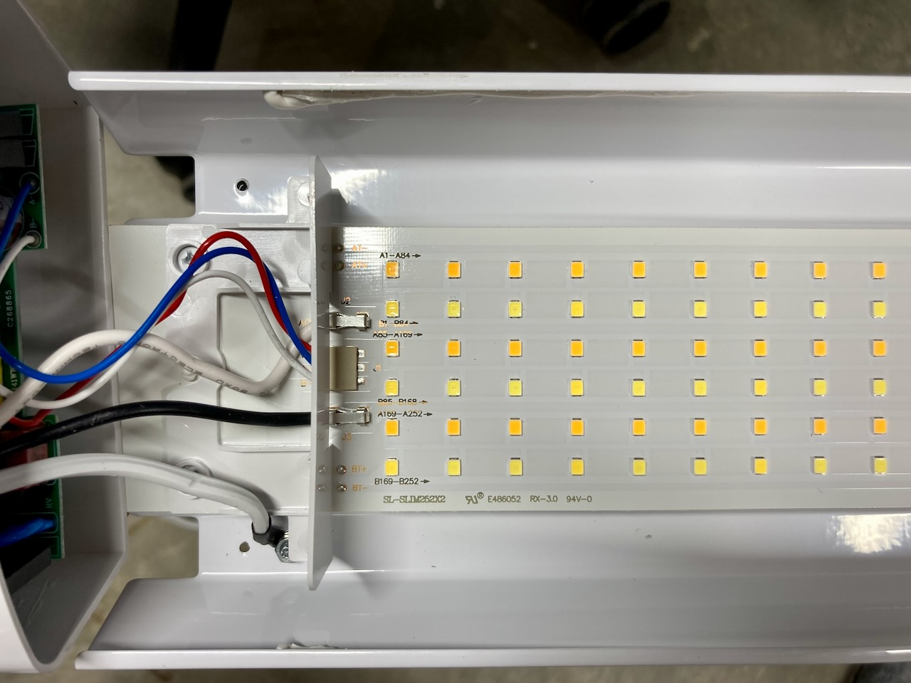

The SHOP/4/HO/CCT/AG shop light is a 10,000 lumen light with tunable white light (3000K – 6500K) with a NEMA 5-15P connector that plugs into a standard 3-prong outlet.
It can be found in the US on Amazon and in retailers such as Costco for about $60 (as of the time of publishing). It’s an interesting design (in my opinion) because it’s a smart light that supports on/off, dimming, and CCT color. But at the flip of a switch you can use it just like a standard, dumb LED light.
Lights
The light module contains 6 rows of LEDs (84 LEDs/row), each row alternating between cold and warm, for a total of 504 LEDs.
