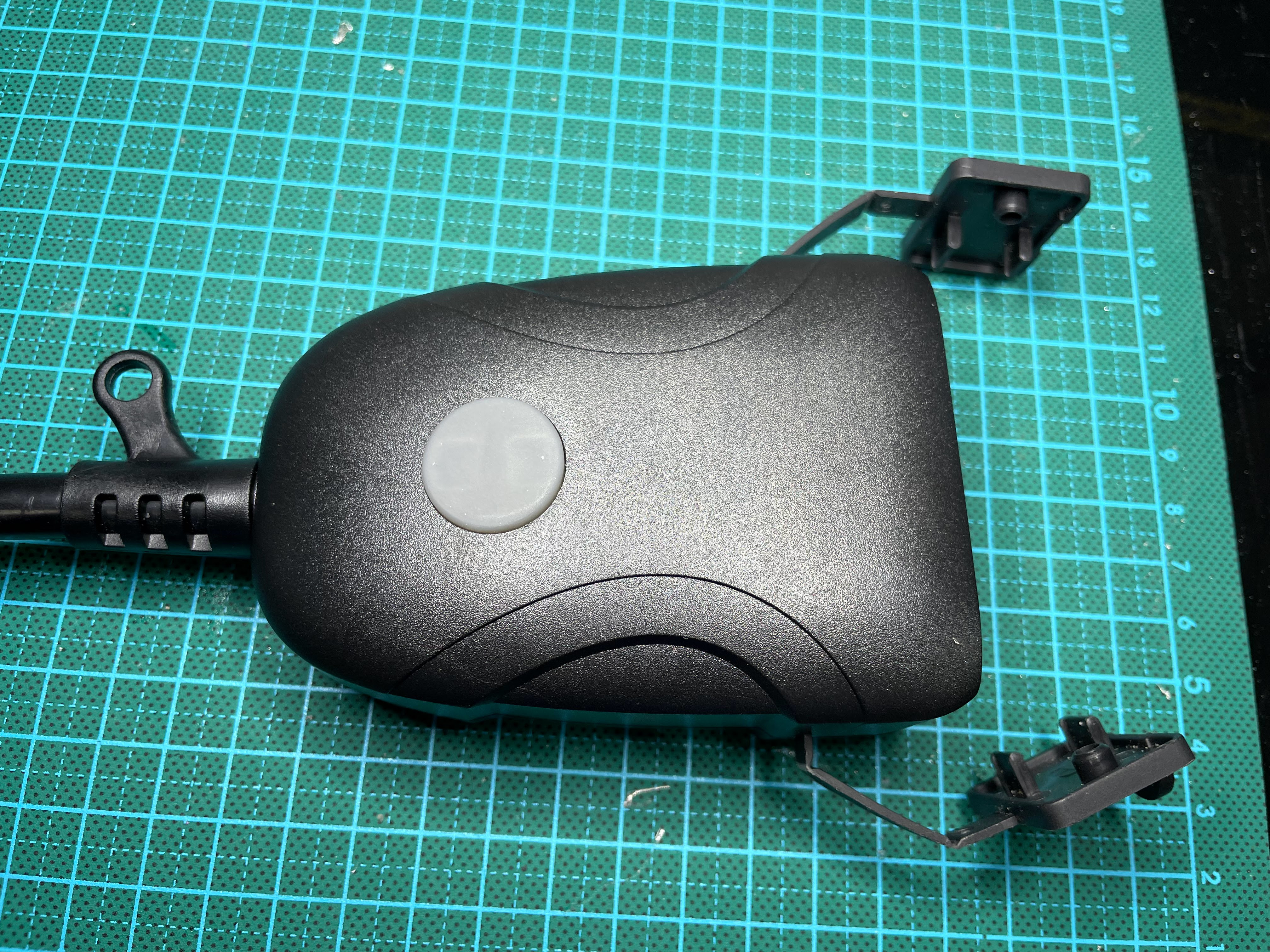

  • Feit Electric Wi‑Fi Smart Outdoor Plug, SKU PLUG/WIFI/WP, uses a BK7231-TQN32 chip and no Tuya module.
  • The plug was flashed with OpenBeken using hid_download_py after BK_Writer 1.60 failed for writing but worked for reading.
  • 3.3V power was supplied through the board, with solder connections to the RX1/TX1 and GND pads on the back.
  • The Enbrighten Wifi Switch configuration worked perfectly, with LED p7, relay p24, and button p26.
  • BK_Writer 1.60 did not work for writing, and the through holes for RX1/TX1 and GND remained unverified.
Hey all -
First post here, so hopefully I cover all the bases. First time trying OpenBeken, so thought I'd share my experience and add to the list of known working devices.
Given how well this worked, I might try my hand at some other Feit devices I've got laying around (currently on LocalTuya). I've got a penchant for them because they've been pretty reliable, and more importantly cheap and widely available (including at Costco - bulk prices - for those of us in the US).
Cheers!
Matt
Device name: Feit Electric Wi-Fi Smart Outdoor Plug
SKU: PLUG/WIFI/WP
Manufacturer URL: https://www.feit.com/product/outdoor-smart-wifi-dual-outlet-wall-plug-alexa-google-assistant/
Description: Outdoor two-outlet smart plug
Chip: BK7231-TQN32
Standalone, no Tuya module
Summary:
Flashed using: hid_download_py; BK_Writer 1.60 didn't work for me for writing, but appeared to work for the read.
Powered 3.3V via the board, soldered directly to the RX1/TX1 & GND pads on the back of the board. There were through holes for those on the board, but not sure if they work. By the end, the issue was BK_Writer not working - maybe those might work if I tried it again.
Using the config from "Enbrighten Wifi Switch" which appears to be working perfectly (LED p7; Relay p24; Button p26)

gulson 05 Sep 2022 16:12
Thank you for the presentations! I wonder if in Europe they produce these splitters for a European plug and 230V? [Read more]
p.kaczmarek2 06 Sep 2022 11:01
Thanks for the teardown. I just wonder how well this device can work outdoors, does the case provide enough insulation for moisture? Some time ago I did a teardown of a similar product - lGarden Tuya... [Read more]
mattj 10 Sep 2022 22:51
Honestly not sure I am qualified to comment on the level of waterproofing, but I had used it last year during the winter and it held up outside. That other product frankly looks better, because it actually... [Read more]
mb78offroad 28 Oct 2022 01:07
When you flashed it, what did the lights on your plug do? I've got almost the identical device, except with both LEDs on it being blue instead of one red. Mine appears to flash successfully via BKwriter... [Read more]
p.kaczmarek2 28 Oct 2022 05:57
Huh, this is new. I didn't expect such an issue @mb78offroad , but I am glad that you have it resolved. Anyway, regarding the lights - remember, some LEDs might be connected to relay pins and work along... [Read more]
mb78offroad 28 Oct 2022 06:06
Well I'll be darned, I ended up having to do that and just came to check to find that was exactly what I ended up going through just now. ^_^ Weird thing that was throwing me off was that the exterior... [Read more]
p.kaczmarek2 28 Oct 2022 06:18
That is why this page exists: https://openbekeniot.github.io/webapp/devicesList.html [Read more]
