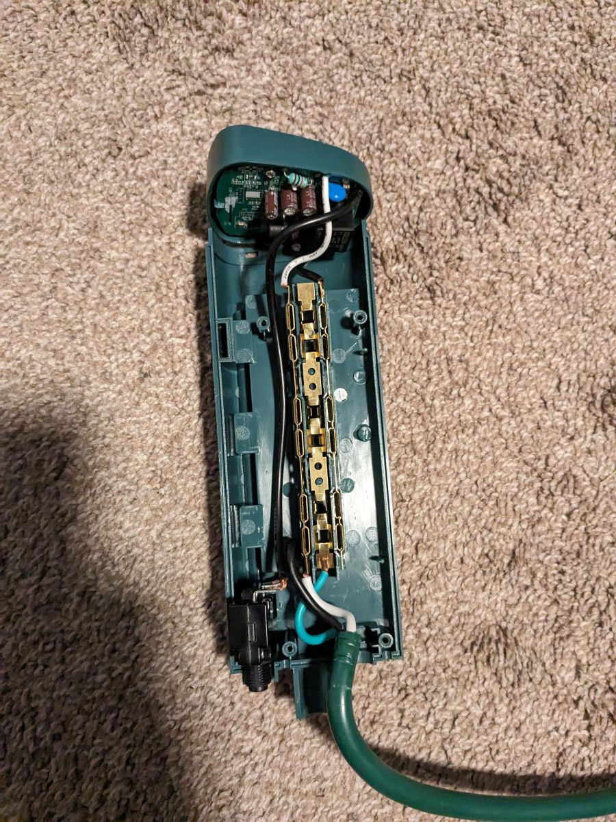

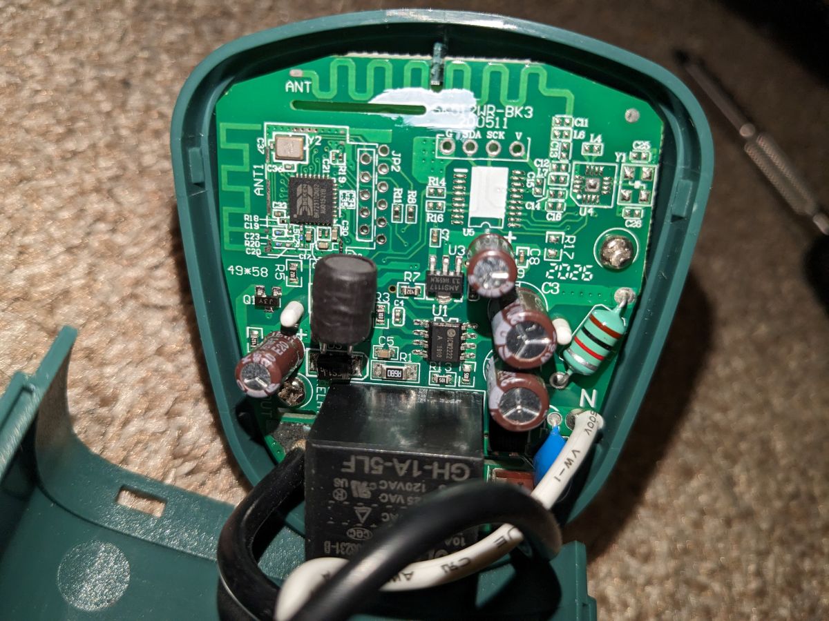

  • Feit Electric Smart Wi‑Fi Yard Stake, SKU PLUG/WIFI/STK/WP, is an outdoor six-outlet power stake with one relay controlling all 6 outlets.
  • Tuya-CloudCutter flashed OpenBeken without issues, using the Feit Electric PLUG/WIFI/WP configuration as the starting point.

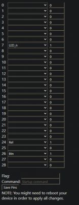

  • The board uses a BK7231-TQN32 chip and no Tuya module; pin mapping is Wifi_LED p7, LED p8, Relay p24, Button p26.
  • OpenBeken works just like the Tuya cloud version on this device.
  • This is the first, and likely only device that I have ever added openbk to, but it has not yet been listed so I figure I'll throw the information that I have about it here.
    I purchased this from an Ace Hardware a few years back, and finally decided to cut it from the cloud. It has one single relay that controls all 6 outlets.
    Hopefully I have enough information to make this useful.
    Device name: Feit Electric Smart Wi-Fi Yard Stake
    SKU: PLUG/WIFI/STK/WP
    Manufacturer URL: https://www.feit.com/products/six-outlet-outdoor-stake-wi-fi-smart-plug-plug-wifi-stk-wp
    Description: outdoor 6 outlet power stake
    Chip: BK7231-TQN32
    No tuya module
    Summary:
    To flash Openbk, I used Tuya-CloudCutter and it worked without any problem.
    I used the config from the Feit Electric PLUG/WIFI/WP and it works just like it did when connected to the Tuya cloud services (Wifi_LED p7; LED p8; Relay p24; Button p26)
    Config Template:
    photos and teardowns:

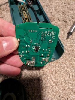

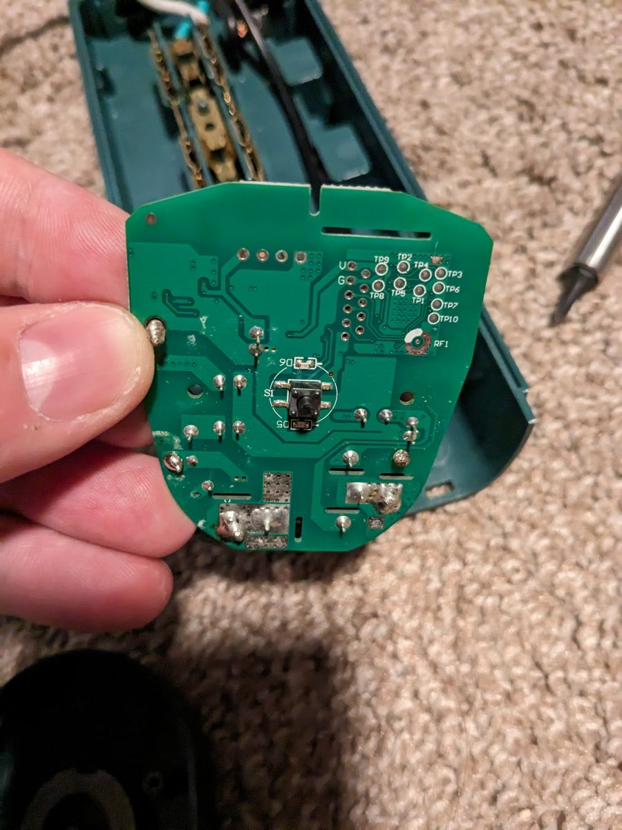

    Thank you for the presentation, it is a very interesting device, although I would be worried about its IP rating. Is it really an outdoor one?
    I can also see the tracks for the RF circuit on the PCB. There is also a secondary antenna. It seems that the device also comes in an RF+WiFi version.

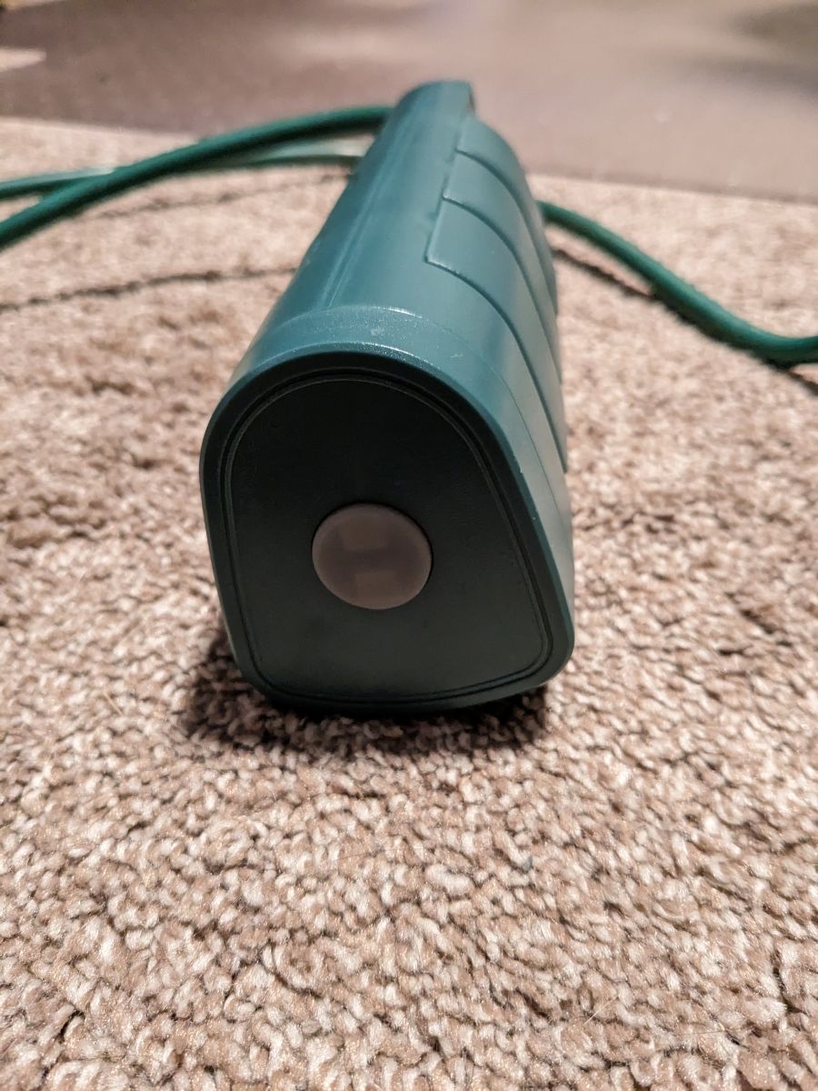

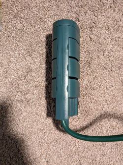

  • No IP rating and no visible moisture damage
    #3 20661870
    Skooj
    As far as waterproofing, there is no mention that I've seen of any IP rating. There are no gaskets or seals of any kind that I can find, just the overlapping plastic bits of the housing...
    We have been using it for our holiday lights for the past 5 or so years, always under the eave of our house, so it's relatively protected from snow and rain. The board has no corrosion or evidence of moisture, so it seems to do okay. I hadn't opened it up until a couple of months ago, so hopefully I didn't compromise it any.

  • Tuya config reveals WB2S pinout and LED mapping
    #9 20668021
    Skooj
    I just learned how to download the Tuya config and extract the pinouts, and have updated my original post with the new information and config JSON:
    I think I personally prefer led_n to be on pin 7 (blue LED, pin 8 is red)) and no WiFi LED, so that it is dark when off and only the blue LED is on when it is on.
