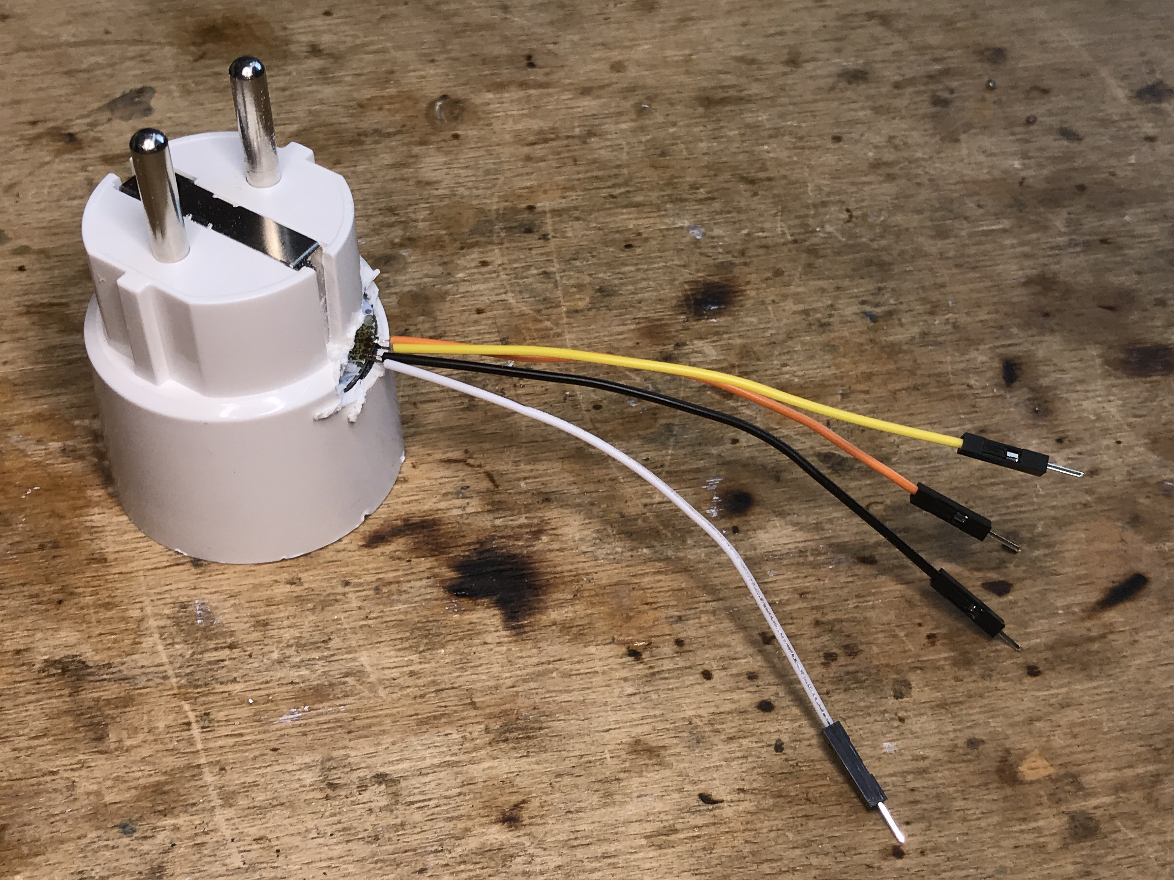

NAS-WR01W plugs and a smarter way to program
For the NAS-WR01W twin product, I tried a different approach and only cut the plastic at the programmer signals alone:
In this way, wires can be soldered there and programmed without removing the rest of the housing by force, but of course then you need to protect the damaged housing.
And now attention - this plug has BK7231N and BL0942 inside. It's better to use hid_download_py, but this time I managed to upload the batch with bkWriter:
The relay is as before on P26.
P6 is LED again.
BL0942 is on pins from UART, you don't need to set it.
