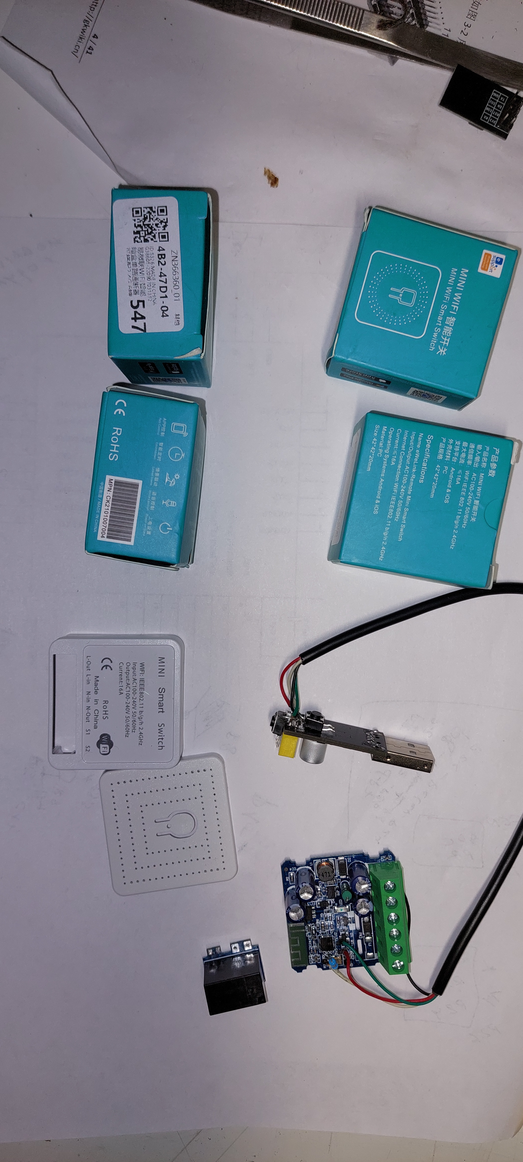

  • eWeLink-remote mini smart switch uses a BL602L20 board.
  • The pinout maps RX, TX, Boot, Led, Button, S2, and Relay to their board pins and GPIOs.
  • Key mappings are RX-16/gpio7, TX-27/gpio16, Led-29/gpio20, Button-31/gpio22, S2-3/gpio2, and Relay-4/gpio3.
BL602L20
name-pin--gpio
RX-16-- gpio7
TX-27-- gpio16
Boot -17
Led-29--gpio20
Button-31--gpio22
S2-3--gpio2
Relay-4--gpio3

p.kaczmarek2 18 Oct 2022 15:33
Wow, BL602? That's something new. And as far as I can tell, that's not just a Sonoff S40 clone (S40 is using BL602, as far as I know). That's interesting, I haven't found any BL602-based eWeLink devices... [Read more]

Steigan 24 Dec 2022 12:00
My configuration for this device: https://obrazki.elektroda.pl/5676860800_1671879568_thumb.jpg [Read more]
p.kaczmarek2 24 Dec 2022 12:03
You might consider using "TglChannelOnToggle" role instead of Button, this will work with "classic" two state switches [Read more]
Steigan 24 Dec 2022 12:09
Ok! Thanks! [Read more]
nomek 13 Jan 2023 12:15
First of all, kudos for your work on OpenBeken etc. Let me add a description of flashing my version of this gadget. https://obrazki.elektroda.pl/1583841100_1673606742_thumb.jpg I bought it on Ali... [Read more]
hmonteiro 17 Apr 2023 00:03
Hello, nomek! Thank you for sharing your experiences. Would it be possible for you to share a couple photos of the Aubess mini switch PCB? Maybe including one of the Buffalo chip? I'm a bit puzzled... [Read more]
nomek 18 Apr 2023 10:03
@hmonteiro my module is the same as in the photos in the first post and that's why I didn't attach photos so as not to duplicate materials. [Read more]
