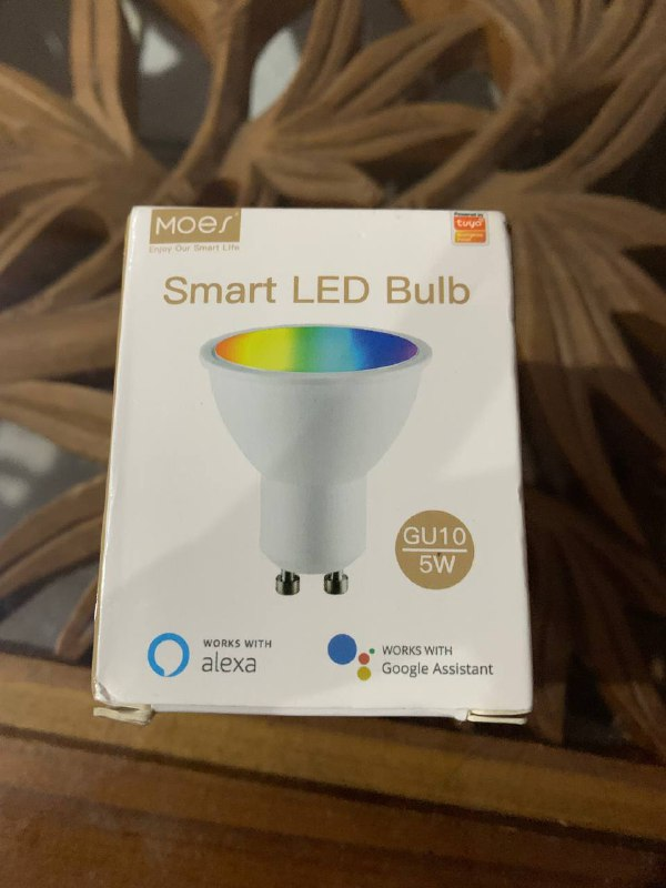

This is a short teardown of the Moes Smart LED Light Bulb RGBCCT 5W GU10 based on - BK7231T [WBCL5]
Basic information:
Brand: Moes
Model: WB-YL5-RWW-GU10
Chip: BK7231T [WBCL5]
Local Vendor: https://www.lazada.com.my/products/i2303278194-s9802172838.html
I've got them since early this year, however I couldn't figure out how to remove the pcb without destroying the case or removing the leg pins.
Teardown Photos
Package:
Flashing Method:
Using tuya-cloudcutter
Select 'A19 RGB' under Helloify. The tuya firmware for this was on 2.9.16
Pinout:
Pin Assignment
P24 BP1658CJ_DAT
P26 BP1658CJ_CLK
Change Startup command text for correct color mapping:
BP1658CJ_Map 2 1 0 3 4
