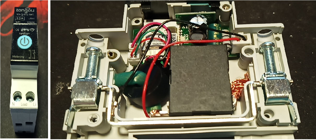

  • TONGOU TO-Q-SY1-JWT DIN-rail WiFi switch from AliExpress uses a BK7231N CBU module and includes power metering.
  • It uses a magnetic polarized relay driven by an MD7620 bridge driver; forward closes the contact and reverse opens it.
  • The relay needs a 100–200 ms pulse to change position, then holds its last state without power.
  • Pin mapping includes P9 relay status LED, P15 WiFi LED, P17 button, P24 bridge forward, and P26 bridge reverse.
  • OpenBK7231T_App firmware supports the platform, but MD7620 bridge-driver support is not finished yet.
DIN Rail WiFi switch from aliexpress
Chipset BK7231N module model CBU
EDIT: Power metering uses BL0942 chip.
Pin Assignments:
P9 - RELAY Status LED
P15 - Wifi LED
P17 - Button
P24 - Bridge FORWARD
P26 - Bridge REVERSE
Switch uses Magnetic Polarized Relay:
This relay must be driven with bridge driver.
Forward direction closes contact, Reserve direction opens contact.
Relay need to be powered only for changing contact position.
Pulse from length 100-200 ms is requirred to change position.
Then relay holds last position without power.
Relay Driver IC MD7620 (Shanghai-Mingda-Microelectronics)
Operation modes:
Firmware:
The firmware do not support the bridge driver MD7620 yet, but the work is in progress.

valeklubomir 20 Feb 2023 02:05
Hello For the basic functionality it is enough just to setup pins. Bridge driver will start automatically after reboot. https://obrazki.elektroda.pl/2975965200_1676854866_thumb.jpg BridgeFWD... [Read more]
thealphahelix 21 Feb 2023 01:00
Heroic! Thanks so much, I got this working today :) I can't believe how smooth this process was. [Read more]
