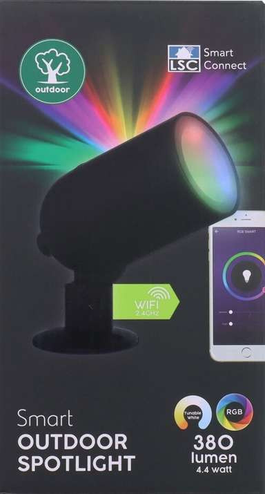

First of all, thank you very much for all the helpful information.
I would like to introduce you to the LSC Outdoorspot. It is available at Action. Unfortunately, it is no longer sold in Germany, but it was still listed on the Polish Action website.
Disassembly is quite simple: unscrew the diffuser, push the insert down and turn it.
Then lever out the disc and remove all screws.
There is a WB2S chip inside. I flashed it over the air with tuya Cloudcutter.
The pin assignment is as follows:
Pin 6 - PWM - 2
Pin 7 - PWM - 1
Pin 8 - PWM - 3
Pin 24 - PWM - 4
Pin 26 - PWM 5
Works great. Please let me know if the devices are still available in Poland, I still need some and I pay by Paypal ;)

p.kaczmarek2 12 Dec 2022 09:29
It seems like a very nice light, I wonder how bright is it? Futhermore, is it really suited for outdoor application? How do you know it's no longer sold in Germany? Did they remove it from the official... [Read more]
derrodi 12 Dec 2022 13:21
The lamp has been hanging on my outdoor garden shed for a year, so far without any problems. An employee at Action said that the lamps have been taken out of the range. They are also no longer listed... [Read more]
HumbleDeer 22 Dec 2022 01:13
As it turns out, I coincidentally posted my teardown of the 3-spot version a mere 2 hours before you posted here! https://www.elektroda.com/rtvforum/topic3941003.html#20330926 Gotta love that timing But... [Read more]
