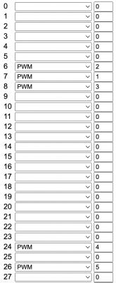

  • The board exposes PWM pins on 6, 7, 8, 24, and 26, mapped to PWM 2, 1, 3, 4, and 5.

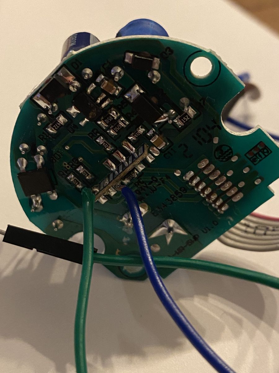

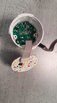

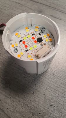

    Disassembly is quite simple: unscrew the diffuser, push the insert down and turn it.
    Then lever out the disc and remove all screws.

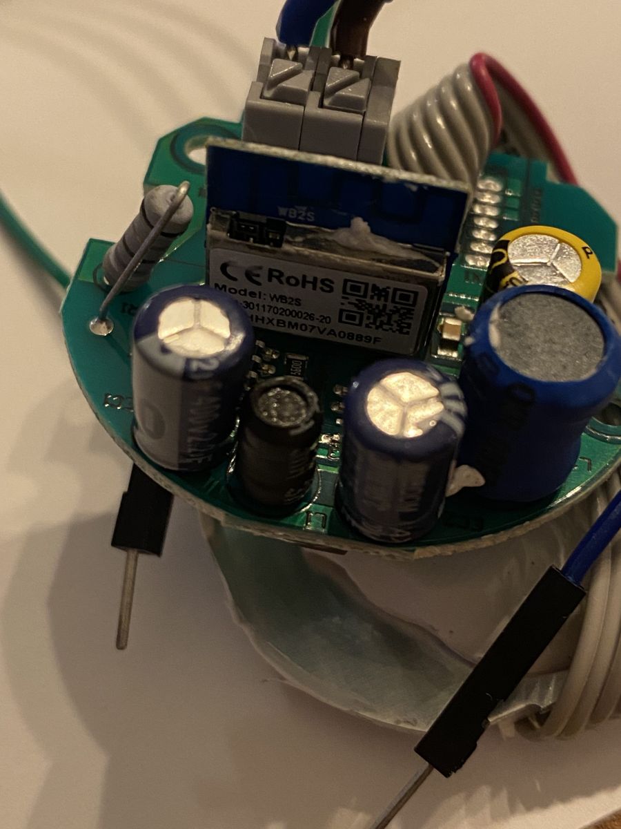

    There is a WB2S chip inside. I flashed it over the air with tuya Cloudcutter.

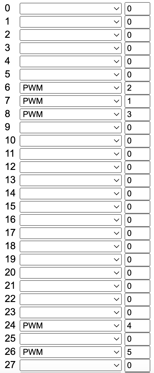

    The pin assignment is as follows:
    Pin 6 - PWM - 2
    Pin 7 - PWM - 1
    Pin 8 - PWM - 3
    Pin 24 - PWM - 4
    Pin 26 - PWM 5
