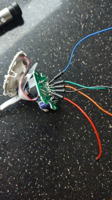

    I got 2 of these second hand for next to nothing and dismanteld it purely for fun. Its all plastic and although it looks designy from a distance, its very plasticy and cheapass.

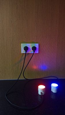

    I tossed everything in the bin except the white plastic unit inside. Warm colors are super bright. Colors verry poor brightness. Dont bother for the colors.
    Because the light unit inside has a wire cover(its not a GUI10 spot), i made some funky plug in anywhere lights from them with black nylon braided cord.
    [BK7231T] LSC garden pedestal WB2S
    This pedestal has the same led unit as another LSC garden light found here:
    https://www.elektroda.com/rtvforum/topic3940938.html
    So i just post some more pictures here so you guys know what to expect.
    Flashed it with the Windows gui flasher available on the Openbeken github page without probs.
    Before that i tried the Toya Cloud Cutter from github and it kinda almost worked, but it ended up not finding the downloaded firmware file because i had it in the wrong dir. Then the script stalled because it was still looking for the original Tuya APname, while the script already changed the AP of the light to something else... derp. Made a ticket on github, it already has a response with explanation.

    Wow, that's a very nice device, I haven't seen that one yet, thank you! I see they are advertised as 'garden', are they really waterproof?
    Btw, it would be nice if you could provide full model name/LSC/Action shop item name, so it's easier to find that device in the Templates Database, although I can see that i can be hard since you got that device second hand.
    Do you have original firmware backup?
    Also... why is there IR Remote on the photo? Is there somewhere an IR receiver on this device?

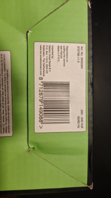

  • Article number 3005264 found in Tuya Cloud Cutter script

    Hey,
    Its this one:
    https://www.youtube.com/watch?v=sN5QzyUCSZM
    its for garden yes. Its all plastic an skrewed together with rubber seals. It looked waterproof before i tossed the casing away in the bin.
    I took a dive in the old paper container for you and made these pics for the specs. When you wanna try Tuya Cloud Cutter script, the actual article number 3005264 is listed when running the script.
    I have the backup of the firmware yes. I was planning to delete it though, never ever am i going to use tuya.
    My first picture of my post was from internet. One of my cheaply obtained pedestals came with a remote yes. The other not. They where both open boxes so......
    here are the pics:
