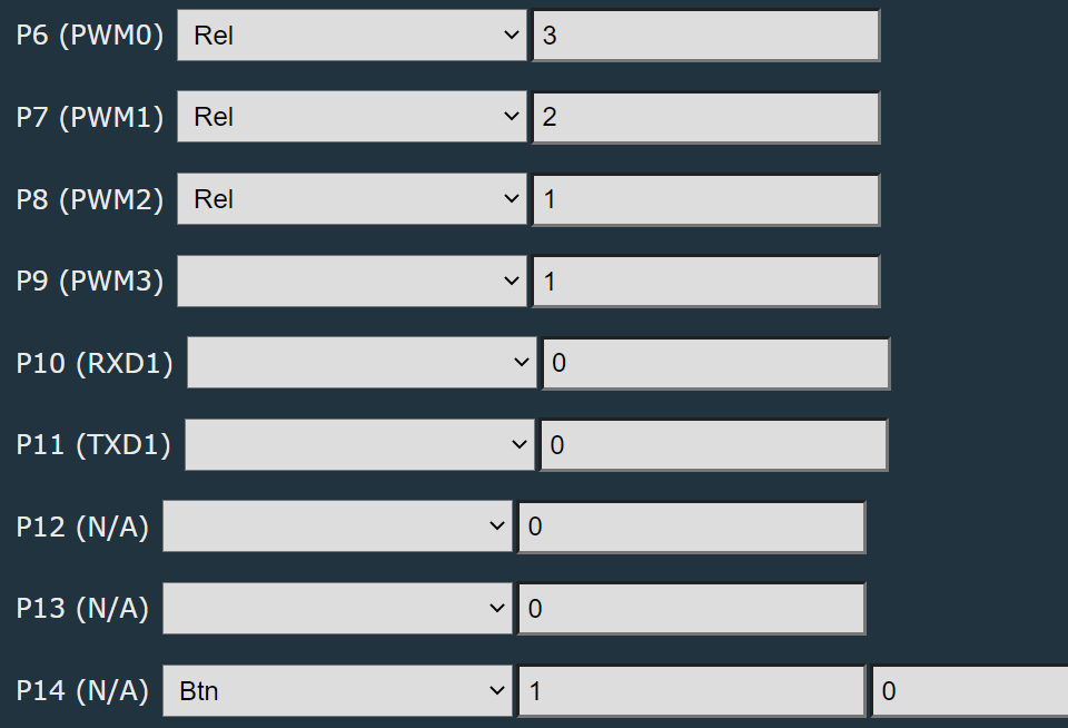

This is a quick guide on setting up 'detached mode' with openbk flashed switches.
This would continuously power your wifi/zigbee bulbs without turning it off when the switch is toggled.
On your switch. you'll need to change the relay that's wired to your wifi bulbs to AlwaysHigh and assign a fake relay to any random unused pin.
P8 - Relay 1
P14 - Button 1
P9 - Fake relay
P8 AlwaysHigh
P9 Relay 1
Add this script:
//publish button actions to mqtt for button 1 (pin 14)
addEventHandler OnClick 14  publish button click
addEventHandler OnDblClick 14 publish button dblclick
addEventHandler OnHoldStart 14 publish button holdstart
addEventHandler OnHold 14 publish button hold
addEventHandler OnRelease 14  publish button release
//reassign pin 8 as relay when MQTT is offline
addEventHandler MQTTState 1 backlog setPinRole 8 AlwaysHigh; setPinRole 9 Rel
addEventHandler MQTTState 0 backlog setPinRole 8 Rel; setPinRole 9 AlwaysLow
Now, you can toggle the switch and do some custom actions based on published mqtt button payload
MQTT topic to subscribe
<device name>/<channel number>/get
<device name>/button/get
Example for my device:
living_room_switches/1/get
living_room_switches/button/get
