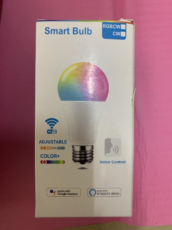

This is a short teardown of the Aubess WiFi Smart LED Light Bulb 15W E27 RGBCW based on - BK7231N (CB2L).
Basic information:
Brand: Aubess
Chip: CB2L (BK7231N) - the chip listed is QM-02L, but seems to be another variant of CB2L
Local Vendor: https://www.aliexpress.com/item/1005004846008613.html
Teardown Photos:
Flashing method:
a) Using tuya-cloudcutter
1. Select profile with firmware version 1.3.21
b) Serial:
1. You'll need to desolder the CB2L chip because the TX & RX pin are not accessible from the back
2. Using serial method with hid_download tool. Start flashing and do a power cycle or ground the CEN pin.
UART TX --> PCB RX
UART RX --> PCB RX
UART GND --> PCB GND
UART 3.3V --> PCB 3.3V
Pinout:
PinAssignment
P8PWM 1
P7PWM 2
P6PWM 3
P24PWM 5
P26PWM 4
