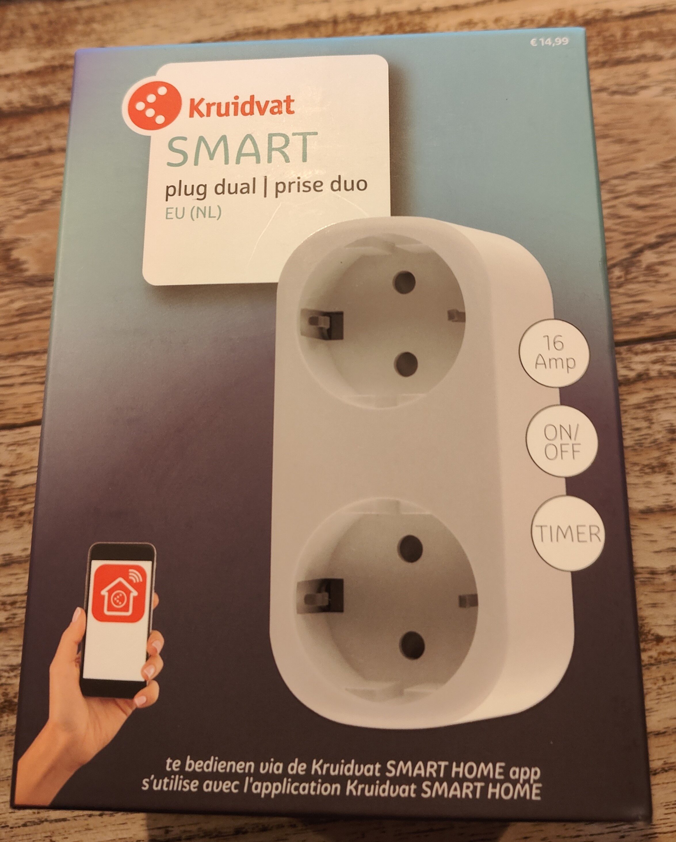

I am adding a teardown for my Kruidvat SMART Dual Plug. I bought this Smart Plug out of curiosity. The Plug can be converted using tuya-cloudcutter and it took me about one hour from the package to full operating mode in HomeAssistant. Somehow MQTT did not pick up instantly, and after reprovisioning, it went fine.
Even though I don't want to install anything tuya related on any of my devices, I recommend installing the tuya or a compatible app on a spare device. The reason for doing so is to get the smart device's firmware version. We need this version number for uploading the OpenBeken firmware using tuya-cloudcutter. I am fond of opening devices and understanding how they work inside. But in the end, the likelihood of destroying/bricking a smart device is much greater when you are playing around with a soldering iron than with flashing using tuya-cloudcutter. Until now I've not broken any smart plug by the tuya-cloudcutter method.
Well, let's start with unboxing;
Packaging:
Nothing out of the ordinary. The important information here is the article number: "SH 63.126".
