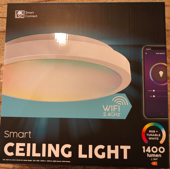

Today I am adding a second tear down for the LSC Smart Ceiling Light RGBCW - CB2S (BK7231N).
I bought this device today at Action for about 15 euros. I was curious how it worked and was unaware of the teardown on elektroda. Anyway, my teardown uses cloud-cutter, so a bit of a different approach.
Packaging
Square box, nothing fancy

p.kaczmarek2 07 Jan 2023 12:59
Hello, thank you, but what is the Action item No for this device? The photo is blurry and I am not sure [Read more]
nielspiersma 07 Jan 2023 14:14
3007213 is the article nummer. Niels https://obrazki.elektroda.pl/7127188900_1673097273_thumb.jpg [Read more]
