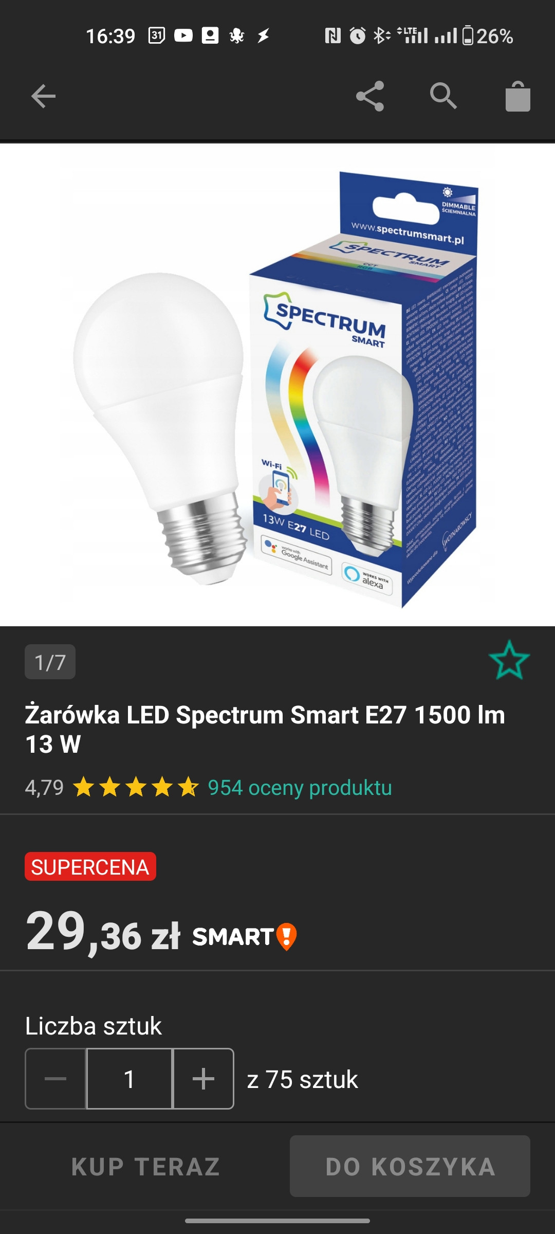

Greetings!
I have bought Spectrum Smart E27 1500 lm 13 W (Model: WOJ14473) and want to share my teardown.
