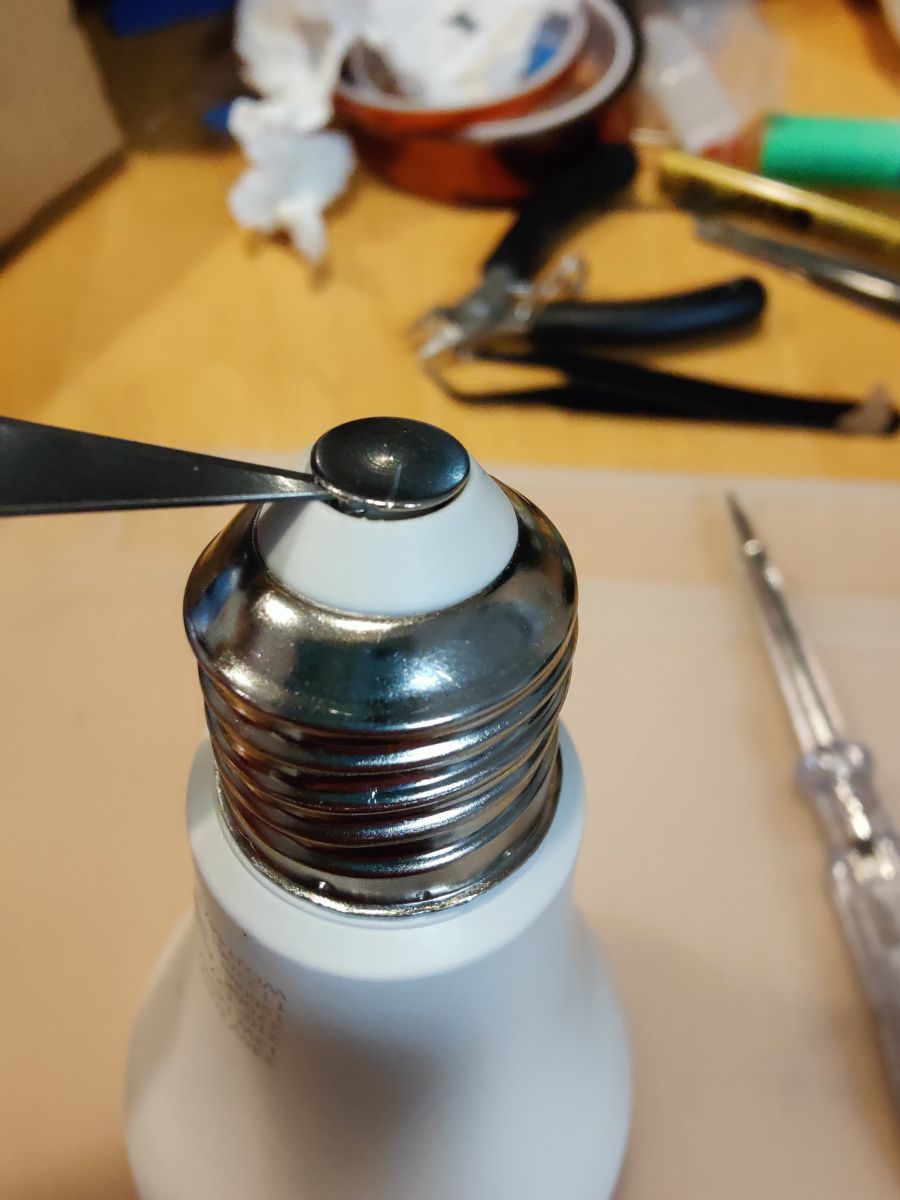

    Disassembly
    First put something sharp between Tip/Pin[1] and part [2]
    [WB2L/BK7231T] Spectrum Smart E27 1500 lm 13W WOJ14473
    Pull Pin [1] out of plastic [2]
    Then You will see one of live connections:

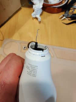

    This is tricky part as metal that this thread is made of is pretty thin I would suggest to put something betweet metal part of thread [2] and plastic body [3]. I have used lock-jaw pliers and covered thread with rag but thread is slightly deformed.
    There is second connection wire.
    Another thing to notice is that after assembly this part will no longer hold as it previously did. You can try to pin original holes all around body to ensure good contact.

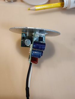

    You will see 2 PCB (power PCB and MCU PCB) and LED plate.
    Originally there was some putty additionally holding it together. Remove that carefully with scalpel and avoid braking SMD parts.
    After that just slide one PCB from another.

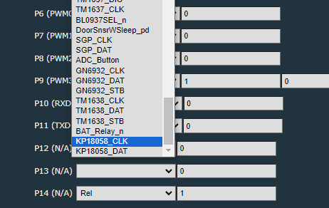

  • KP18068 driver identified with P7/P8 pin mapping
    #12 20537298
    Posts: 14823
    Rate: 12994
    It seems that this product uses an integrated LED controller with a I2C-like protocol - KP18068.
    Sample bulb diagram:
    I have extracted pin roles from the binary:
    - SCL - P7
    - SDA - P8
    - mapping RGBCW: 1 2 0 4 3
    Unfortunately, KP18068 is not currently supported. I haven't examined its protocol in detail, but it is unlikely to be compatible with the chips currently supported by OpenBeken.
    I would be happy to add support for KP18068, but I probably can't do it remotely. I would need to somehow obtain a product with that specific driver. I could try ordering the same lamp from the same store as you, but as you mention that the manufacturer secretly changes the electronics inside, it might be difficult because if I receive a different version than what you have, I won't be able to help.
    What is the exact model of your device? Where was it bought?

  • KP18068/KP18058 working with OBK pin mapping
    #21 20708687
    Posts: 14823
    Rate: 12994
    Hello, thank you for your offer, but the KP18068 is supposedly the same as KP18058, it is already working, please see update:
    https://www.elektroda.com/rtvforum/topic3991620.html
    Steps to get KP18068/KP18058 working:
    1. flash OBK to the device
    2. choose correct pins:
    Screenshot of pin configuration in OpenBK7231T software, with a dropdown menu for P11 function selection open.
    3. use map command to change order of colors if needed:
    KP18058_Map 0 1 2 3 4

How can I disassemble the bulb without cracking the diffuser?
Grip the plastic body with one hand and the diffuser with the other; pull straight until the putty seal pops (first tear-down needs high force) [Elektroda, Kosygor, post #20379425] Twisting also works, but keep fingers evenly spaced to prevent stress fractures.
What is the safest way to remove the crimped E27 metal base?
Screw the lamp into an inexpensive E27 holder or warm the shell for about 1 ½ minutes with a lighter, then pull; overheating can melt the neutral-live separator and cause shorts [Elektroda, Zain00, post #20381445]
Which GPIO mapping drives the RGBCW LEDs on the BK7231T version?
Set P6→PWM #2, P7→PWM #5, P8→PWM #4, P24→PWM #3, P26→PWM #1 in OpenBK’s web UI [Elektroda, Kosygor, post #20379425]

What happens if the metal shell loosens during reassembly?
A loose shell can unscrew inside the fixture, leaving live wires exposed—a shock and fire hazard [Elektroda, Kosygor, post #20379425] Crimp or punch the original indentations to regain friction.

Quick three-step tear-down recap?
  1. Pry out the bottom pin to free the live lead.
  2. Twist-pull the diffuser to expose the LED plate.
  3. Tap the body against a table while supporting the LED board with a crayon; the power and MCU PCBs slide out [Elektroda, Kosygor, post #20379425]
